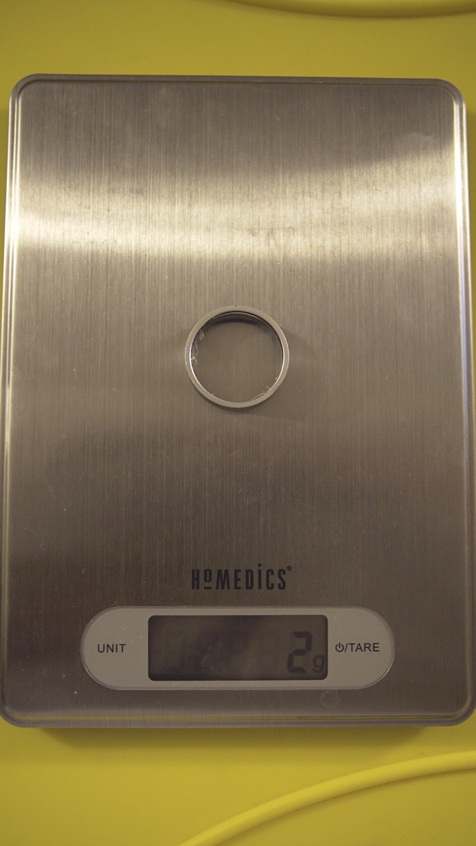

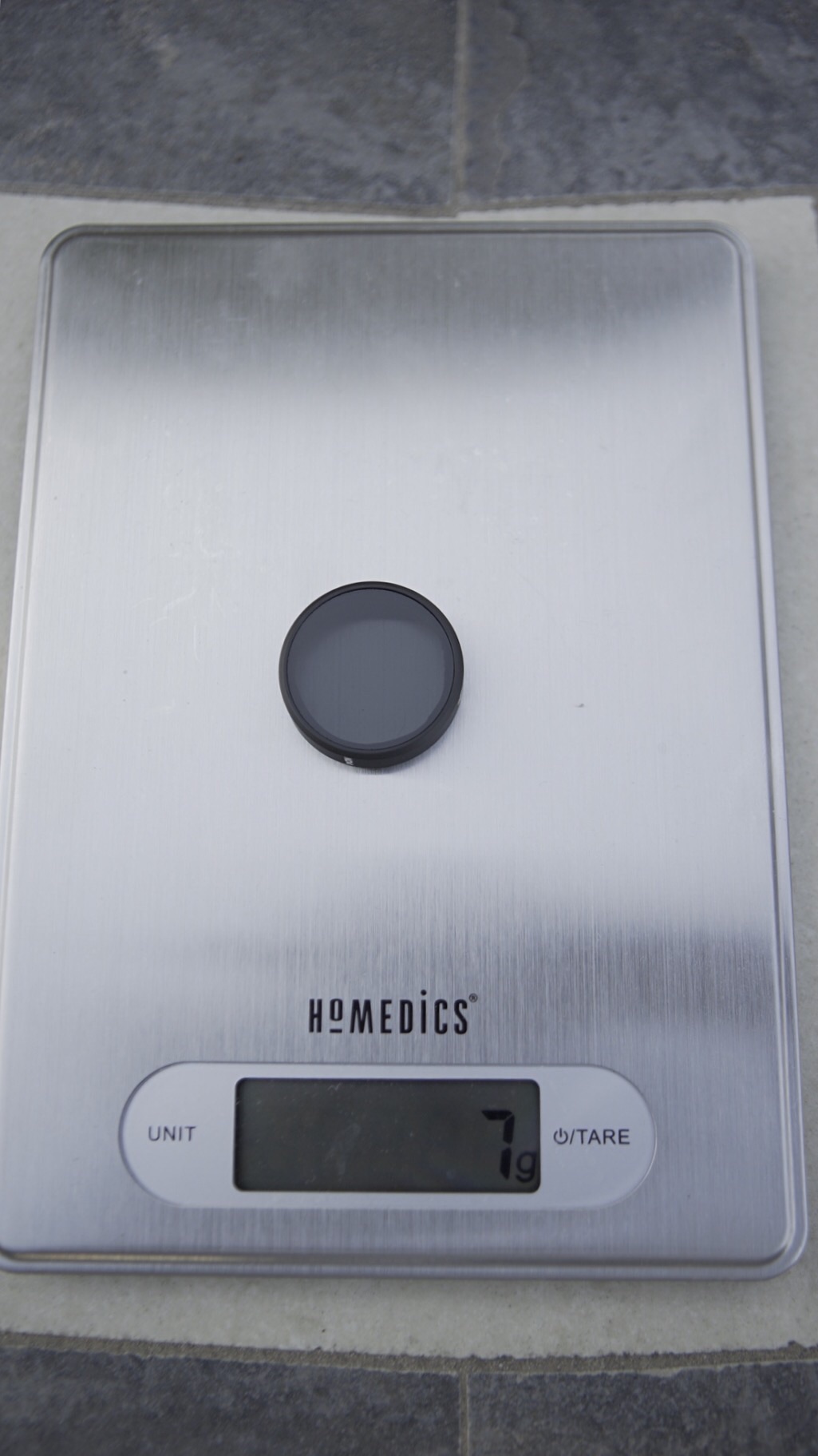

Thoughts on counterbalancing. What is 7.5 grams that we can stick on the back of the camera besides 3 pennies?
One quarter and a dime if necessary. Still testing but this is a good point.
Nothing ND wise coming out is the same weight as the UV lens. Yes they're all small, yes their custom made for the P3, BUT they're all are too heavy IMHO. The gimbal motors are also much smaller and delicate than say the H3-3D/4D for P2.
And man don't get me wrong. I hate junking up my equipment with goofy home-made remedies but I won't fly with the PP or SRP filters without something on the back of the camera and centered under the vertical arm of the gimbal. That's just me. With either brand of filter the "tiny extra weight" is obvious with the copter powered off. Again IMHO. With the stock UV on and P3 powered off you can tilt, move and turn the camera and it stays where your hand leaves it. Because its perfectly balanced.
I did the same trick with my P2/GoPro Hero 4/SRP ND's. Yep I had/have coins stuck on the appropriate places BUT hundreds of flights later that gimbal and it's motors are still as strong and dependable as the day I installed it. I believe keeping it balanced (albeit home-made balancing) is the reason for this.

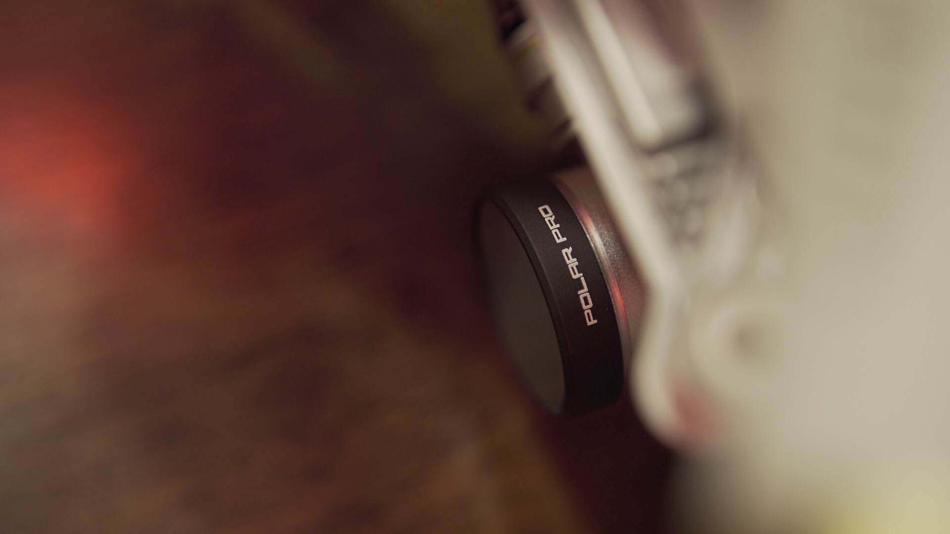

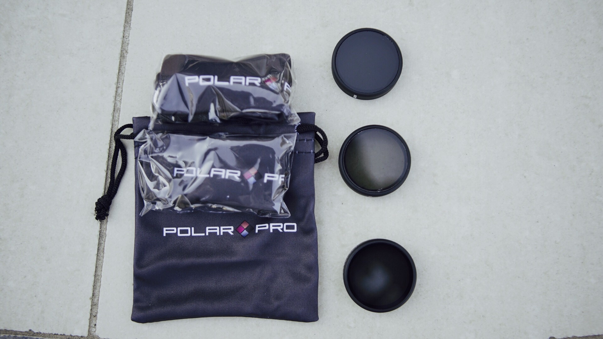

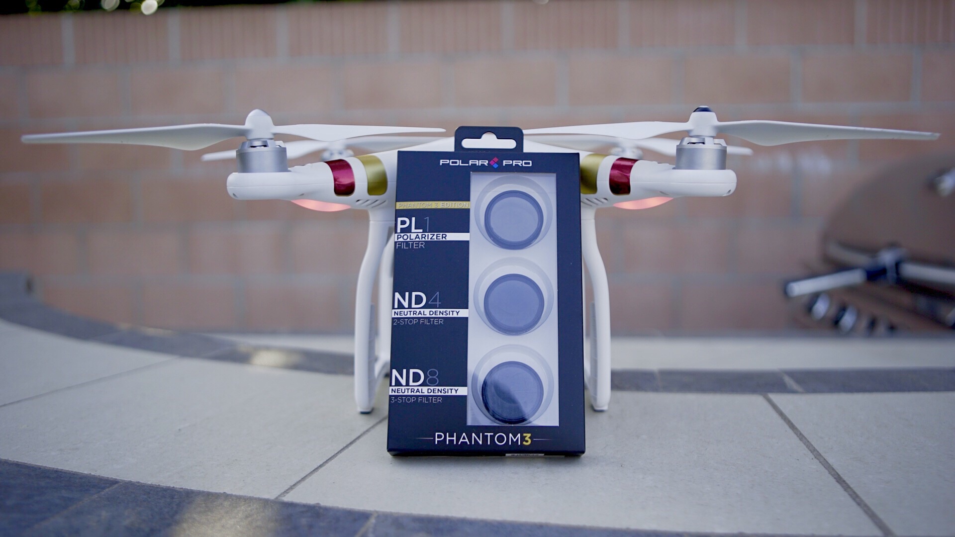

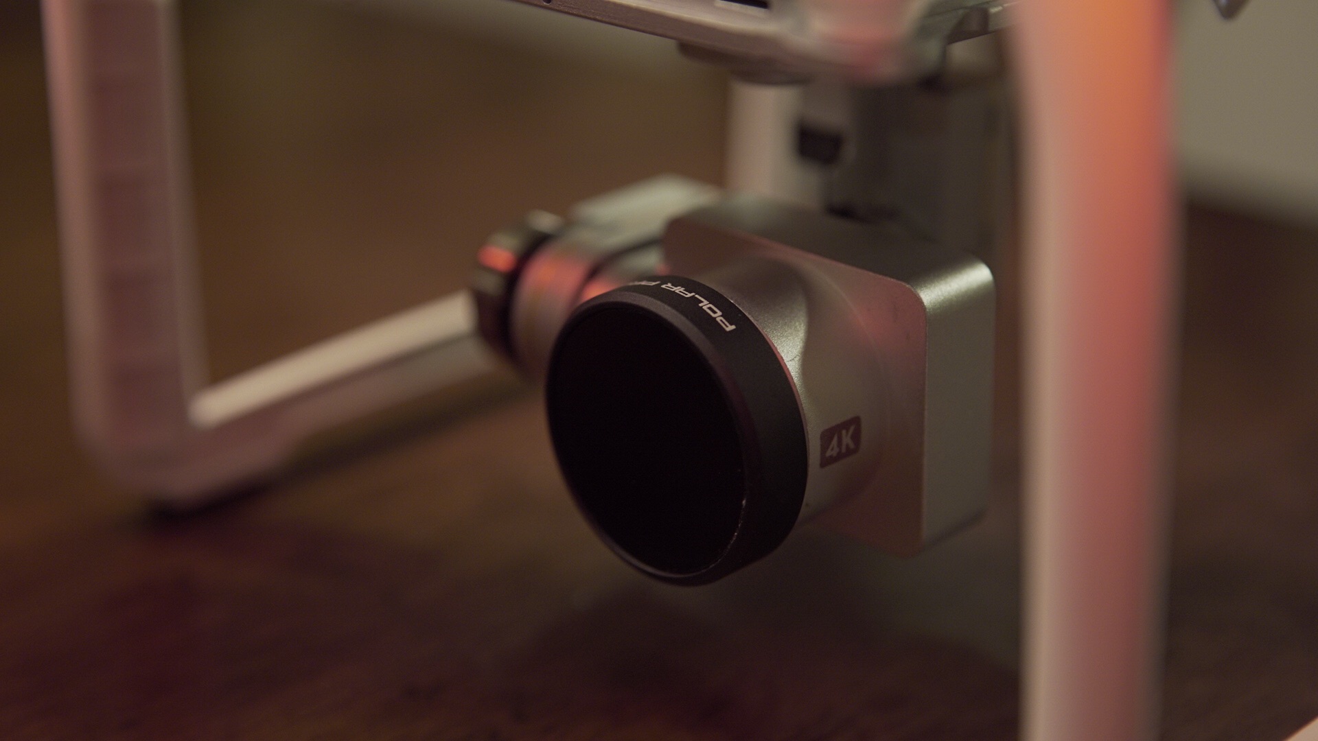

Today the Polar Pro ND4, ND8 Filters and Polarizer are available for the general public and I got mine in the mail today. I've been doing professional photography for 12 years and have been a Director of Photography for roughly the same amount of time and CPL's and ND Filters have been an essential tools in my bag.
View attachment 21286 View attachment 21287
So as you can tell from the photos you receive 3 filters to help achieve a desirable shutter speed to get a cinematic look. In the packaging you receive 3 small bags to carry each filter in separately so you don't damage them in transit.
The first thing you will notice is the quality of the glass which in my opinion is on par with the filters I use on my DSLR's and Matte Boxes, you will also notice that the filters are threaded. (Heads up on taking off the DJI UV Filter it is very fragile and could possibly crack as mine did when I thought I was smart and used a blow dryer to heat up the filter, dumb $38 mistake). Once I got the stock UV filter off I then weighed the stock filter which was 2 grams compared to the Polar Pro ND8 and ND4 which were 7 grams each.View attachment 21289View attachment 21290
I put the Polar Por filter on which does thread all the way to the back like the OEM and fits firmly without any play, when you turn the Phantom on and the gimbal will calibrate and work prefectly.
Over the next week I will put together a video review with comparisons and give my impressions of the video quality but for now at the price is $69 this is suitable to get a slower shutter speed and help take away the dreaded "jello" or moire a lot of us have been getting on the phantom 3.

"Dont know why manufactors cant offer ND filters for the P3 with exactly the same weight as the original threaded UV filter, it cant be that hard to do."
Yes, you would think that with the tiny, delicate gimbal on the P3 that add on companies would understand that the primary goal would be to keep weight down to not throw the balance out of whack. I think they do actually, and this is more a reflection of the general decline in the US economy/manufacturing/technology capability. That part is likely cast and finish machined, and at a very small tolerance. The add on people would do that it they could, and it was economically feasible, but the sad fact is, they can't. Same reason that if you go into Home Depot or Lowes, about 98% of everything you see is made in China. This is a perilous position to be in, of course, but the collective brain trust in the US hasn't figured that out yet.
