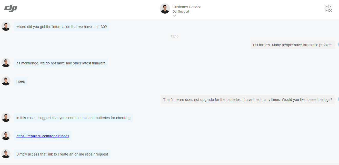

My guess is that the refurb unit had v1.11.30 installed by DJI as part of their refurb process. We've seen this happen a few times before.
Read this thread from a few weeks ago.
Please upload your LOG_AB file here so we can further confirm that you have v1.11.30 installed. Also, show us a screen shot of the versions showing in your app.
v1.11.30 does show on the RESULT_AB snippet you posted, so chances are obviously very high this is what is happening. Still, I personally only trust the LOG_AB file.
I tried starting up the UAV with the SD card inserted and no RC, but same result as before.
Not sure how to get a "screen grab of the versions showing in your app" - where would I look for these versions? On the DJI go app I open up the "camera" then click around til I get the opportunity to confirm that I've upgraded my firmware, and I'm told that the battery needs a firmware update. Not sure how to learn what firmware I've got via the app.

Update, I contacted DJI and the customer service person claims there is no version 1.11.30:
This is silly, I really don't want to have to send the thing to DJI for a simple battery upgrade...
The "unofficial" (in quotes, because it does come from a DJI employee) FW package version 1.11.30 has only one difference from 1.11.20 - ESC firmwares are slightly updated. Everything else, including battery FW, has the same version within these two packages.
(not that it really matter, because from the logs above it looks like the drone gives up on 1.11.20 before even looking at the modules inside)
