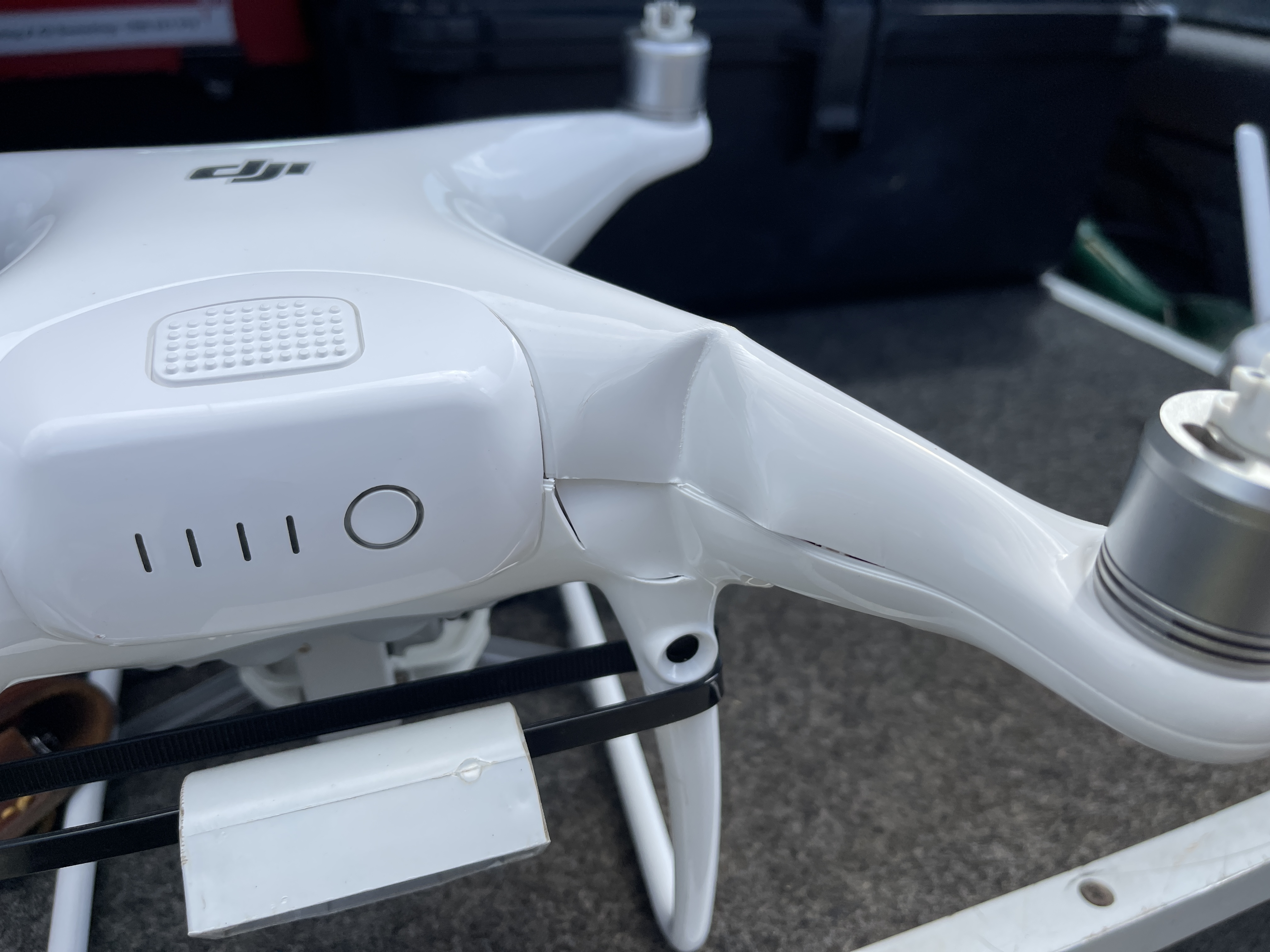

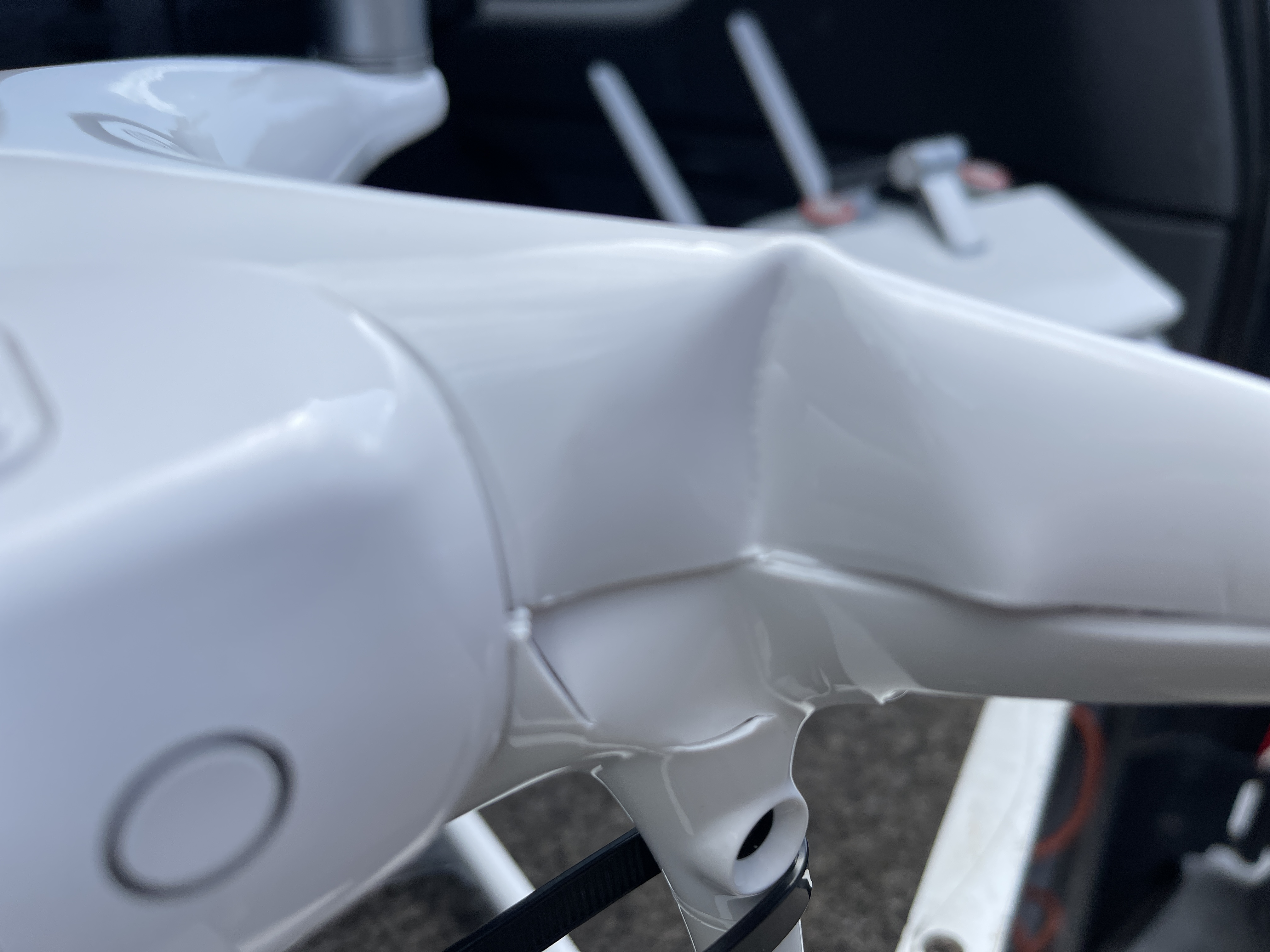

Meantime I had acquired a used P4 Pro in excellent condition from the same source. A few days ago, whilst taking off on my sixth flight, at around 15ft the drone abruptly stopped and dropped like rock onto the road below. What a truly horrible and heart stopping sound it was, the sound of plastic hitting concrete!
I was engaged in a paid real estate job at the time but fortunately the client was not around. I retrieved what looked like a pile of plastic waste from the road after a rotor and the battery had detached itself (there’s a clue here!)
Both top and bottom shells damaged including a nasty crease in one arm and a broken rotor. On first inspection I was convinced that this birds flying days were over for some time. However I changed the rotor, pushed some joints back together and installed the battery to see if it would show signs of life. Much to my amazement it responded in all areas with no apparent damage to camera or gimbal! After some low level testing (over grass) I was able to take off and complete the mission and obtain the required photos.
When I bought the drone, it was supplied with an after market, non genuine battery. I noticed early on the battery didn’t lock into place with just the usual push and required the clips on the battery to be depressed to fully lock. My best guess is that prior to this ill fated flight, the battery was not completely locked in position and lost it’s connection during take off, resulting in the fall onto the road. Apart from dumping this battery, I’m really not sure where I go from here. Replacement of both shells (here in Australia at least), I’m sure would be horribly expensive. Perhaps just replacing the drone would be the way to go? Your comments (and commiserations) are welcome 😢.

Replacing the shells is a process that take a bit of skill. Hardest part as I recall is soldering the wires back to the ESC board. I think each individual wire strand is coated. After knowing that and cleaning appropriately, a good joint can be made. I don’t think I’d do it for someone else for less than $200. Shells I think were in the $100~$150 range. Best of luck with your decision
I've replaced shells on P4 and P4P in US. Not difficult with correct drivers and a little soldering skill. Not expensive repair that took about 2-3 hrs each as long as lower shell with gimble/camera attached is ok.That is the expensive most valuable part. Complete P4P without bottom end available on eBay for few hundred US.
Upper shell seems to be readily available. The lower shell, at times, is a bit more difficult to find.
With that hard of a hit, possibly some motor issues may be present. It would not surprise me if the gimbal has something a bit out of place, but hard to tell by posted pictures. Possibly the yaw arm may be bent. I have had someone tell me they crashed a P4 and claimed the camera was fine. After a closer inspection, the yaw arm was certainly not the same as new.

I woukd think your commercial insurance would not have covered an accident if you flew to finish the job and caused real estate damage with the drone being in that condition (preflight inspection and all). However I feel your pain and wish you luck. I’ve changed gimbals/ cameras but never the whole shell!!
Thanks so much to everyone for all the suggestions and comments, your combined knowledge will certainly help me in making a decision. After Easter and it’s associated festivities, I’ll likely have stopped mourning and be able to make some constructive decisions 😉
I think another extensive test flight first to better access all the damage and then decision/$$$ time 🤔.

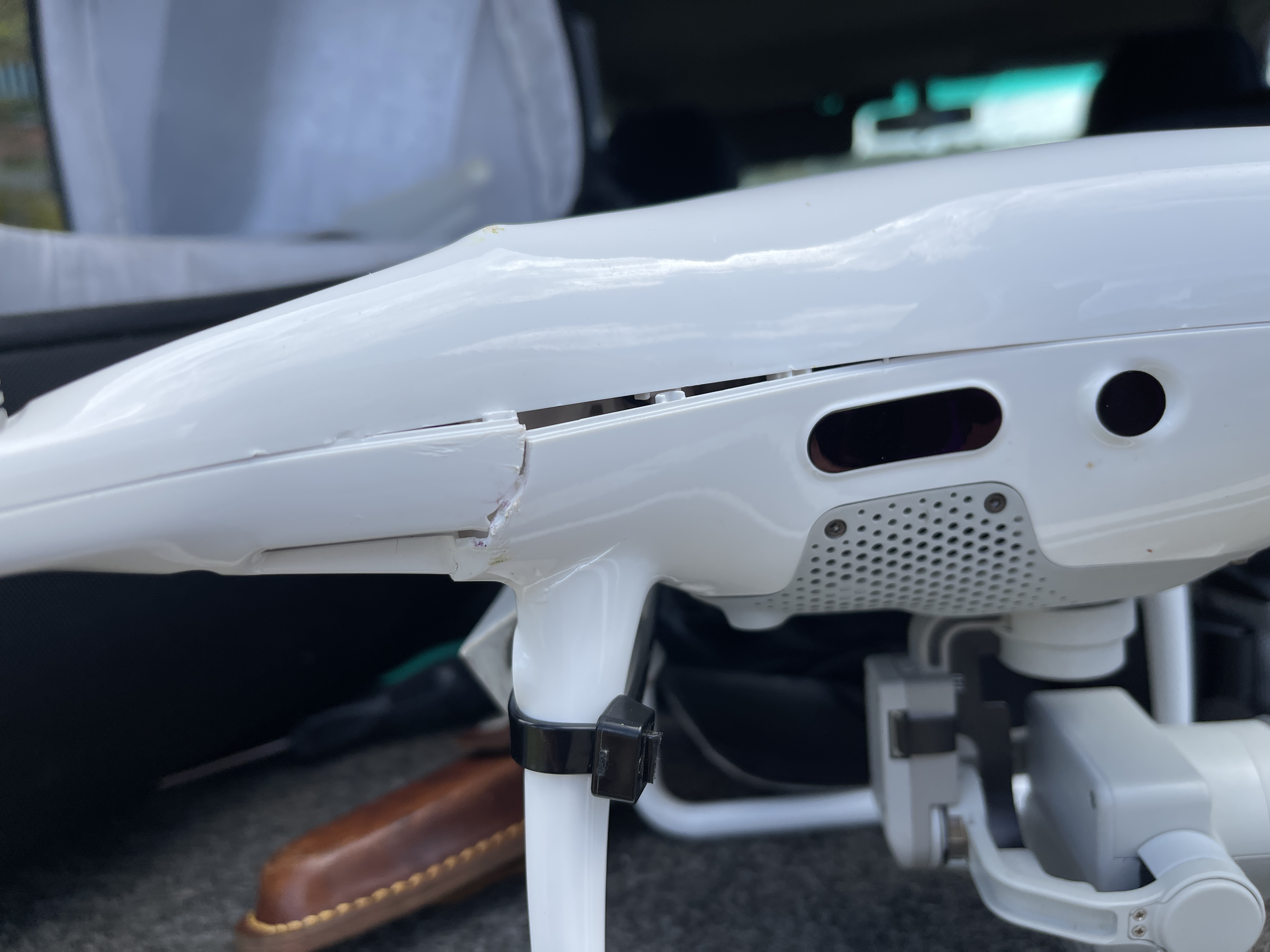

A loose or faulty battery may not have caused your crash. Sudden-loss-of-power is an issue with P4s. I've had three (different) drones crash for that reason. The battery is often ejected on impact, whether or not it's properly fitted.

I’m on my 2nd p4p and in 1000s (commercial 107 here) of flights never had a single power failure. I think he said it was after market battery. I always use OEM as I’m sure my insurance carrier would not pay up if I had an accident using non-OEM stuff. I have killed 3 or 4 batteries (started to swell) so took out of service and bought new or new old stock from various sellers and have never had an issue. The OP said he was doing commercial job so just food for thought.
