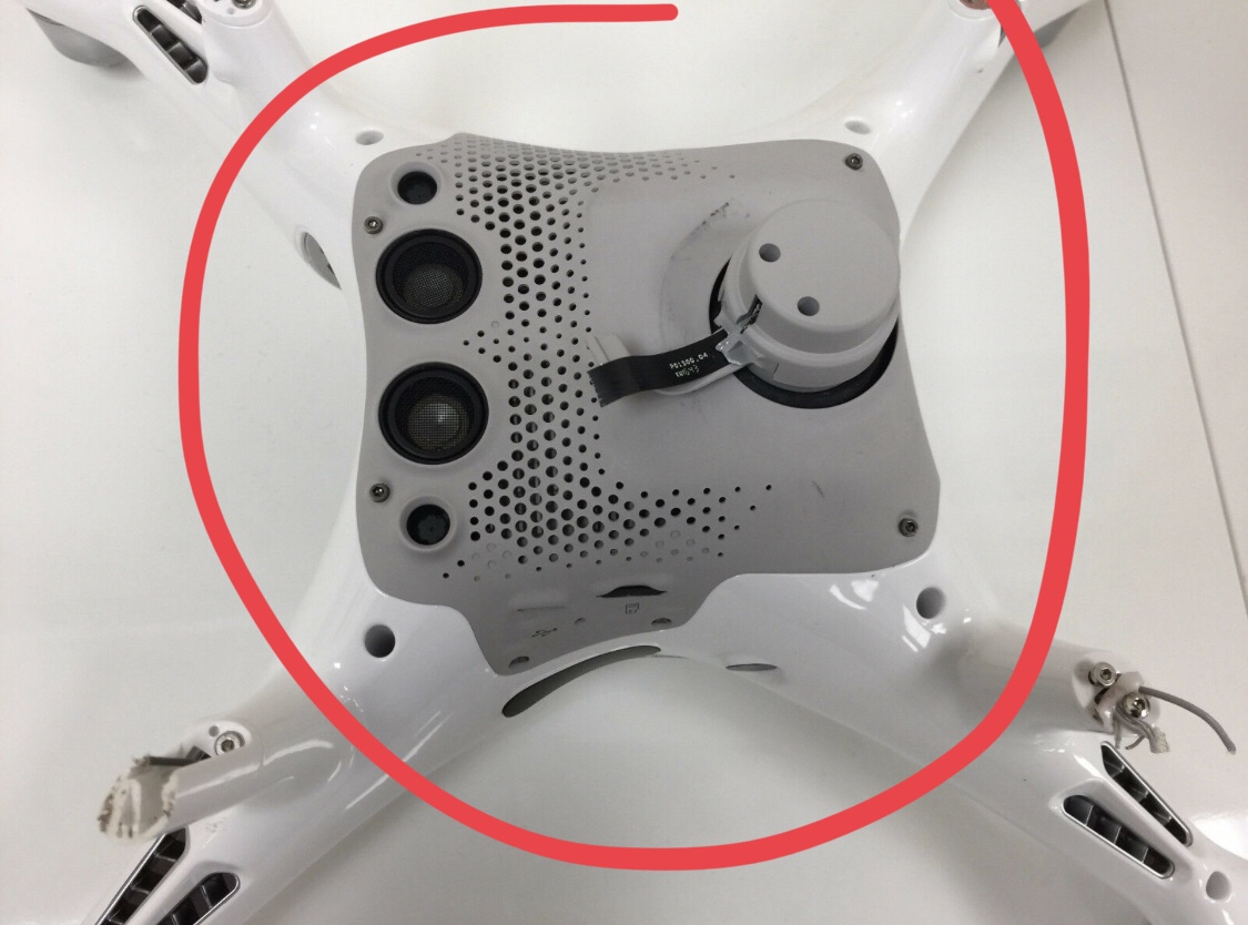

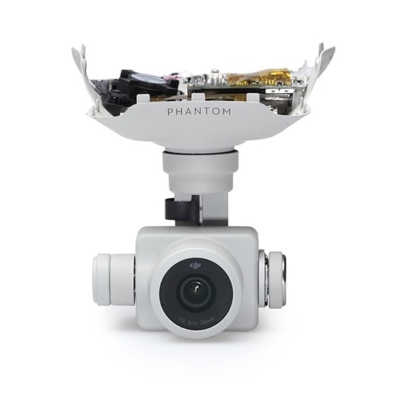

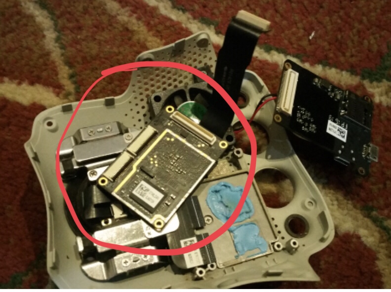

If it is not the ribbon cable then I am starting to believe the image processor is going defective… Which is rare but not unheard of… Unfortunately you cannot buy just the image processor… DJI does not sell it nor will you find it on eBay… I am going to have to buy the whole entire camera assembly ...[emoji853] and that is expensive unless I can find a crashed Phantom.
If it is not the ribbon cable then I am starting to believe the image processor is going defective… Which is rare but not unheard of… Unfortunately you cannot buy just the image processor… DJI does not sell it nor will you find it on eBay… I am going to have to buy the whole entire camera assembly ...[emoji853] and that is expensive unless I can find a crashed Phantom. View attachment 113344View attachment 113345
This is the image processor located on the gimbal assembly attached to the gray gimbal plate
