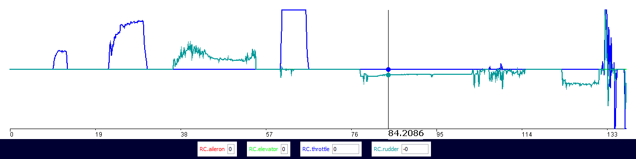

Sure you can get everything I looked at using DATCON and CSVVIEW: CsvView/DatCon
Thanks, grabbed both. Converted the .DAT file and have been having fun looking at the data. It is pretty obvious something went wrong, but what exactly is not clear.
Plotting the power draw vs gpsAlt and a couple other factors you can clearly see the GPS was reflecting real world actions (with normal GPS response issues), power draw increasing on climb and decreasing on fall. So the GPS and the power draw both indicate the barometer data was lagging badly. Since the P4 was (probably) reacting to the barometer to hold altitude the responses of the aircraft lagged the real world badly. And down it came.
Why it happened I don't know, but I will be keeping a closer eye on things, including looking at data post flight, for a while to come until I can determine there is not a system problem.

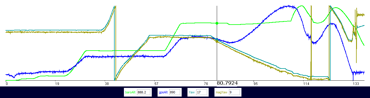

Ok so after digging into your logs, It does appear as though the craft developed a mind of its own for one reason or another in terms of the altitude. The barometer height and GPS height seemed to skew around the 100 second mark. It also seems as though the drone realized this as this was in the log:
106.061 : 846153654 : 9009 [L-FDI][FDI][CTRL]: fault on , height_ctrl_fail
That said, there was definitely some kind of issue that occurred with the barometer and height control of the craft. I don't know if it was caused by the environment or hardware. You could either send it back to DJI for diagnostic/warranty, or you could wait and see if it happens again.
Cool charts. I see where the GPS and barometer heights differed in the light green and blue lines. They only seem to agree at 20 seconds if time is at the bottom of the chart. Around 70 to 80 seconds later they really began to differ. I suspect the barometer is warming up perhaps but dunno. Some thermal electronic issue seems to be at play here. Maybe too much redundancy is making a mess out of the entire system. My P4 under belly sensors never report my landing spot as the same as the take-off by several meters. Really is a poor system for any height distances in my opinion.

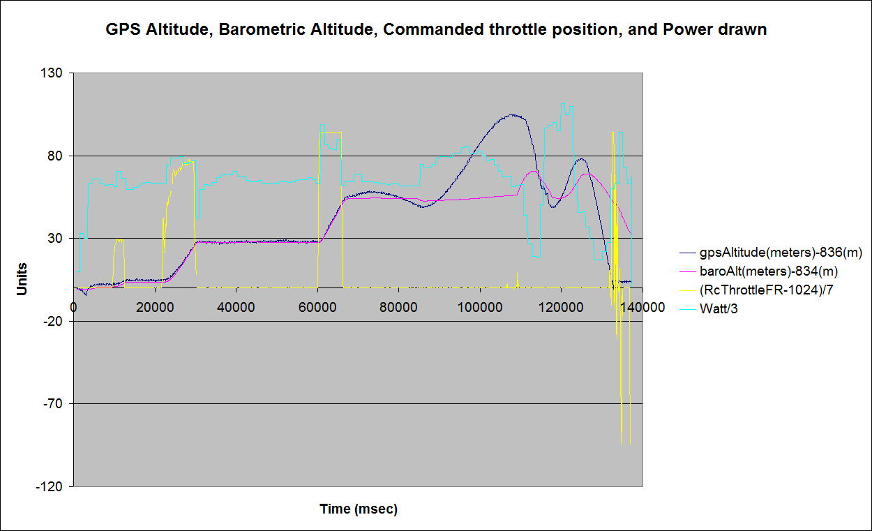

Here is a plot of the GPS altitude, Barometric altitude, Commanded RC Throttle position, and Power used.
GPS Altitude = Dark Blue
Barometric Altitude = Magenta
RC Commanded Throttle = Yellow
Power drawn = Cyan
You can see the power draw increase when the motors throttle up, and decrease when throttled down, whether commanded by me or the auto pilot. This is a fair indication of if the quad is trying to climb or descend.
You can see that the barometric altitude and the GPS altitude track each other well until about 67 seconds into flight. At about 86 seconds into flight the GPS shows the altitude under the commanded alt and also shows a small step down in altitude on the barometric altitude.
At this point (when the baro alt steps down about 2 meters or so at about 86 seconds) the autopilot attempts to raise the quad, you can tell this by the increased power draw consistent with throttling up the motors. The GPS altitude shows the quad rising reasonably quickly during this time, but the barometric altitude shows a much slower rise.
At about 108 seconds into the flight the baro pressure reaches the original commanded altitude and the current draw relaxes. GPS altitude shows the craft starting to descend. Barometric altitude also starts to rise, coming in line with the real altitude of the craft momentarily.
From about 108 seconds until impact the aircraft oscillates, porpoises, up and down. The GPS data looks to be responding faster than the barometric data. And the GPS altitude data represents what was happening in the real world according to what I saw/heard and the video recorded.
At about 132 seconds you can see my throttle inputs trying to stop the descent, and the associated power increase, indicating the craft was responding, but it was too late.
At about 135 seconds the GPS data shows the drone at the final altitude, on top of my truck, while the barometric data shows the altitude at about 39 meters up and falling. It also shows an increased power draw for several seconds as two of the blades were obstructed but trying to turn.
To me it looks like the autopilot got behind because of late barometric pressure data. It was responding, but several seconds behind what was happening in the real world. You can clearly see the power draw responding and the GPS alt seems to be tracking what would be expected from that power draw, but the barometric alt was not, at least not in a timely manner.
