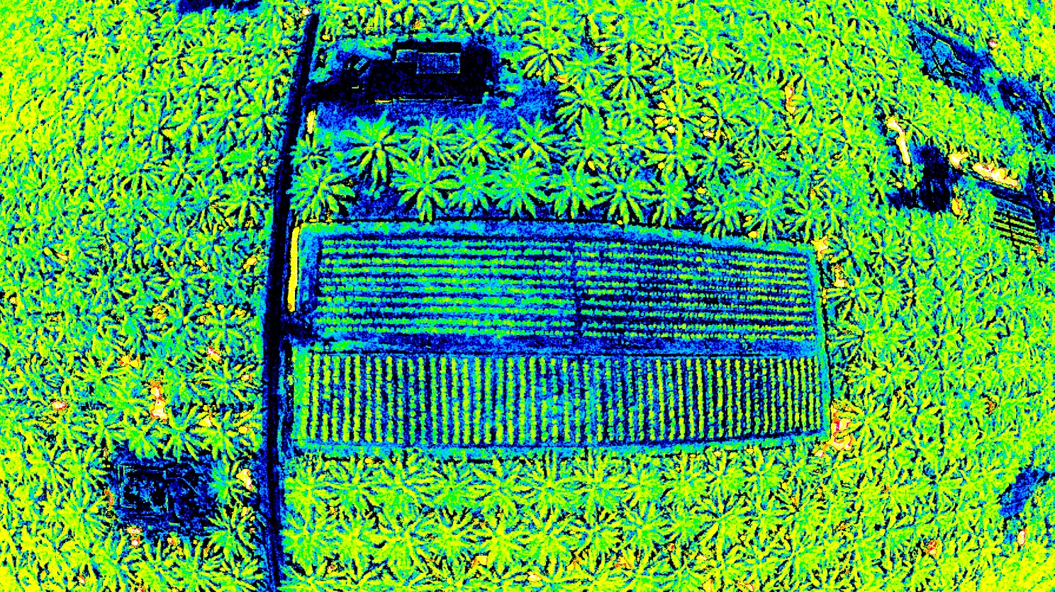

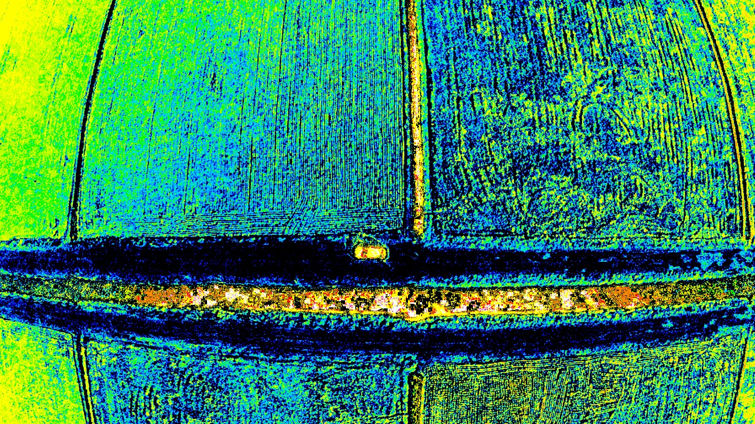

I've been using a P3S with DroneDeploy to create aerial farm maps, first in visual and now in infrared. I hacked an SJcam clone (itself a GoPro clone) to see NIR by removing the hot mirror and adding a red lens filter. The camera is mounted on a gimbal guard brace facing down and it's set to take a picture every two seconds. The NIR camera only has 2mp effective resolution but at 50m altitude, it's good enough to view crop rows.
For image processing, I'm using Fiji (a friendlier release of ImageJ) with the Photo Monitoring plugin to generate NDVI images. Both tools are free and open source. I'm generating NDVI from a single image, either from red + green IR or red + blue IR, because the hacked camera has a fisheye lens and it's hard to get images lined up with the Phantom camera's pictures.
First image shows rows of eggplants surrounded by oil palm trees. Second image shows rice seedlings about a month old.

Are you able to use these images for any real-world actions? For instance are you getting data from them that enables the farmers to make changes where-by increasing crop yields?
It's the first season that we're using aerial mapping and NDVI imaging so we're making it up as we go along... NDVI right now tells me what kind of crop yield reduction I might get from poor stand establishment or pest infestation. Hopefully we can spot leaf blights a few weeks before the symptoms show up visually. The NIR data isn't fine grained enough to plan variable rate application for fertilizer.
As for visuals, they're great for checking land leveling and to gauge planter machine performance. We get big yield reductions from patches of sunken, soggy soil combined with haphazard driving of the planters. This is stuff to fix during the next season though.
A technical note: I find I get cleaner NDVI images when shooting before 10am or after 5pm here on the equator. The hacked camera's red channel easily gets overexposed. I would recommend adding a neutral density filter if you're using a cheap hacked camera.
