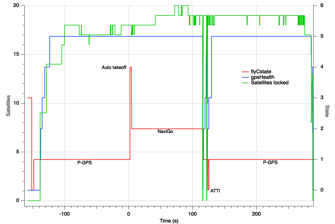

Links to both logs are below. I also have 2 links for screenshots from airdata log from where the same issue came up...I took a screen shot...., you'll see the bird went into ATTI mode, then GPS ...back and forth a few times.... I see I went from 19 satellites to "0" satellites in .2 (2 tenths) of a second on the 10/23/18 mission.

You are correct - the mission was ended because the satellite count briefly dropped to zero at 116 s and again at 122 s. I don't see any obvious cause - it doesn't look like a comms problem with the GPS module. You were 220 m from the bridge.

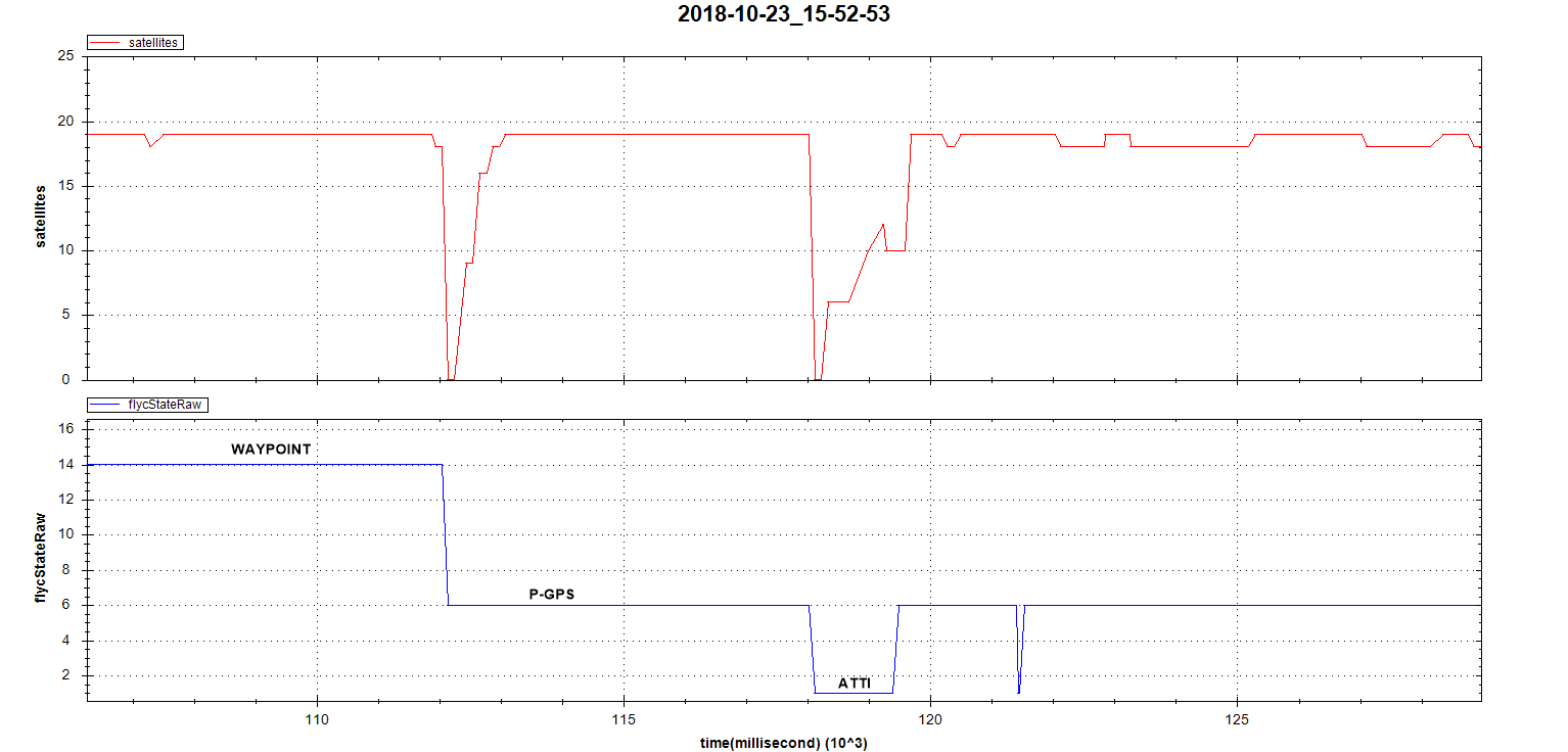

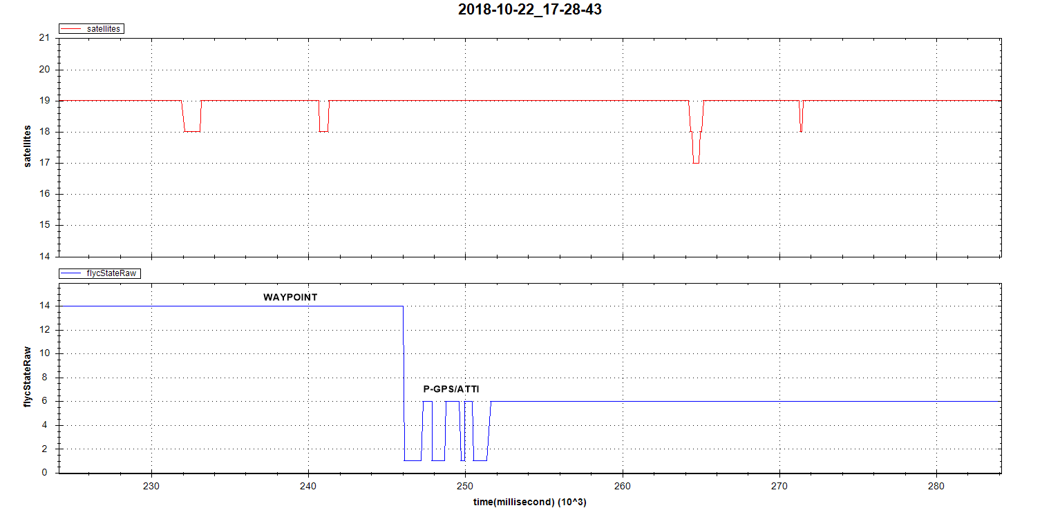

Oddly enough, the other flight does not show sat count drops. However, the mission did drop and the AC was in and out of ATTI. Haven't looked at the .dat files. These are just the 2 .csv's that you linked. Not sure what to make of that. One appears to be a GPS issue. Maybe the other is related or possibly 2 different issues causing similar responses?
This is the flight with the GPS dropouts. The other flight is right underneath.

I noticed that too Flydawg….in the mission showing no dropped satellites, what I was thinking is that it lost all satellites long enough to lose connection, but not long enough to record the event.....but maybe it doesn't work like that....
I gotta believe that the mission ending, and loss of control is related to the same problem in both missions, however the data doesn't necessarily reflect, that does it!?!!??

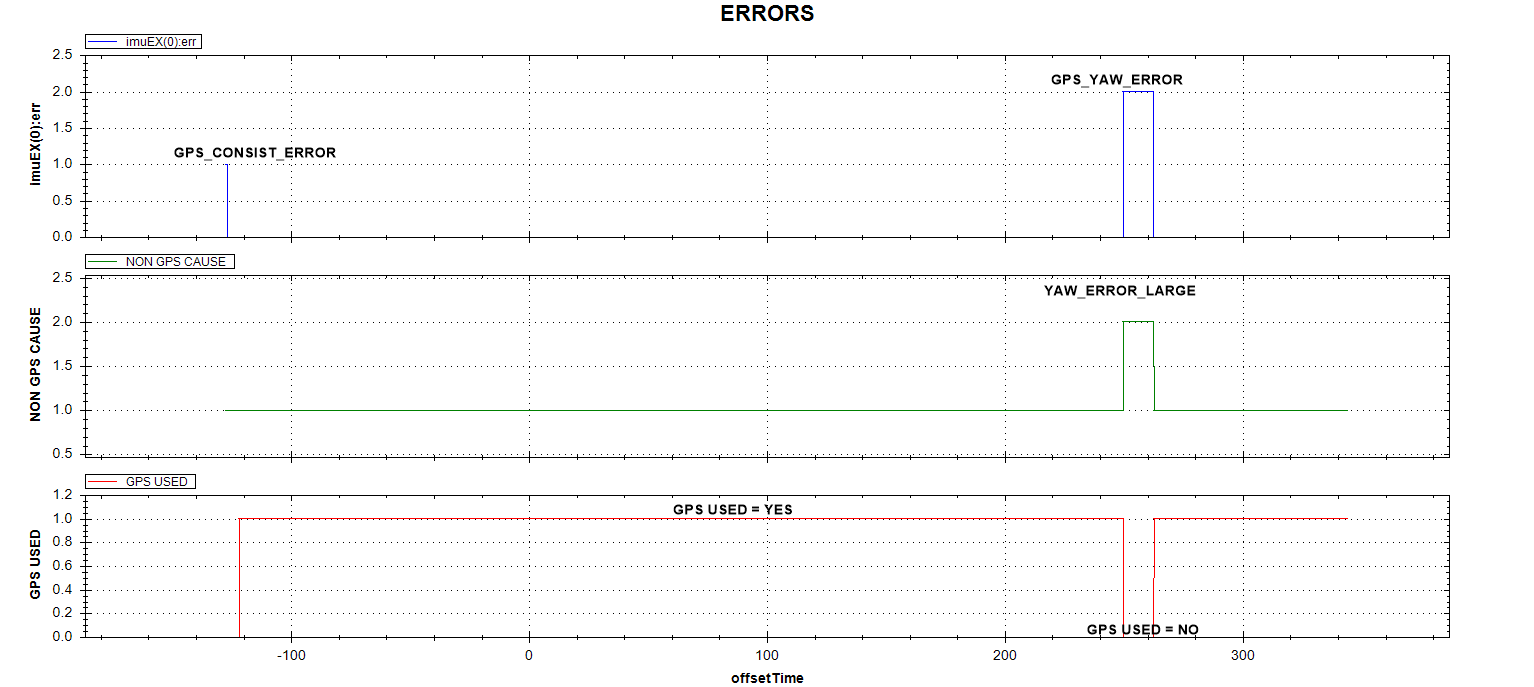

I would agree with that. Also, looking through the .dat files, both FLY406 and FLY414 are dated OCT 23rd. One of the .csv's you shared is dated OCT 22nd, ( which is the one I graphed above). That's ok, but it really got confusing when trying to differentiate the two at first while looking at the .dat's.
I am trying to shrink the trouble shooting universe down to a reasonable, and manageable size!
The above being said, these errors are from FLY406......No GPS dropouts, but errors none the less.

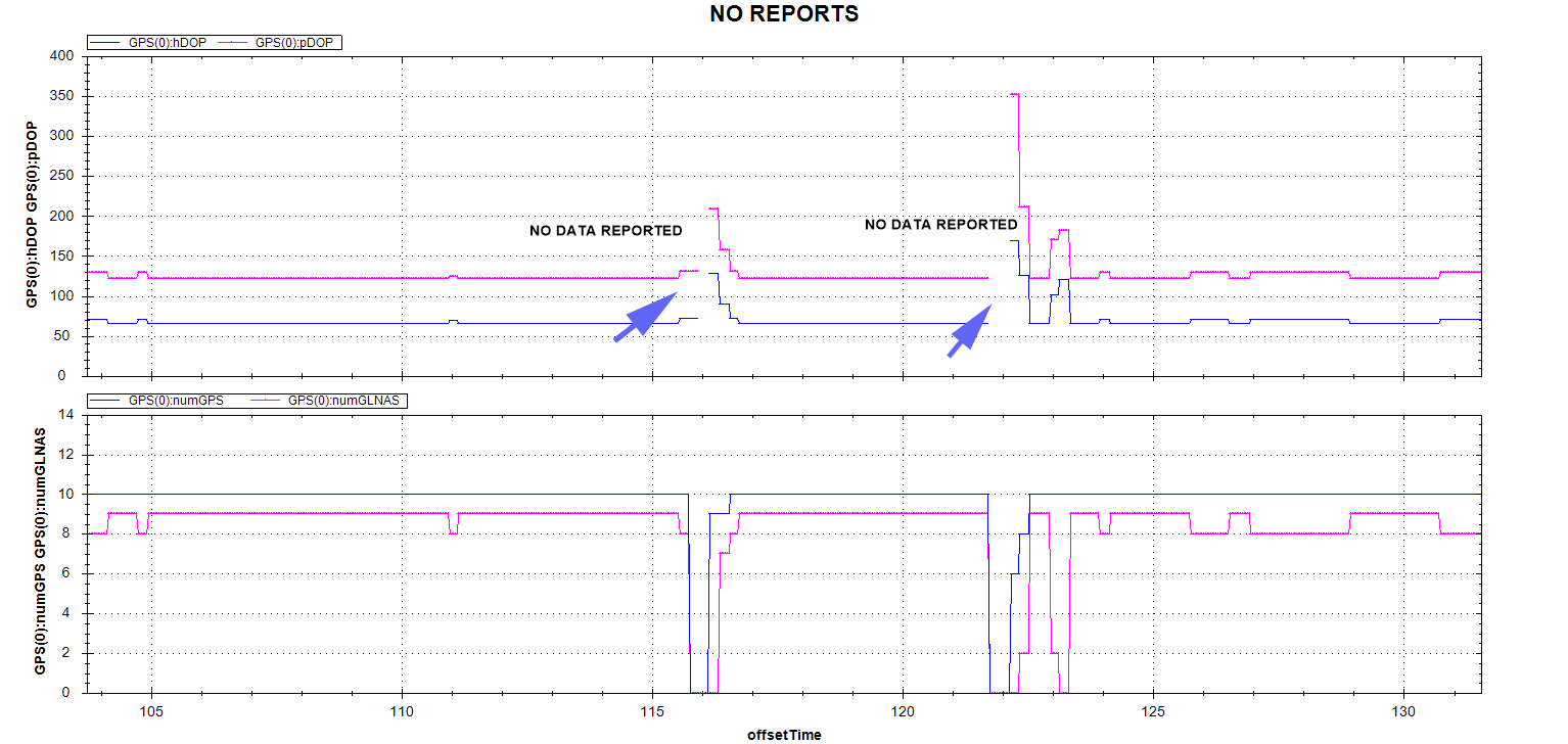

Below is from FLY414, a different chart but this could be a hint to concentrate on or near the GPS module. This chart shows that the data simply stopped reporting and the GPS dropped out. Notice the gaps in the top graph. There are no reports for that period.
