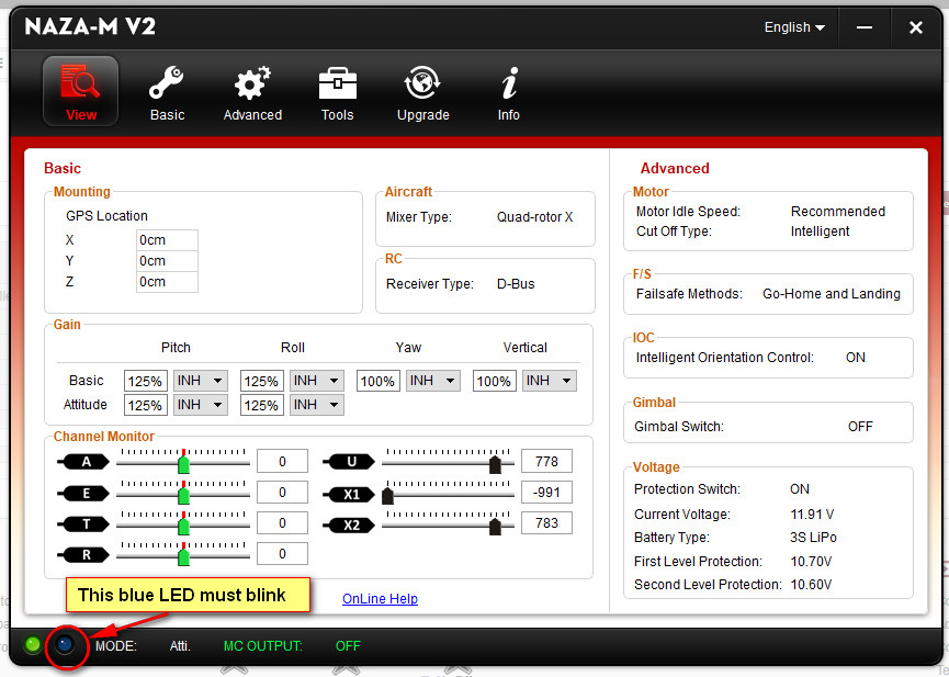

4 - Assuming you are working on a Windows PC, check if COM port named: "DJI USB Virtual COM" goes up when you plug the USB cable.
If not, you need to reinstall DJI Naza-M driver. On Windows, you must allow the installation of unsigned drivers before doing this installation.
5 - Run DJI NAZA Assistant, the last version is 2.40
If all is OK, you would get this screen:
If a popup about a new firmware version is showed, ignore it and click EXIT.
If channel A, E, T, and R aren't green, or cursor don't move when you move RC joysticks, it means your RC is not linked with the aircraft. You need to rebind your RC. Search on Youtube how to do. It's very simple, but you will open the shell, to reach the little button on the radio receiver located in the drone.
