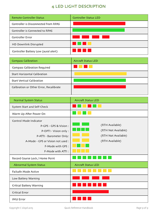

At first I though is was the receiver because the light was not coming on so replacing it I got a light still having the flashing yellow light with both RX and TX bind. Changed out the board no joy still have the flashing yellow light. Changed out the flight controller still have the flashing yellow light. I have a DJ6 controller D-bus and both lights are green RX and TX, but still yellow light is flashing. I'm stuck and don't know what is causing this light to flash. Have a phantom 1, 3, and 4. Any help would be appreciated.
