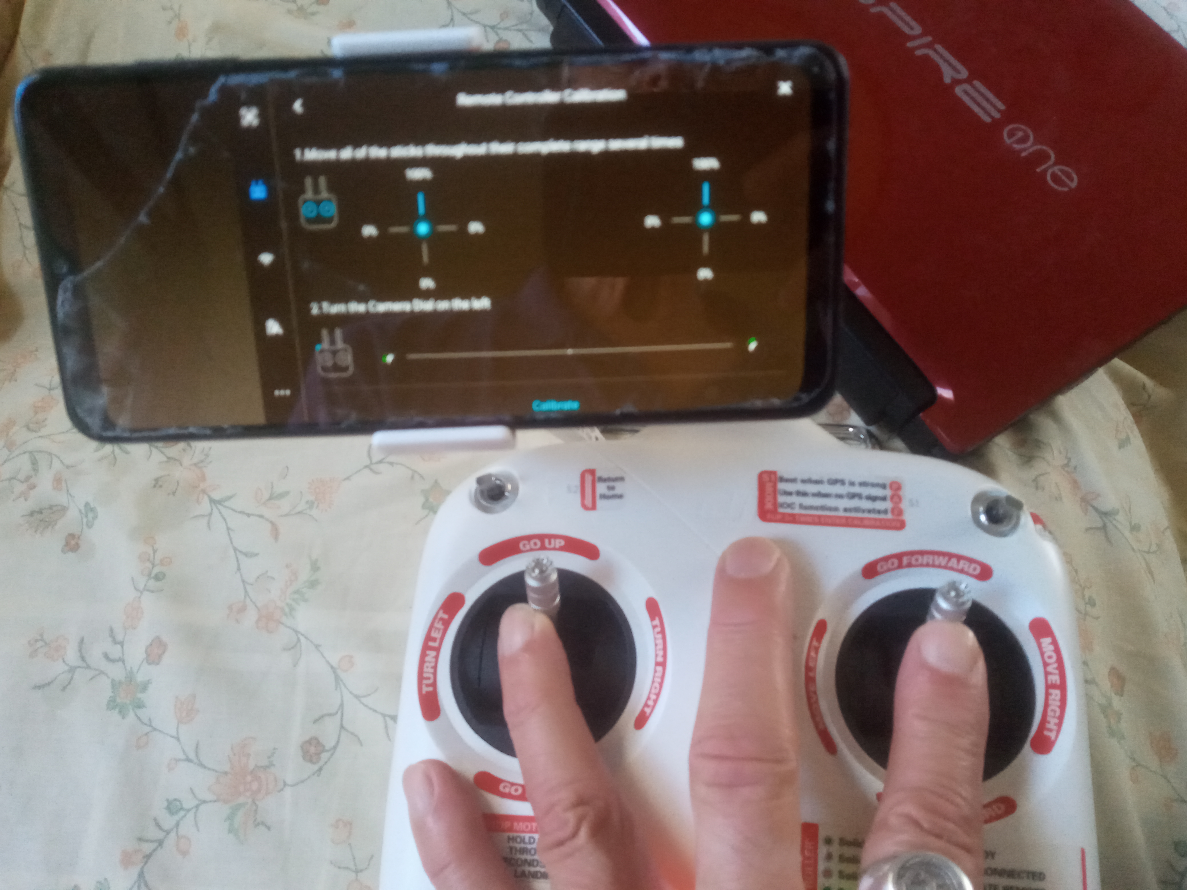

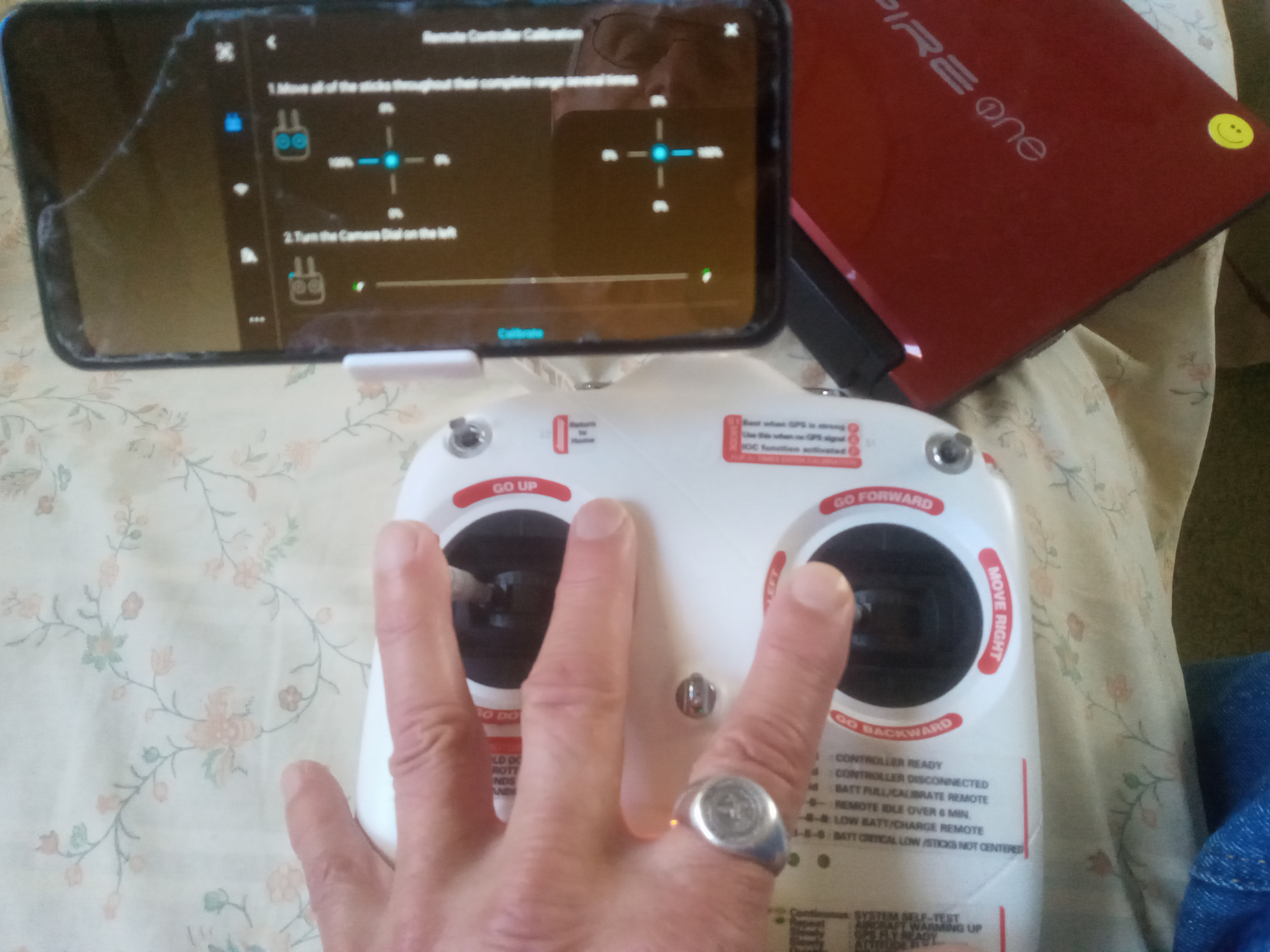

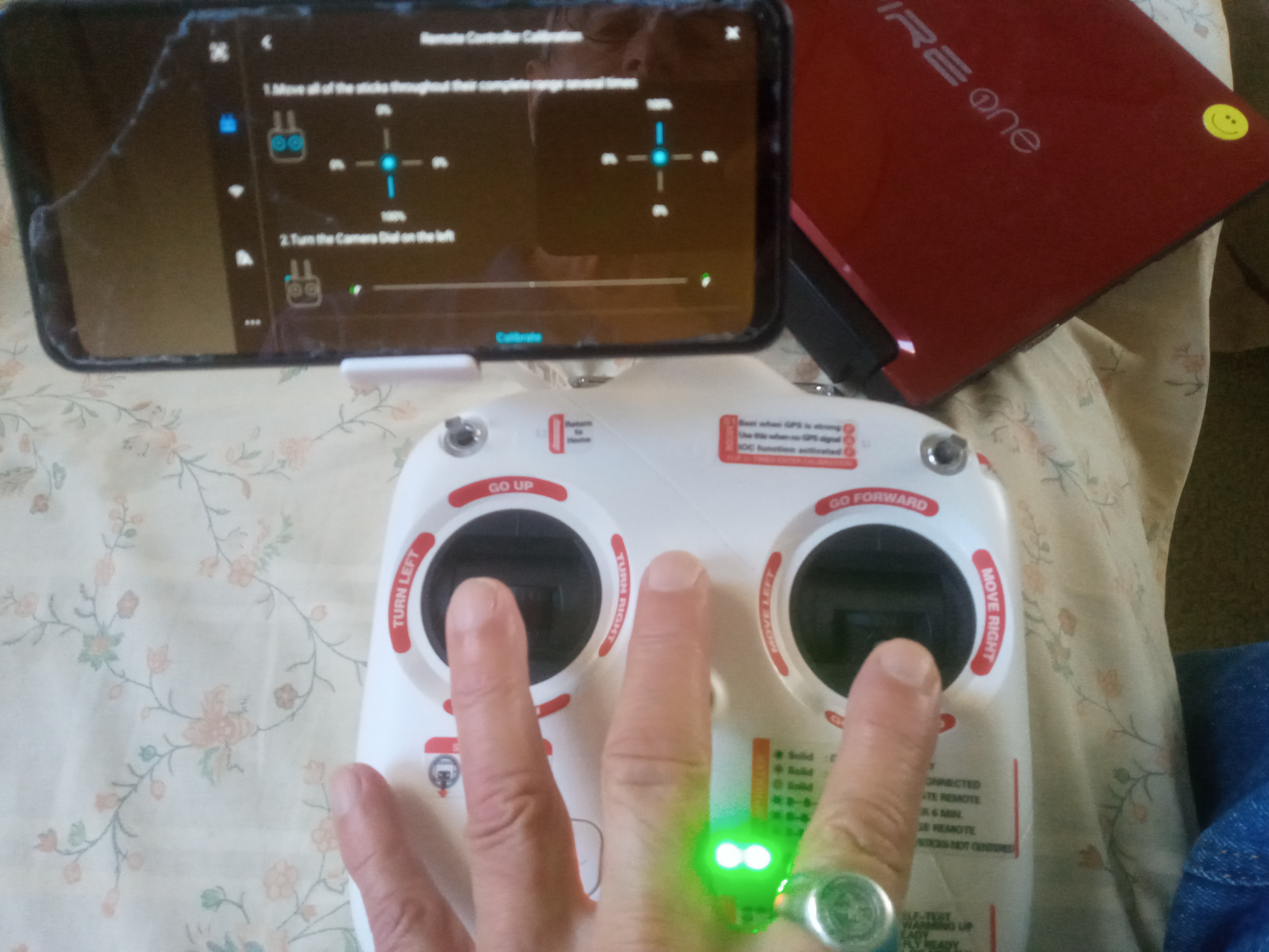

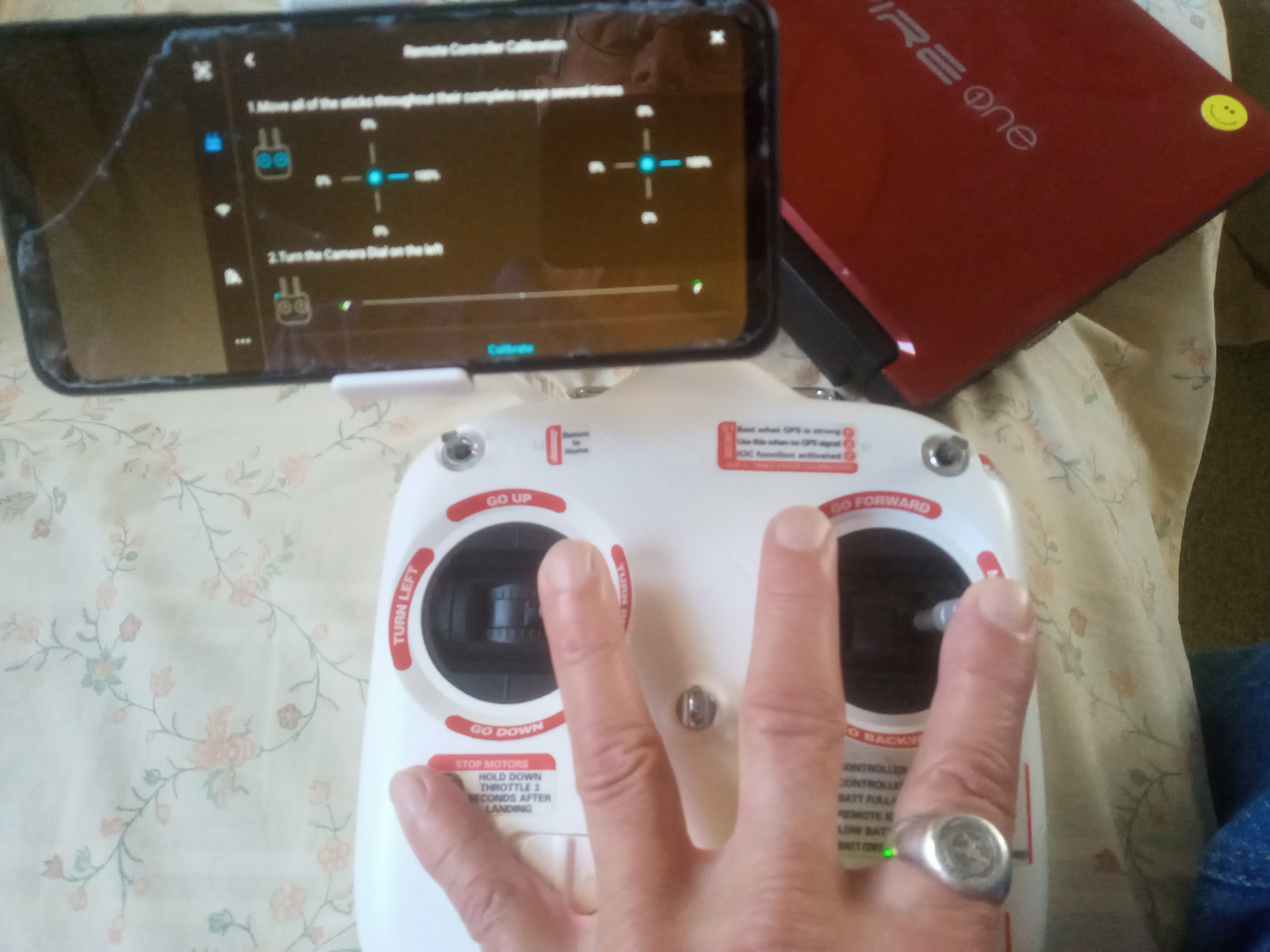

The only clue I have to a problem is when I calibrate the remote control in Mode 2 the calibration icon does not correlate with the control lever position, and will not change. Does anyone have a idea if this is a software or remote control failure Im really puzzled. Ill try to attach calibration photos.

Remote Control: In the RC calibration physical controls must respond to 100% on the DJIGo app Icon especially if any control issue is noticed. The original RC unit failed I can't tell if it as a hardware or software failure. Calibration icons do not correspond to the control levers position, I'm unable to change that. The only manual control I had was up, there was no down control, when the throttle lever is in down position the calibration icons shows throttle up. I didnt want to turn the RC control off or initiate RTH because I was recently flying at the Sycuan reservation and RTH was set to 300' because of terrain, I couldn't remember if I lowered it. My decision was rather than send a troubled flight higher try to bring it in manually.
