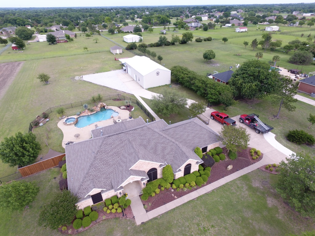

I launched between that little tree out back and the pool fence, closer to the tree. I stayed away from the shop and the concrete. If you can zoom in the concrete stops about 14' out from the barn. There was crushed stones added to give room for the RV to swing out, so that's is not all concrete. Also, there are 68 solar panels on the backside of the barn and the top of the RV cover.. I know there are better pics... , but this gives you an idea.

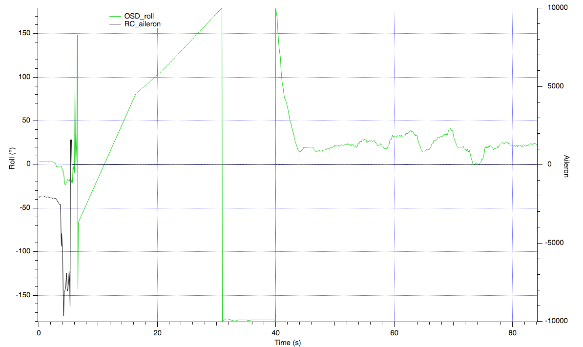

Here is the link to what happened (hope it works..) . It doesn't show the shop of the pool.. I'll find a pic of that. DJI Flight Log Viewer - PhantomHelp.com
That was ugly. You had a GPS position fix and were in P-GPS mode at launch. There was no compass problem at takeoff, and yaw was correctly initialized. The initial left movement that caused it to hit the fence at 5.8 seconds occurred because you applied left aileron for 1.6 seconds at 3.7 seconds. All the other issues in the log file are after the collision with the fence. That appears to have been entirely pilot error.
Thanks for taking a look Sar. My plan was to sit out there and get used to the toggle switches until the battery did an "automatic" RTH (to see if I had that set correctly.) I'm not sure what "left aileron" is, but I'm guessing it was the left toggle..? I would have pushed that up (to 12:00 o'clock) which I thought was correct. Does this show I did something else?
Siri says Aileron means the little wing on the wing that would make it "roll" or "bank". I'm guessing this report shows I pushed the toggle to 9 or 10 o'clock? It's possible, but I have to ask.. could this same scenario have happened due to an out of balance prop, or a damaged prop? I bought this SE used and the props looked ok to me. The new ones I installed late last night are much smoother.
Who took this pic for you? Do you have another drone that you fly?
Oh my gosh,glad no fingers lost,ok I presume this was the p3se ,worst thing to do is panic,that when things go wrong very fast,,,next flight get in hover and hold legs with left stick down,,it won't turn off straight away cause it off ground but does shut down after a bit,,when all on again check that imu do sent need calibration,does a self Check,yes remember it not a splash drone so avoid the pool,,as above upload your flight and someone clever say what happen..also don't let it bother you to much,get back on that horse and fly,,take care
My son took that pic last summer. He has the Phantom 4 Pro model. He did a great job. I got jealous and bought a used P3-SE to learn on. I can drive a farm tractor, a motorcycle, a boat, a 32' motor home.. I can dang sure figure this out! I may go thru a few parts here and there tho.. Right? :tearsofjoy: .

Sorry - aileron is left-right movement on the right stick (in mode 2). It makes it move sideways.
