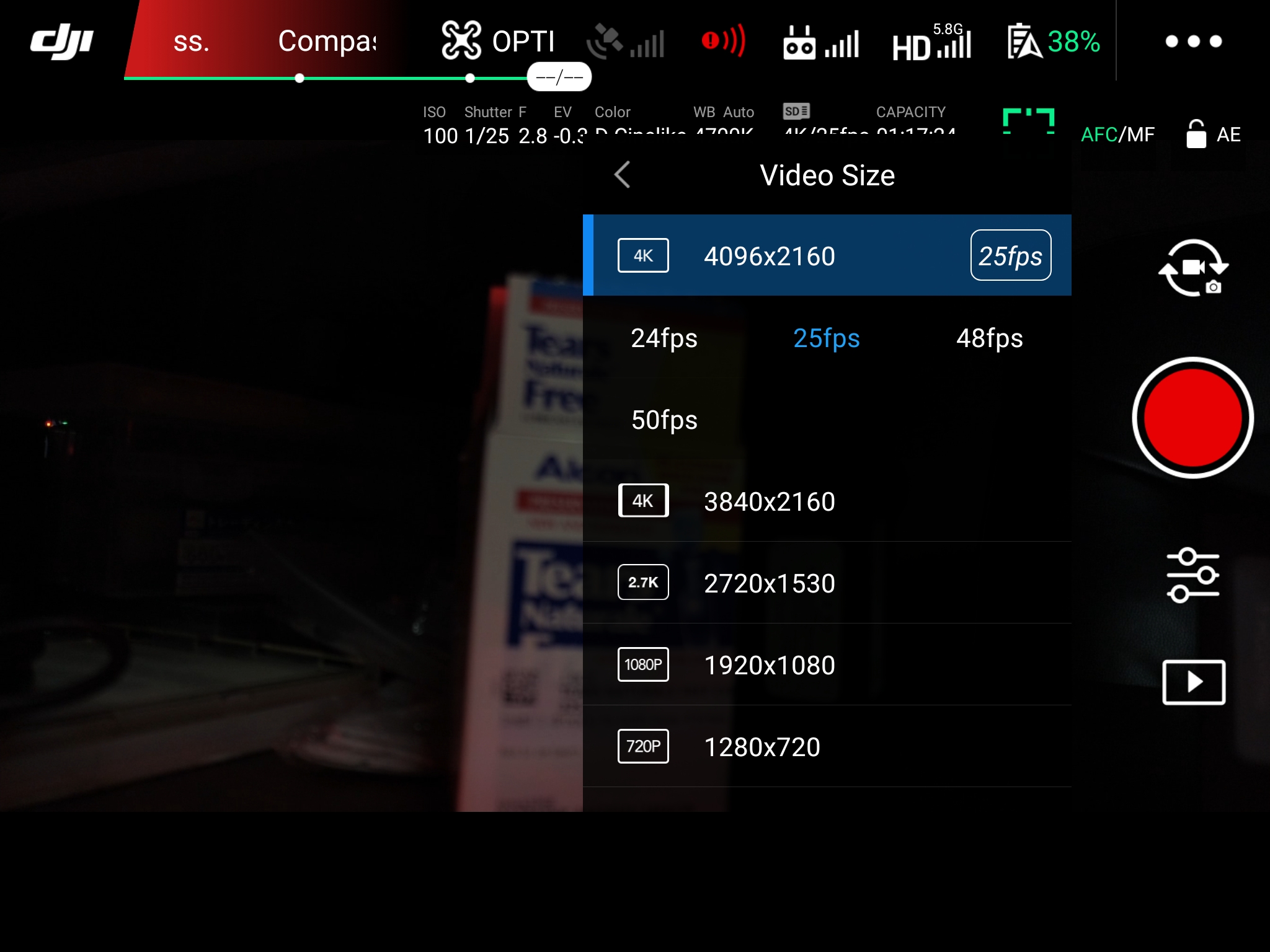

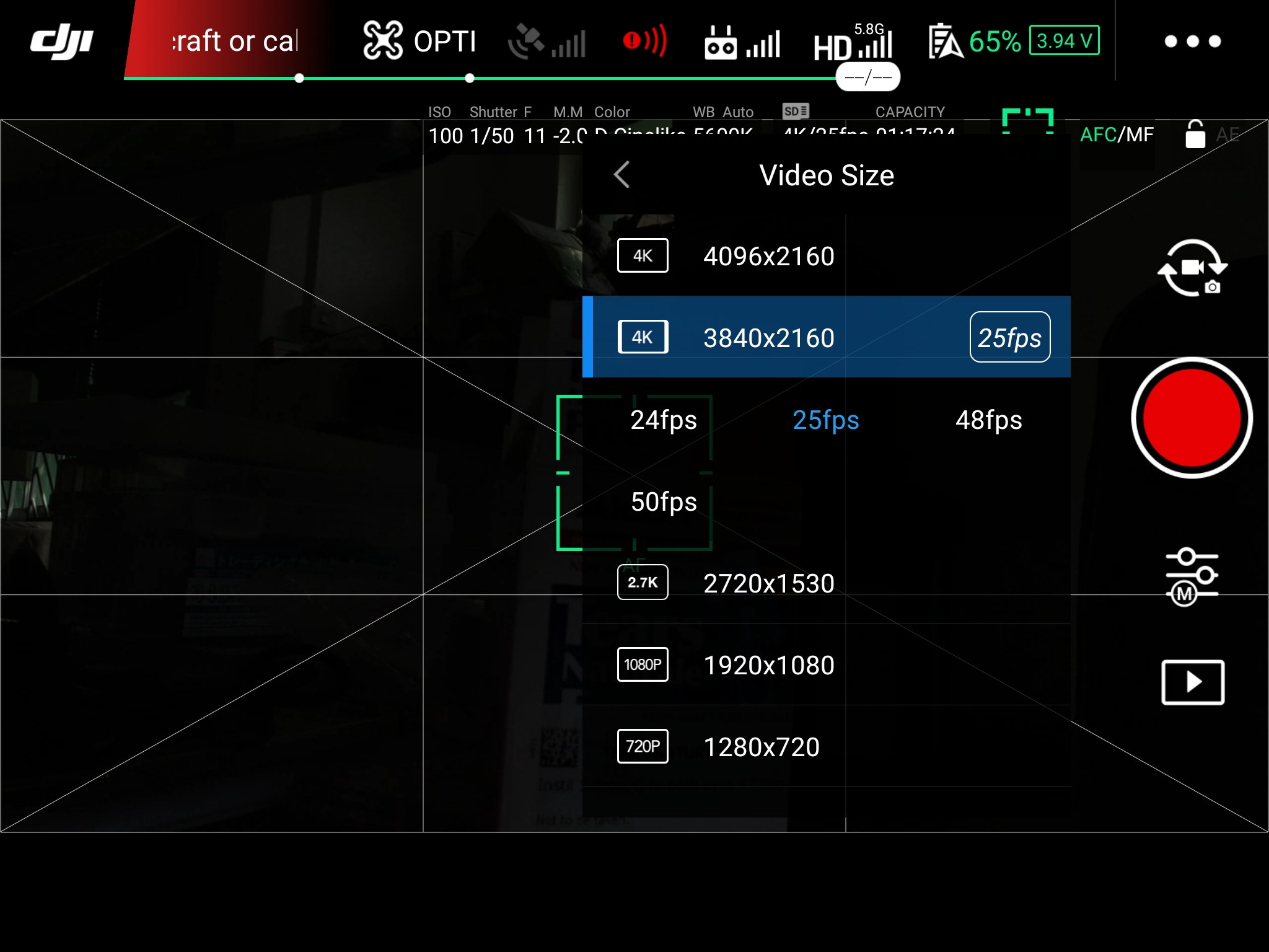

OzoneTech Joined Mar 7, 2021 Messages 143 Reaction score 11 Age 64 May 17, 2021 #1 Aircraft: P4P AC firmware V01.05.0600 RC firmware 01.04.01.00 Encoding format H.264 I have is a max 50fps choice in the selection menu. The P4P should have 60fps. Any setting I am missing out?

Oso Premium Pilot Joined May 19, 2015 Messages 4,964 Reaction score 4,129 Location Western US May 17, 2021 #2 Perhaps you’re set for PAL. 60fps would be in NTSC.
Andy9 Joined Aug 7, 2016 Messages 1,611 Reaction score 973 May 17, 2021 #3 It should be 120 fps even. But not with the highest resolution. It depends on how you set the video size.

OzoneTech Joined Mar 7, 2021 Messages 143 Reaction score 11 Age 64 May 17, 2021 #4 Oso said: Perhaps you’re set for PAL. 60fps would be in NTSC. Click to expand... Yes, it was set at PAL. Once I changed to NTSC, I have the option up to 60fps. Thanks for your quick response. Reactions: Capt KO and Oso
