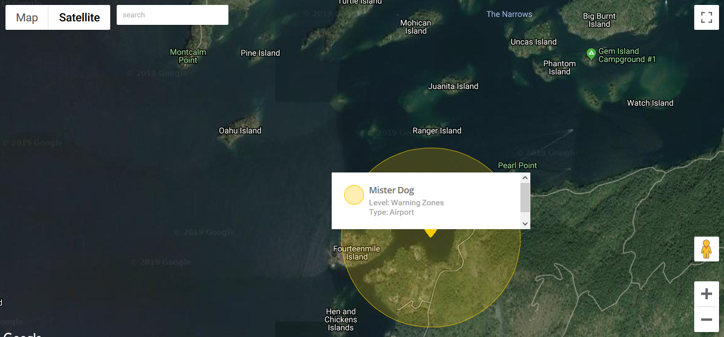

@bsartist .....Strange indeed. This is the closest I saw to the flight area. But even then it should not engage autoland.

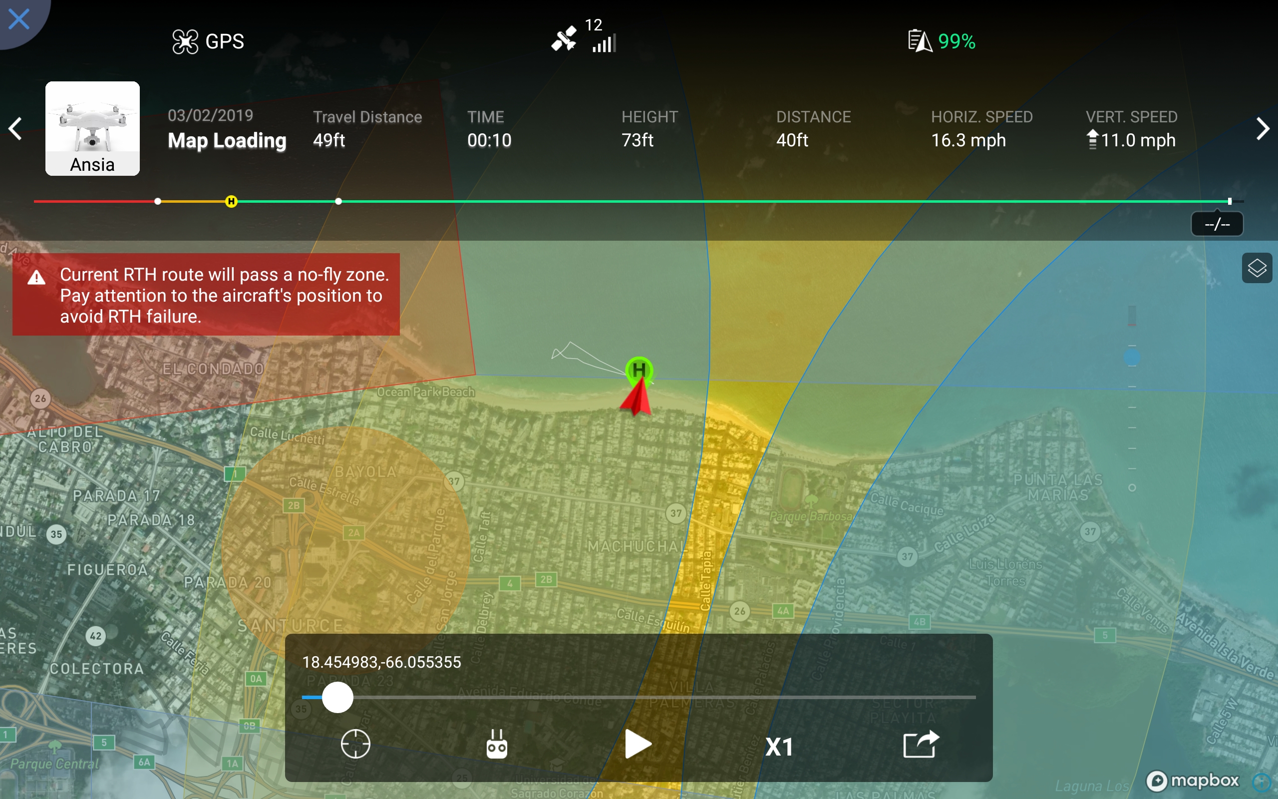

I've gotten notifications about possible RTH failure if flown by a NFZ. I don't k ow if it was the same problem you had.
Reactions: MotorCycle-Man
I've gotten notifications about possible RTH failure if flown by a NFZ. I don't k ow if it was the same problem you had.View attachment 109904

I did some more testing and there is definitely funky going on with respect to me being somewhat close (within 5 miles) of that defunct but charged seaplane base. Not sure if it relates to my autoland problem but it seems suspicious.
When I power up near my house (within the 5 mi. of the “airport”) I initially get “cannot takeoff” while it’s acquiring sats and does not yet have GPS mode (sats OPTI). I tap that warning and check status. Sure enough sats no fly zone.
Once enough sats are collected and GPS mode turns on and green, home point is updated and I’m cleared for takeoff.
Is this a deliberate design? I’d think either I’m in an NFZ or I’m not.
I drove well outside the 5 mile radius and powered up the aircraft. No NFZ warnings.
