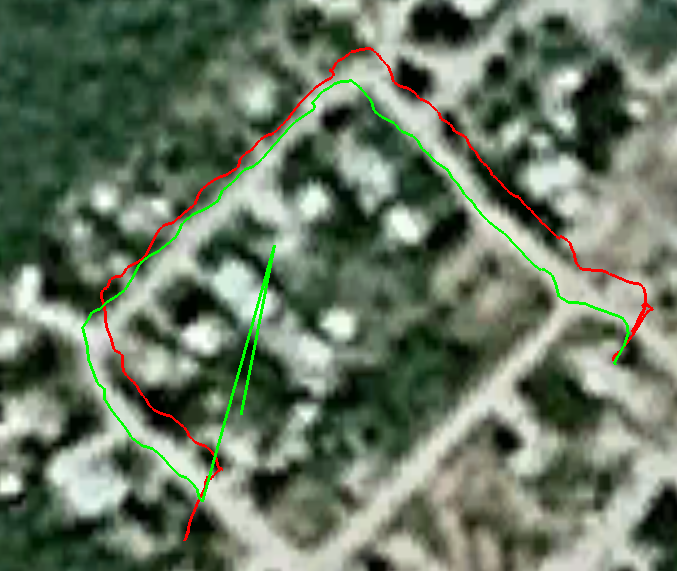

Can you take a look at the attached? Inside that .zip you'll find XbironFLY021.kml. Open it in GoogleEarth . The red line represents where P3 is. I'm supposing the green line represents where the P3 thinks the remote is. Except for the jog at the very end does this seem right? It's a lat-lon field in your .DAT that I've not seen in any other .DAT. I'll do an exhaustive search here sometime today to see if it exists in others.

Yes it is totally right. The crazy thing is my remote's position went north then come back south.
Do you think, the remote (phone) position could have been at the false position at north just before follow me mode was engaged. And then, when I started follow me mode, the remote position went south a little. In this case the airplane wanted to keep the same distance between him and the remote, so he went to south too. In the same way that the false remote movement.

Seems right. I'll be interested to see if @gegetrane, or @MoOriginal have flights with the same situation.
I didn't dig out the altitude data for the remote's location. I'll try to do that in the next couple of days.
Also, the RC track shown can be sampled at a higher rate. I'll get the higher rate and see if that's more informative.
