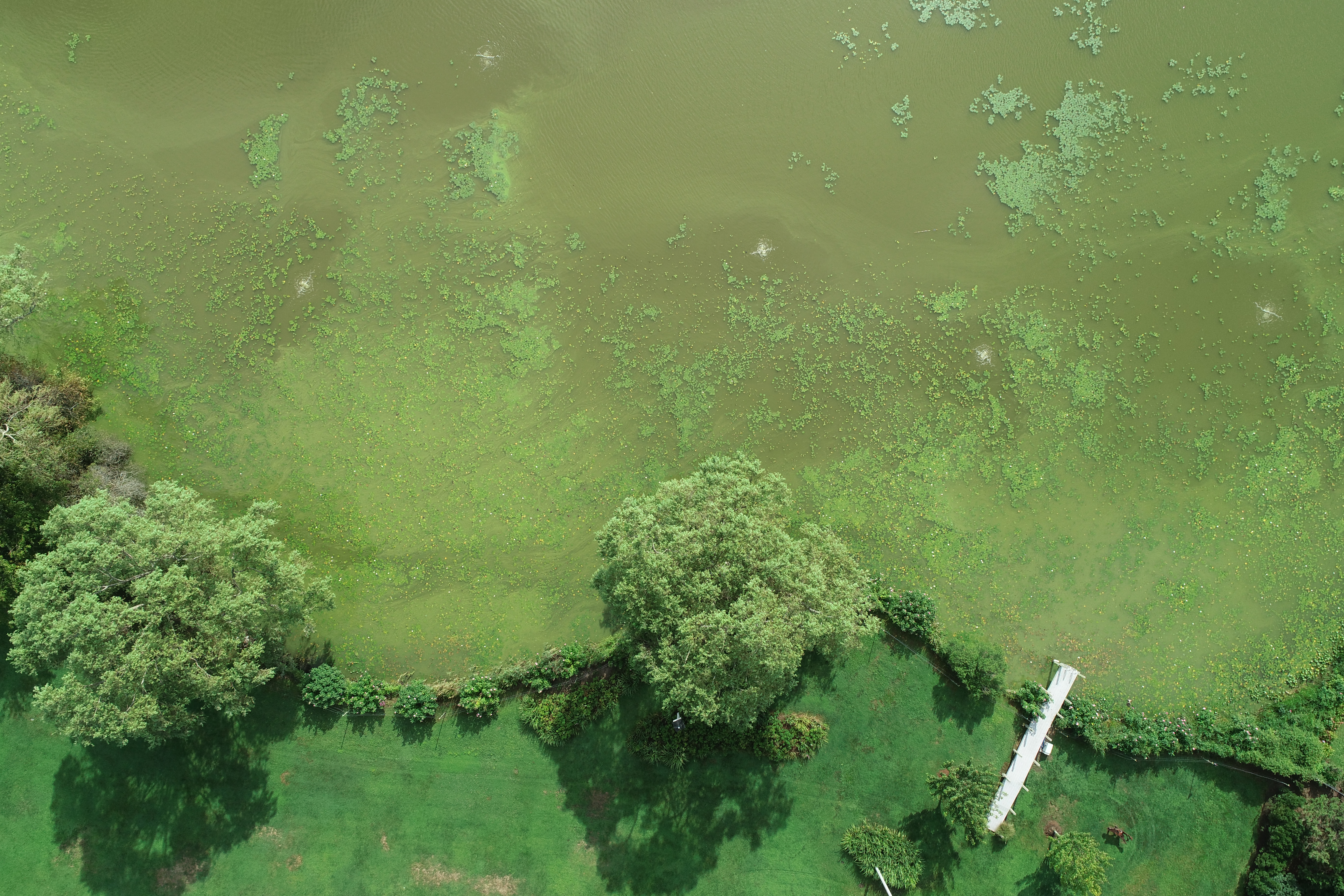

I currently fly a P4P_v1 and use the free version of Map Pilot Pro (by Maps Made Easy) for my ortho mapping. My firm does environmental work and I've used Map Pilot Pro for mapping the extent of invasive lilies in a local algae choked lake. Their processing and stitching service is pay-as-you go (you buy credits) and I find it quite reasonable. Attached is one of the tiles. I've had 275 orthos processed for about $30US. I can't advise you on the hardware. I'm sure others here will chime in to help you with that.
Cool, thanks.
I'd discounted using a online sevice as thought the costs would be higher than were justiafiable for us but thats pretty reasonable.
