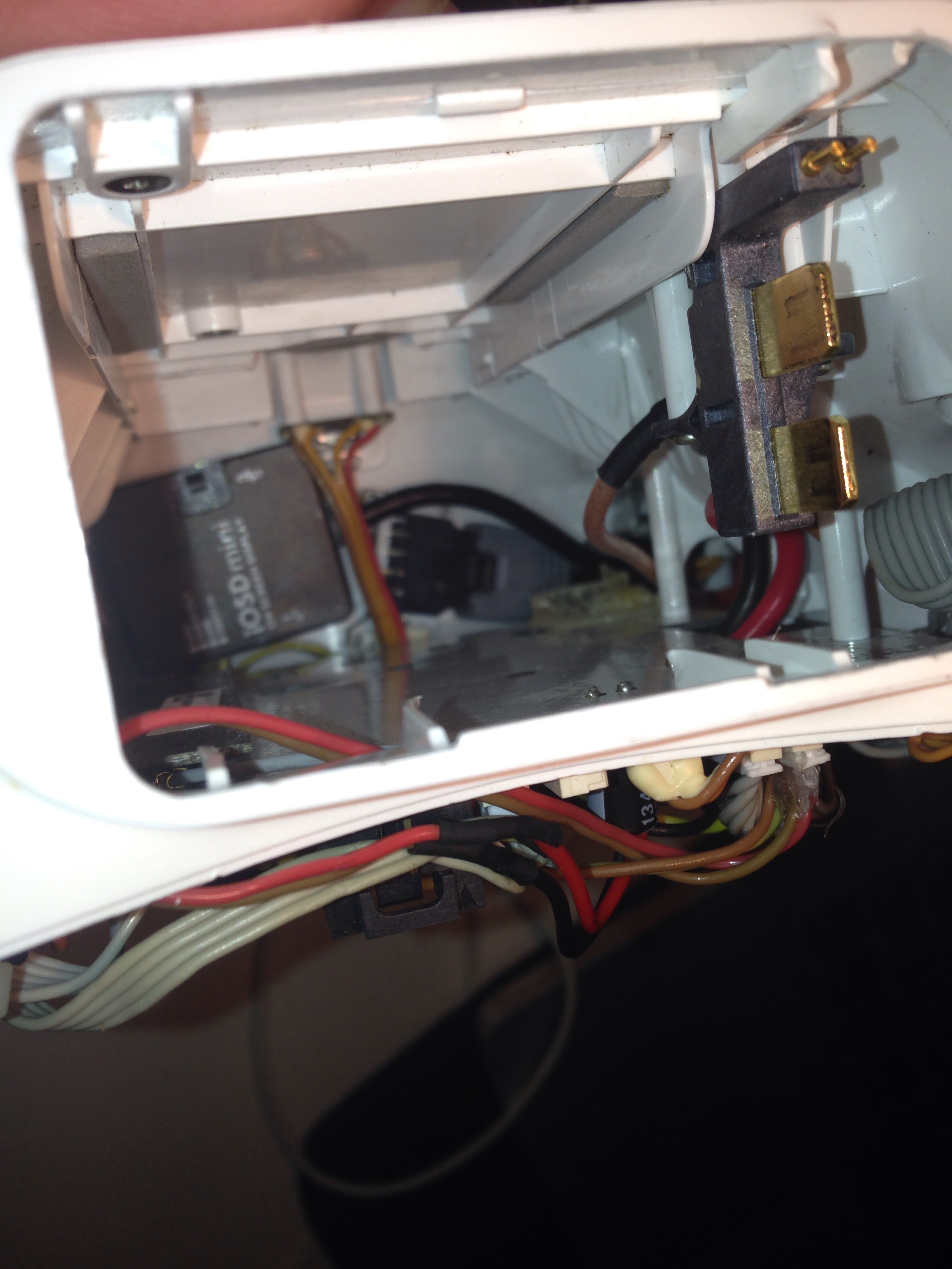

Please can you take a few pictures of the area near video card so we can make a decision as to what happened....Thank you Giogi .

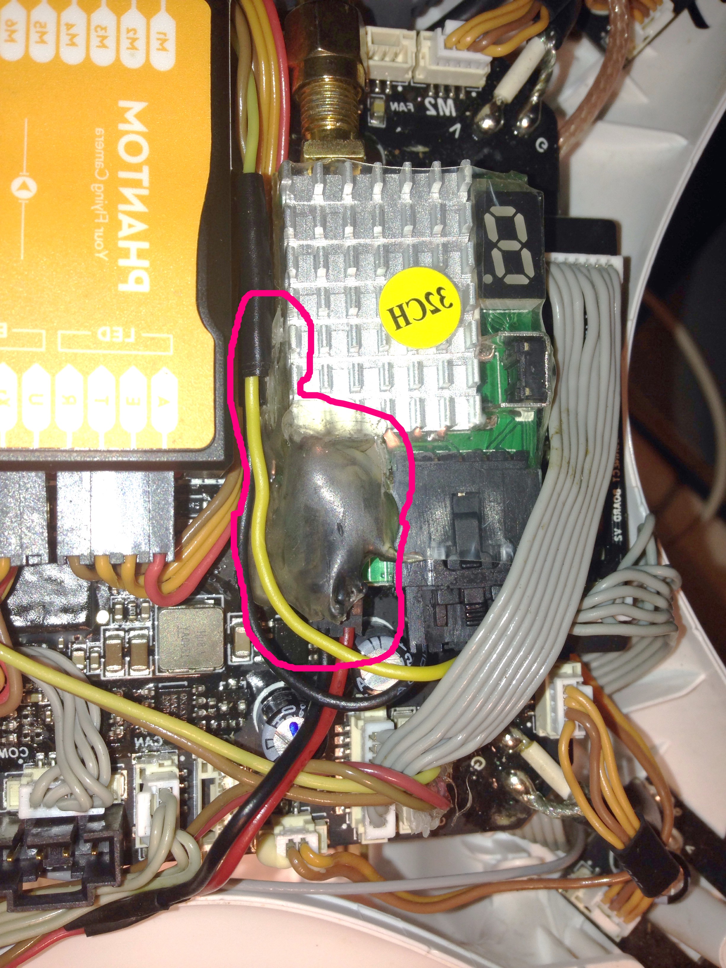

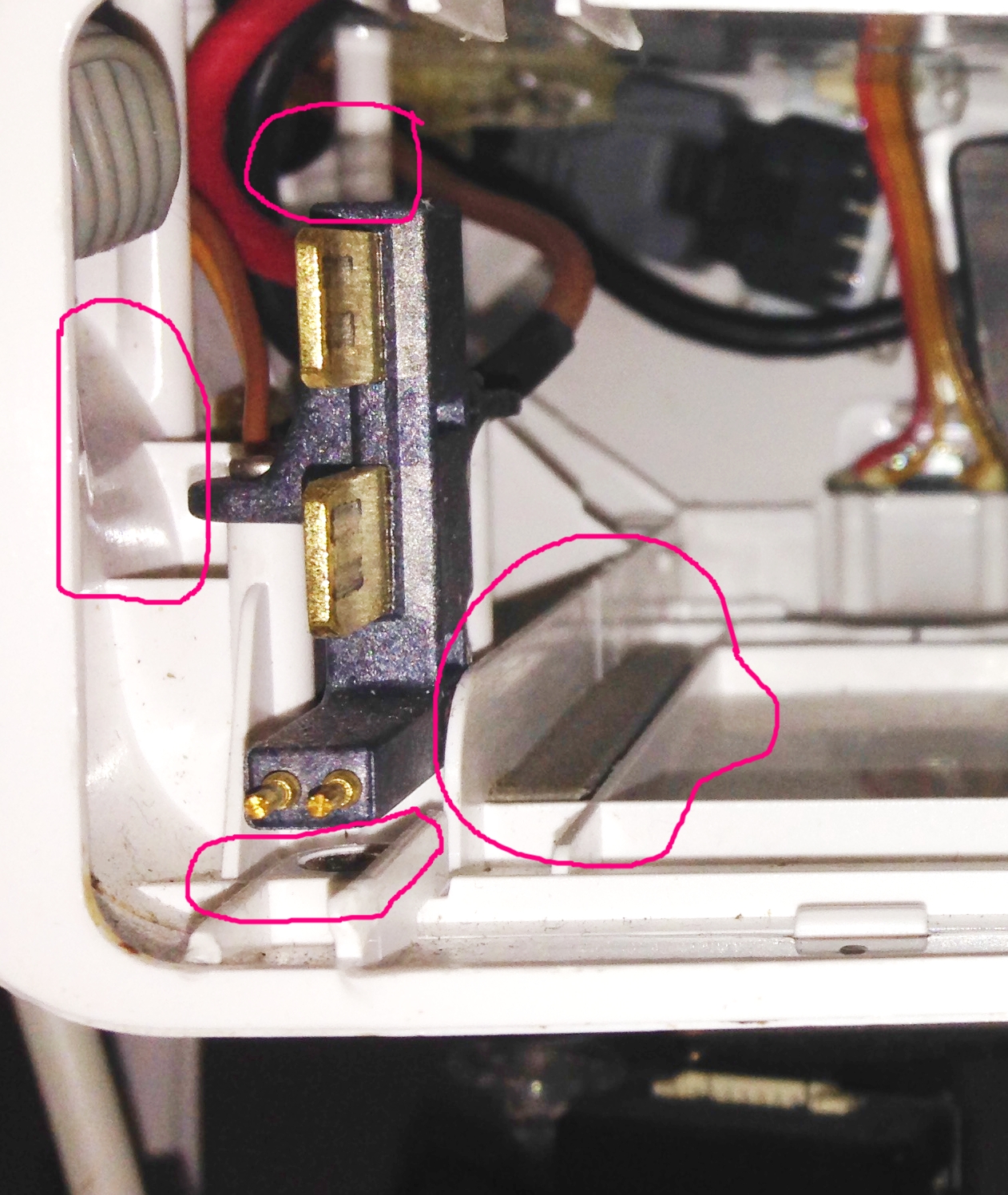

Look at the smoke stains in the red circles !....to meeeeeeee it looks like a near fire at them terminals...or they been very very HOT !
Both terminals show lots of usage too !
As a photographer what you have circled look more like shadows from the angle of the camera than from an overheated battery.

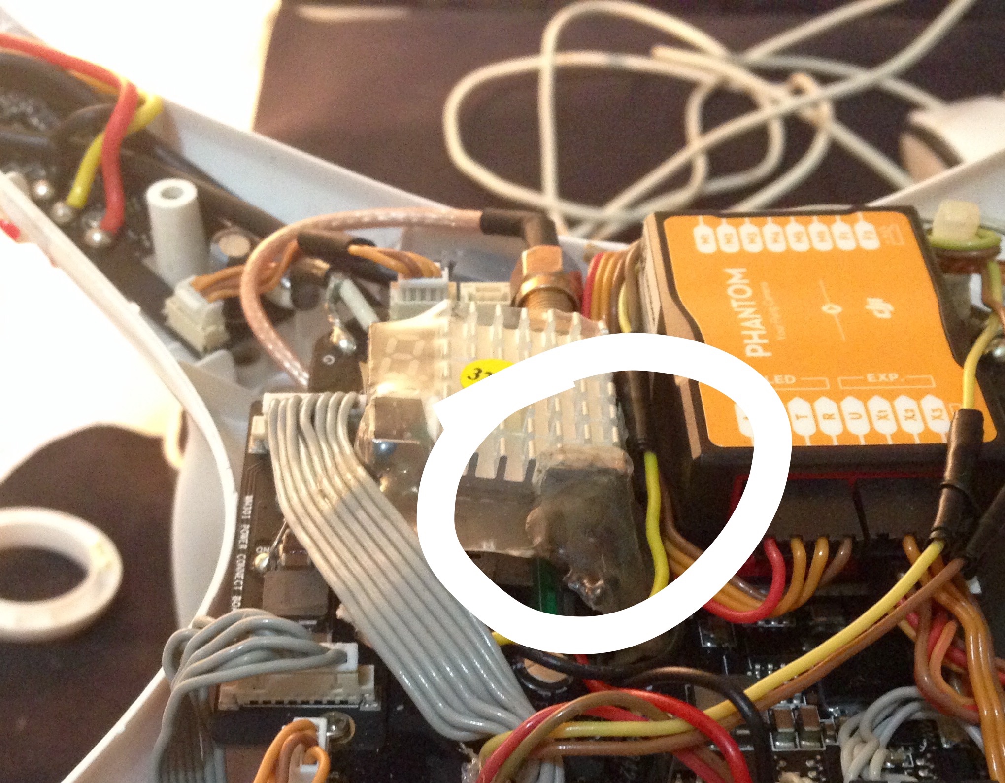

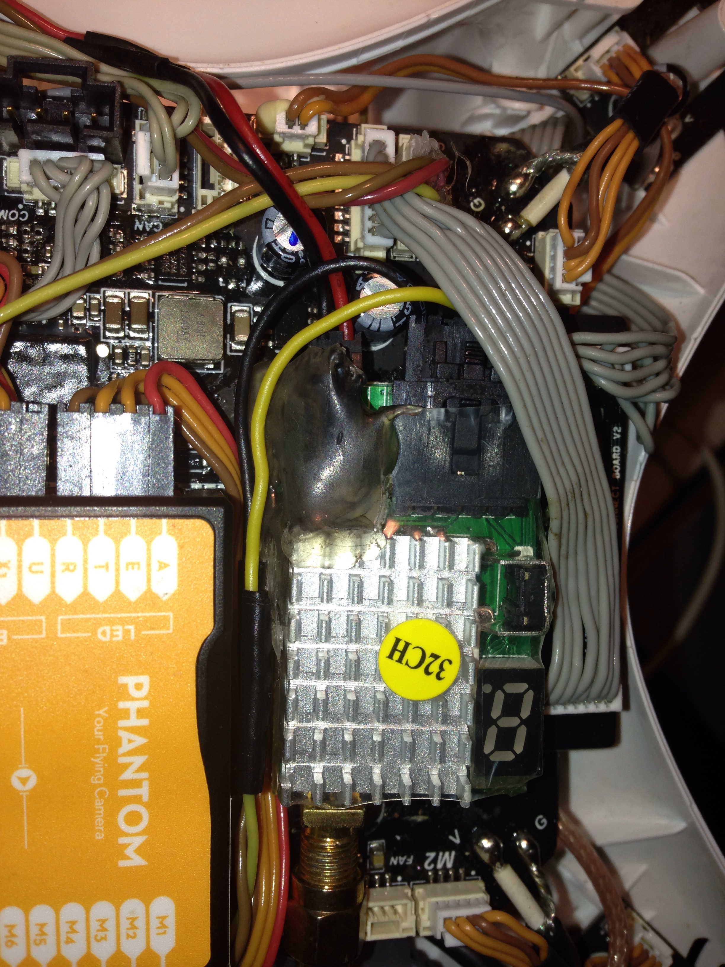

Here is the photo of the video card. Yes Jason, it was a shadow. Thank you all for your help.
The circled red area has been really hot.....if its BIG Blob hot glue which i think it is....its actually run down the sides of the heat sink...how much money have you got in this drone...the repairs might be way beyond what your doing......A drone has to be very reliable as NOT to fall out of the air and hurt some one badly or worse or damage personally property ...the large red and black wires coming to a point to that blob of glue...are right off the male battery posts " Right Jason " ?

Yes, a battery is swollen and faulty. The other battery is damaged. I bought a new compatible battery and I wait it. The video card is broken and I'm changing it. Near the connector of the video card there is a trace of molten plastic (is it black, fire?).
