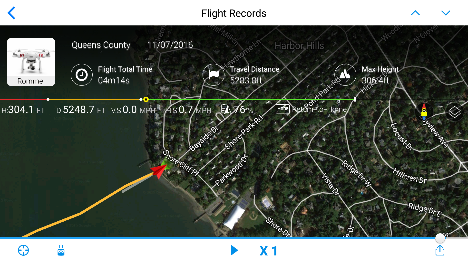

    NYC is tough but you can find range if you try.
  20. longdog
    Jun 19, 2016
    273
    75
    Wow. That's pretty good for stock in NYC! I am impressed. No windsurfer or anything?
