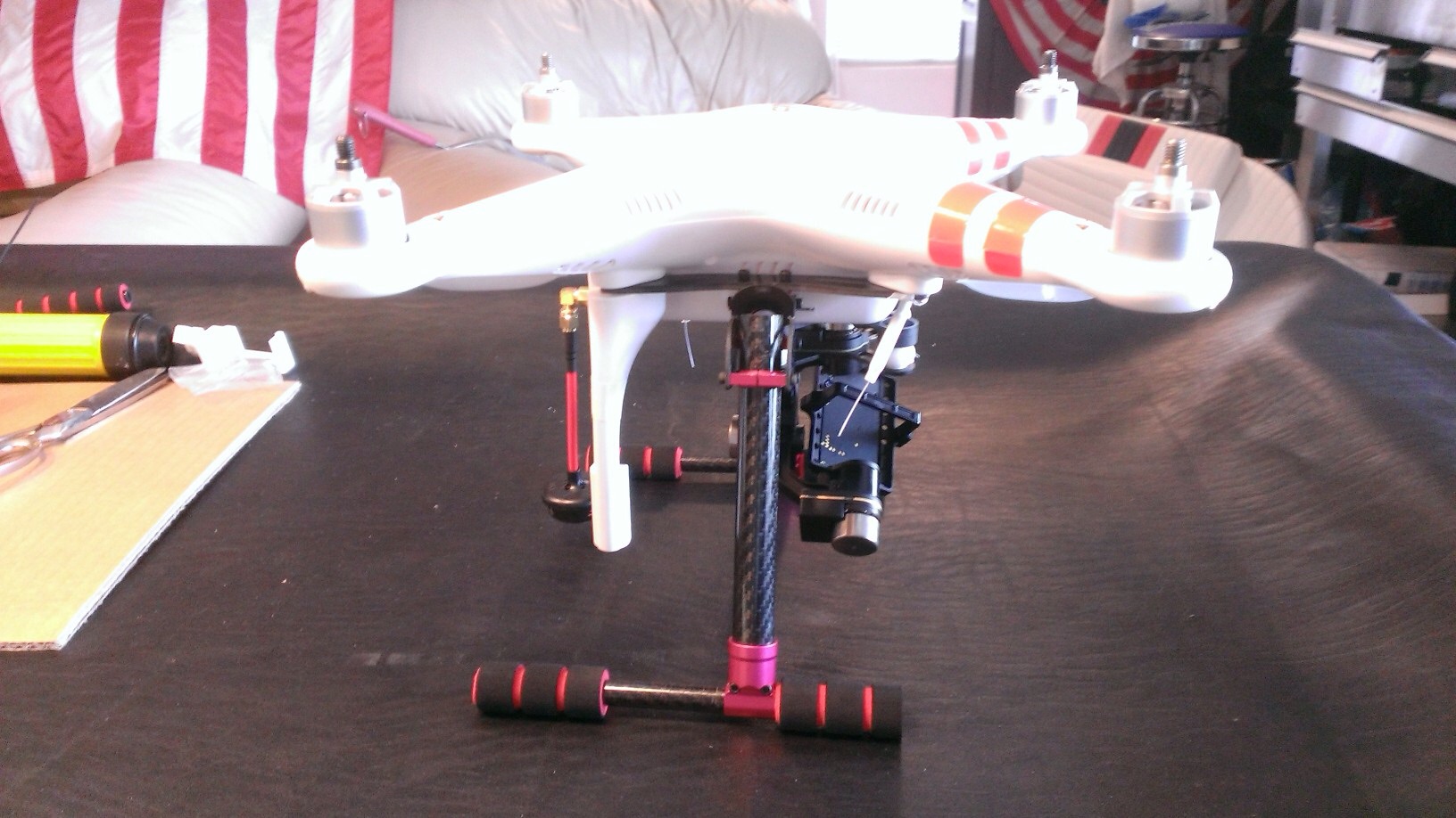

    Guys, here is how I dealt with the issue on my V2. I have not seen any after market legs that had the compass. The "other wire" (canbus) is now inside connected to the iosd.

    hey Marlin,
    That's a great solution buddy.
    to the best of my knowledge no one makes after market legs with a compass included. Your setup is simple and works as it was intended.

  9. Marlin009
    Dec 31, 2014
    1,089
    512
    West Coast of Florida
    Thanks. You just need two slightly longer screws for the compass leg.
    Pretty easy hack.
  10. yo-dude
    Oct 21, 2015
    30
    2
    Looks great! I attached reatractable and I keepgetting severe, crash inducing drift. Where did you get the black legs?
