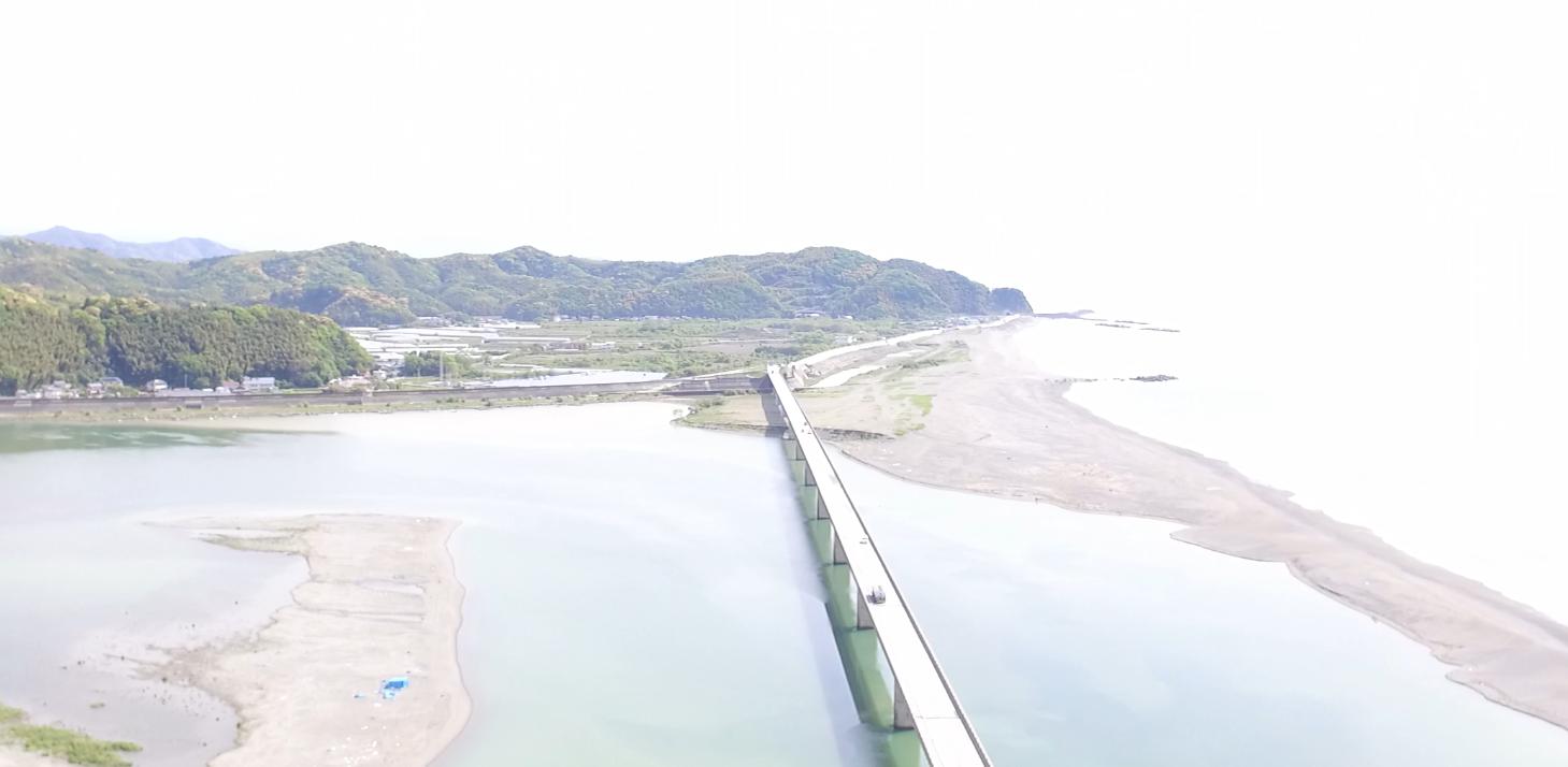

NotThat's not a white balance issue that's an issue with exposure, is this in video and still or just one?
No filter at all.Are you using filters of any kind?
I'd check histogram by LITCHI.That's not a white balance issue that's an issue with exposure, is this in video and still or just one?
If the histogram is to the right then this would also suggest its overexposed, are the camera/video settings set to auto? It could be that whilst flying you touched the screen where the foreground is by mistake and its exposed for that.I'd check histogram by LITCHI.
The graph comes to have very high right side
Sorry not good at English.If the histogram is to the right then this would also suggest its overexposed, are the camera/video settings set to auto? It could be that whilst flying you touched the screen where the foreground is by mistake and its exposed for that.
Thanks.If the camera is set to auto and you touch your iPad/iPhone/tablet screen in an area with no buttons the camera will change the exposure for that area, if that area was darker than the sky then it will make the sky look over exposed.
View attachment 51516 Suddenly white balance has been out of order.
There was not a problem at all till then.
Currently I cannot completely adjust it manual nor auto.
Any help,suggestion.Please.

The cause was unclear, but was cured all too soon when I repeated reset.
