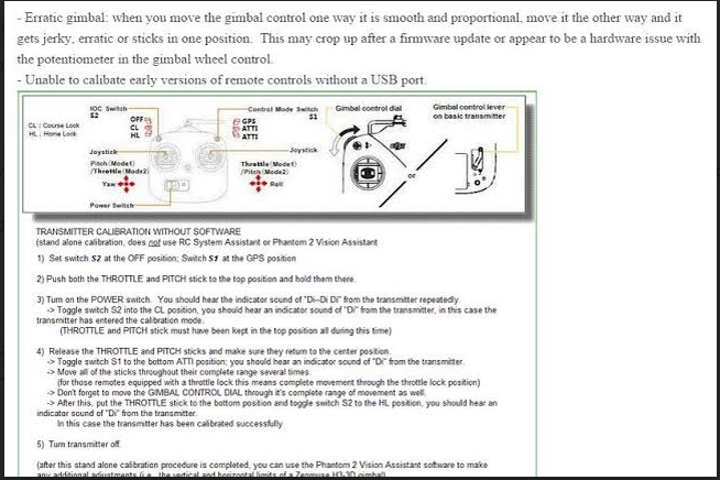

    So, I'm still stuck. I uninstalled and reinstalled my DJI app. I switched back to Phantom mode from NAZA. No change. When I'm in the upgrade transmitter version, the camera jumps to the full up position and does not respond to the wheel controller. Works fine on screen controls when in basic transmitter mode, but the wheel is useless.
    This worked for me:
