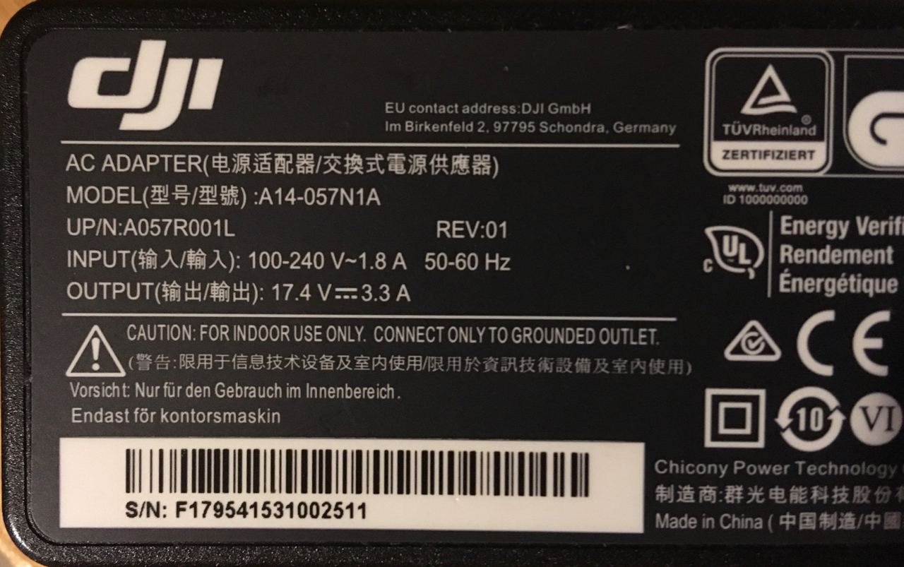

Well I sold a P3P & gave the new owner my charger.. Purchased a replacement on ebay & it came, but only charges battery..NOT THE CHARGER.( I should have closely checked the item description picture). So I need DJI ORIGINAL PART NUMBER. I'll be refuting the seller as they've stated this is DJI item.
Has ANYONE ever purchased a Phantom that came with a charger for AC Battery Only? No big deal but I sometimes have to enlighten sellers on e bay as to the goods being sold..
Thank you for any help.

Sounds like you have a charger for P3 Standard ....which has only lead for AC battery.
Model A14-057N1
Output 17.4V @ 3.3A
The Adv and Pro chargers have the dual output ... Ac Battery and Controller.
Model ADE019
Output 17.5V @ 5.7A

@Steve7777 Thank you for that, I think I might have asked my question another way, not asking for a part number, skirting your "how to search on forum" lesson answer...Pilot forum member @solentlife, once again has figured out what I really wanted to know, he's good at that. lol I should have asked. (What charger is this?) Bam.....
"Sounds like you have a charger for P3 Standard ....which has only lead for AC battery", I'll bet you would have followed that with, "The part you need is Part # 15" has lead for both AC & RC..
Merely trying to cover my a** now, after not doing my homework scrutinizing the items picture, as the description clearly states "Part 15"........ Can I now be assured the seller has not sold me a Part 15,? but merely something similar & not fitting the "item description" for P3P.... When I need Model ADE019
Thank you all for your replies, I must have been tired. Like measure twice & cut once hey.?

So now after checking the model number on the charger I purchased, it is clearly marked as a ADE019 incorrect number for the 1 lead AC only item.
Oct 14, 2016
3,668
1,573
63
UK Brit living Latvia
Interesting that Pro charger ID used on standard charger.
Regarding other - the Adv uses the low wattage Standard charger but fitted with dual output ..... note the 3.3A instead of Pro 5.7A
