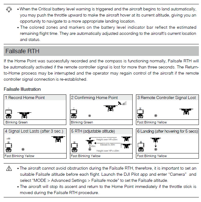

Here is what the manual says Pg 13:

A low battery RTH can be cancelled simply by pressing the RTH button, a failsafe RTH (critical low battery or LOS) cannot be cancelled and you only have limited control, such as shifting laterally a bit to select a better landing spot. Indoors just set RTH height to 'Zero' and this will have the effect of turning it off. You need to practice this a few times as when it is needed you might not have the time to 'think' about it before you hit that overhead obstruction. Your best defense is to just keep aware of your battery condition at all times, I look at mine every few seconds.

F6, a critical low battery will cause the aircraft to descend where it is at that point. There is no RTH once it's gone critical, it's coming down. However you can maintain altitude briefly by going full up on the throttle while positioning for a landing spot. Critical low battery and Failsafe RTH are two separate events. Failsafe RTH can be canceled once the Tx link is reconnected by pressing the RTH button. See page 14 and be careful not to touch the throttle in Failsafe RTH if you are flying below the highest object in your RTH path.
I know this as I to can read the manual, hence the 'lateral shift to pick a landing spot' Anyone who has read the manual knows that a critical low battery results in an immediate landing. I should not have lumped in the Failsafe as that is mainly for LOS, and yes, it can be cancelled.
I know what you meant. I was just trying to dumb it down for any new flyers who might be confused by the different RTH scenarios, hence posting the manual.
