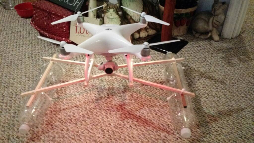

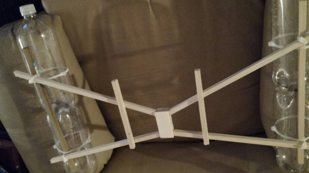

    For people that just can't afford a professional set of floats, Here's what I came up with for less than $5.
    I used the wood just as a template to get the balance right. Took 3 different tries with the wood and the bottles. But I also kept in mind keeping the whole setup out of frame, and prop wash. Even when you point the camera straight down it don't show up... Finally, success. And, it don't interfere with the downward facing sensors.
    I'm going to take that template and build it from aluminum rod, or perhaps graphite. I can get the rod at my hardware store for about $5 a stick, taking just over 1 to build.
    Those bottles.. super floatation. Maybe 1" in the water if that much. Super stable. Had to offset a little off center to balance because the weight of the battery. You don't realize it's heavier in the back until you center it directly, then put it in water. Notice how the striders back legs are positioned.
    Even though I used hot glue on this template, I was completely surprised how strong that stuff is. And yes, I did test this. Very stable.
    Easy installation.. 4 cable ties to the legs of the phantom and your off.
    Sent from my XT1585 using PhantomPilots mobile app
    Yes they slow the phantom down, but any other floatation will too. The results are the same and this really don't weigh much. Don't have a gram scale so I don't know exactly.. but do know the bird still fly's like it should. Not as attractive but get the same results as the rest. Take off and landing is simple. When I can, I will make a short vid and post.
