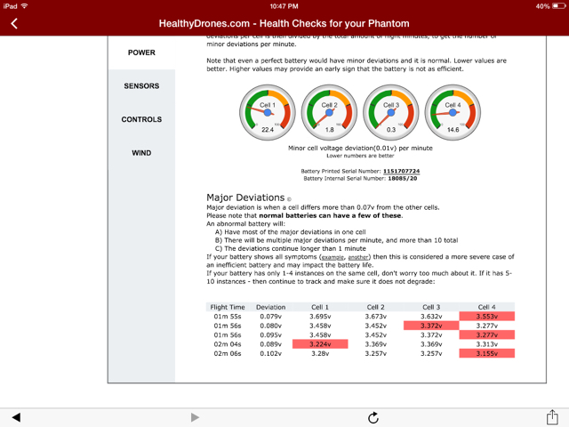

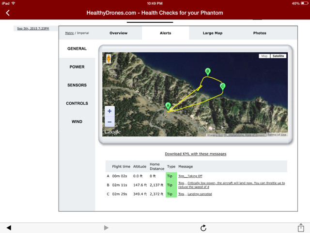

Can you guys see this? I dont know how to read these logs. Please help.
You have some strange readings on cells one and four ( Low) especially for only two minutes of flight time.

2 minutes and 11 seconds you show critical battery power. I definitely would not trust this battery. Everything else looks fine from what I can tell.
I also noticed on your second video of the app. That as it went into a spin you it went into Atti mode and came out and then went into landing mode followed by P-GPS

You have some strange readings on cells one and four ( Low) especially for only two minutes of flight time. View attachment 30101 View attachment 30102
And the compass turn rate is all jacked up, possibly a bird strike/ compass issue.
