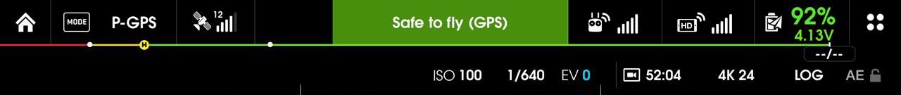

it's showing the lowest cell voltageView attachment 23014 The optional Voltage Display below the Battery Percentage in the upper right of the iOS Pilot app appears to be missing its leading digit of 1. Can be confusing at voltages above 10.0 Volts!
It is a 4 cell battery, you use the voltage display to monitor the individual cells' voltage. If one cell's voltage drops significantly below the other 3, it can be a sign that a cell has been damaged and that battery is not safe to fly with. You never want any of your cells to go below a certain voltage (I have heard 3.3V is the absolute minimum). Going below that will likely cause permanent damage to the cell and your battery will not work properly.Thanks for the clarifications! Is it a 4 cell battery?
What are acceptable values, and how do you use that lowest cell voltage display during flight to help in monitoring the displayed remaing battery percentage?
Some people set one of the custom buttons to quickly show the battery info screen. I haven't set a button myself, but I check the battery info screen as part of my pre flight checks.Thanks for the reply. Since the display only shows the lowest cell value, how do you know it is significantly below the other three, if it is, without looking at all four during flight, which isn't displayed on the main screen?
