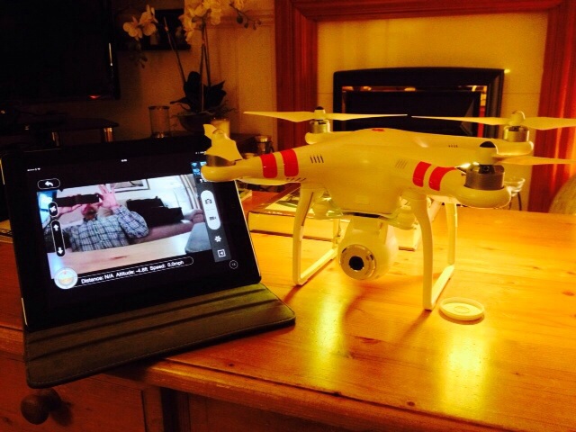

    No Vision lag and connected to ipad! Now to sort out how to carry this around my neck!
