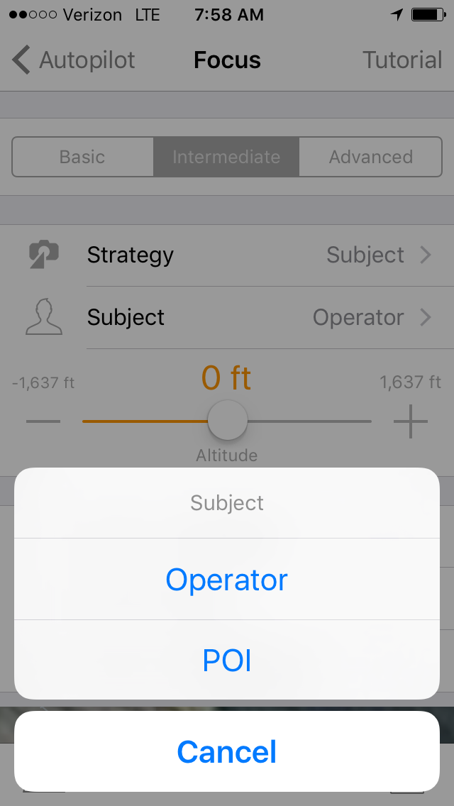

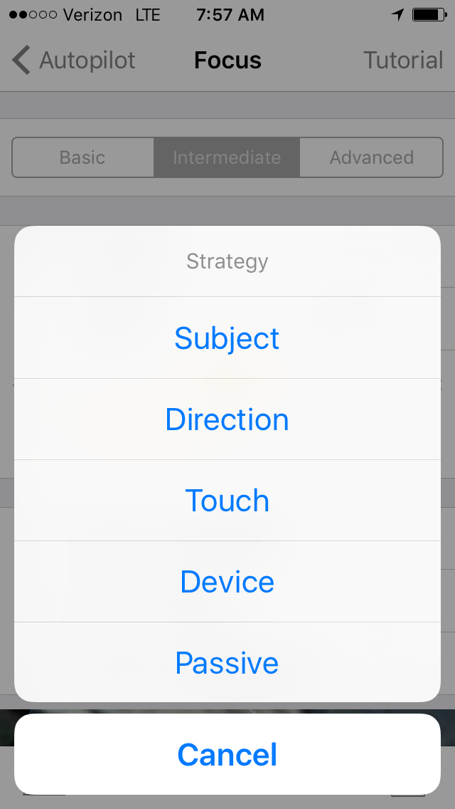

    You may have your focus strategy selected for "device" and not subject or something else which is why the camera was pointed at you. As for video I have seen my iPad mini 2 screen get pixelated but it's only for a few seconds. But when viewed on my computer using sd card the video was perfect. I have same setup you have. P3A, autopilot and IPad mini 2 w/cellular

    Do you not have these menus? Maybe you need to play with the focus strategy in real time but you shouldn't have too. Try using target mode and using Mark as your focus point. Autopilot is very technical IMO but very worth while. As I feel confident using it I still refer to the videos and manual with every flight 9 times out of 10

    Thanks so much! I figured it out. I was in "basic" mode, and needed to be in one of the two more advanced modes to get the required settings.
