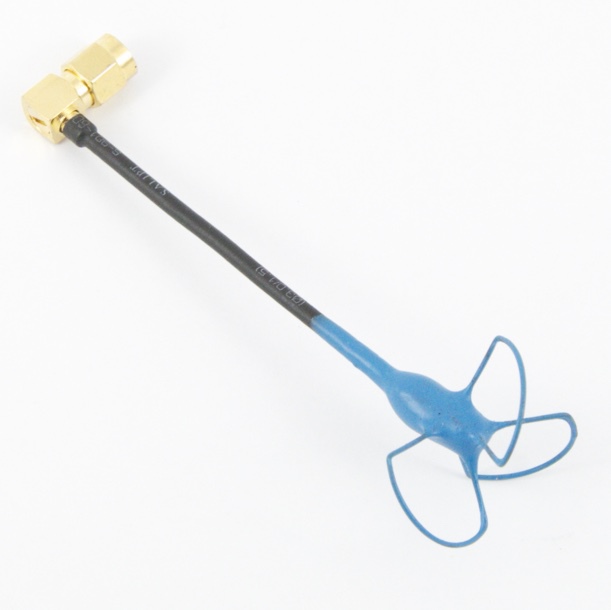

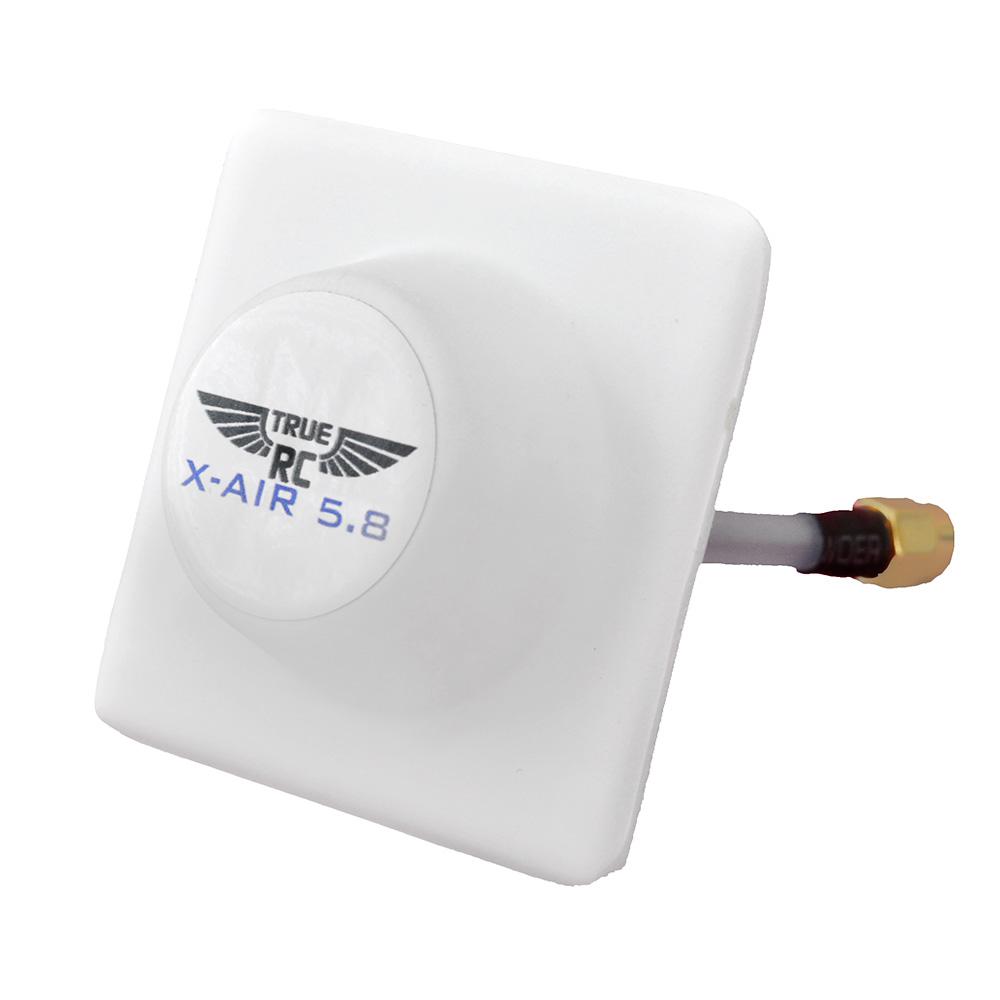

    Hey, I have a PT2 v.2.0 and I get 1500 meters easy (5000 feet).
    And I was bummed. I wished I was getting 3000 meters (10,000) or more.
    I was going to upgrade to a PT3, but now I am thinking twice.
    I am using 600mw IMR TX on the craft with an IBcrazy Air Screw (cloverleaf ant.) for the TX antenna,,, and I have FatShark goggles with a 'True RC Crosshair' for the RX.
    I think it is one of the best combo's out there.
    IBcrazy is now called VAS (video aerial systems) so you will find it under both names online. I guess they are having second thoughts about changing the company name, % )
    here is a pic of the 'AirScrew'
    AND Here is a pic of the 'Crosshair',,,,,,,,,,,,
