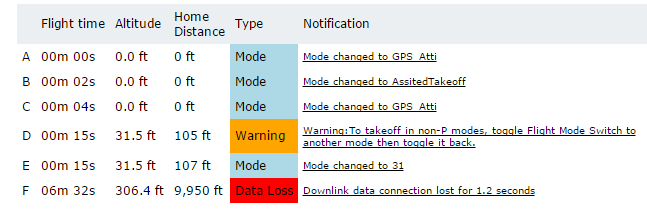

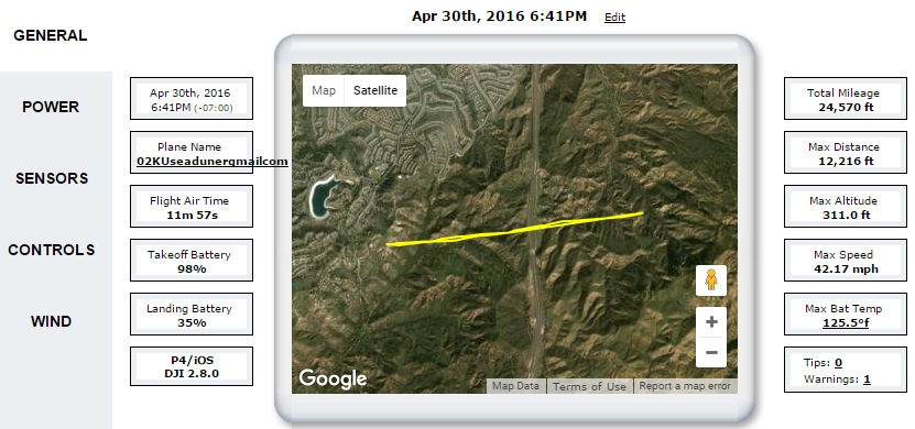

    So I flew my P4 this afternoon after work using an Inspire GL658A controller, latest firmware on both craft and RC, 4mbps transmission quality, channel 31. I only did one flight, it was getting dark, but all went well. Without my windsurfer installed, I went out to 4800' where I first started to lose bars. I had clear LOS in the hills. Then at around 5000' it lost video signal, however I was about 100' above high tension power lines, not sure how much the wires affected the connection. BUT..... I didn't lose control signal ! I simply ascended and my video came back. That's what I was hoping for, so I'm stoked. With my GL300C controller I would have lost control signal at the same time as I lose video signal, and it would have been at around 3000'. I would usually get a message of SIGNAL LOST (or something to that affect) which triggers RTH. In that case I can't ascend to my video back, like I can with my P3P. This flight I got the message "Weak Signal" as a warning, which is what I'm use to seeing with my P3P. Next flight I'll use windsurfer to see what happens. I expect to easily get to 3mi, more reliably than I have before. I'm thinking the Inspire RC may be the hot ticket, anyway I'm hoping so.
    For weeks I've been using my old P3 for important shoots because I know it will perform. I working on this to get confidence in the P4 in the same way. I also ordered the Itelite antenna from Maxx, it's in transit.

    Do you have the Inspire RC and P4 loaded with the latest firmware? What model Inspire RC do you have? GL658A? Do you have your transmission quality set to 4mbps? That's important.
    Today I took my P4 out again with my Inspire GL658A RC with NO WINDSURFER, stock antennas. I was in the hills where there was no wifi interference, clear line of sight, on Ch 31 and running 4mbps transmission quality. I went 12,200' and never lost a bar, however the report below says I lost datalink for a second at 9950' distance. I never saw a glitch while flying, never lost video or control. So tomorrow I'm going to go farther to see what the limit is again. I'm blown away that I got 12000' without my windsurfer. I'm pretty happy about that, it feels more like my P3P w/GL300A RC from a distance and signal integrity point of view.
