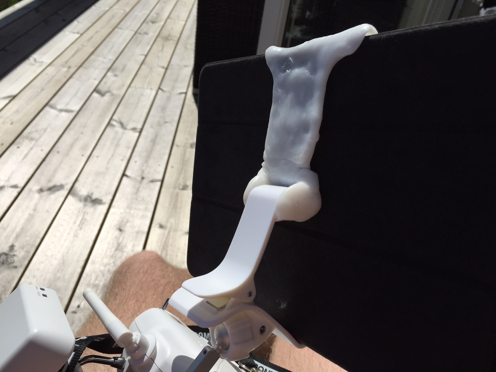

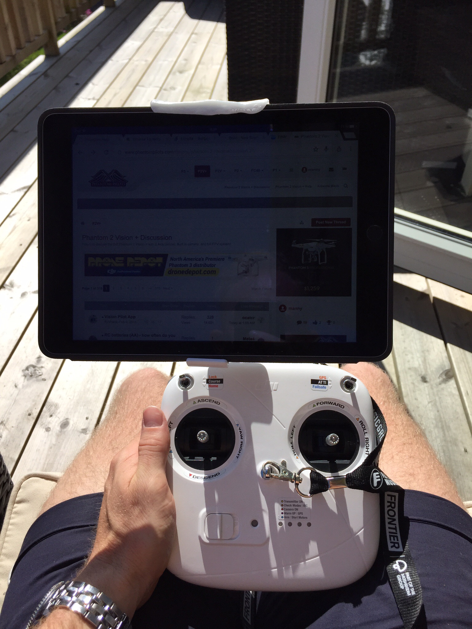

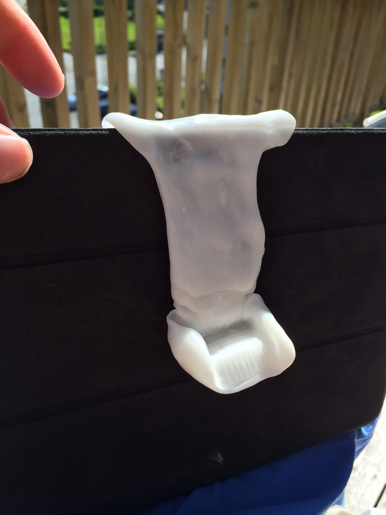

    I'm pretty happy with my solution for the ipad air 2 as well, without any Velcro or modification of the original holder. I wanted to be able to use the ipad without taking it out of the cover, and figured I'd have to diy it to get something I am happy with. 100% home made with nothing but hot water and polymorph plastic, cost price about a dollar or two!
