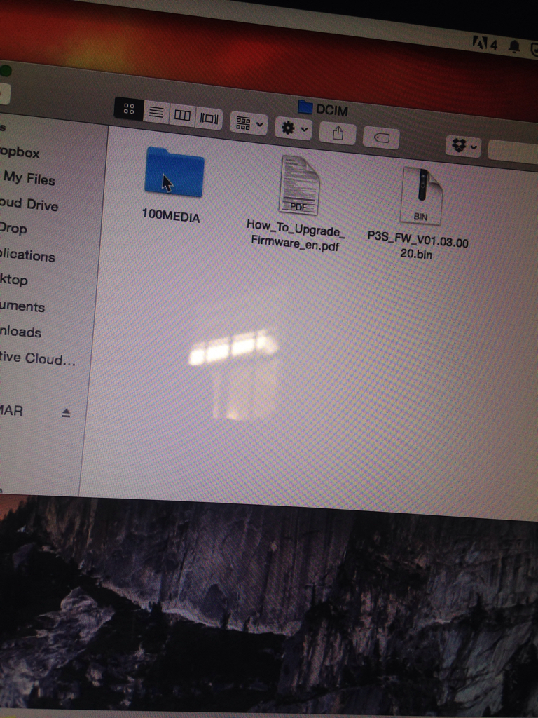

    Is this where the files should be then place in camera on drone ?

    If your updating it don't place the update in any files, a blank memory card works best, simply drag and drop.

    It looks like you have that in the "DCIM" folder. The BIN needs to be in the root -- which is one level up.
