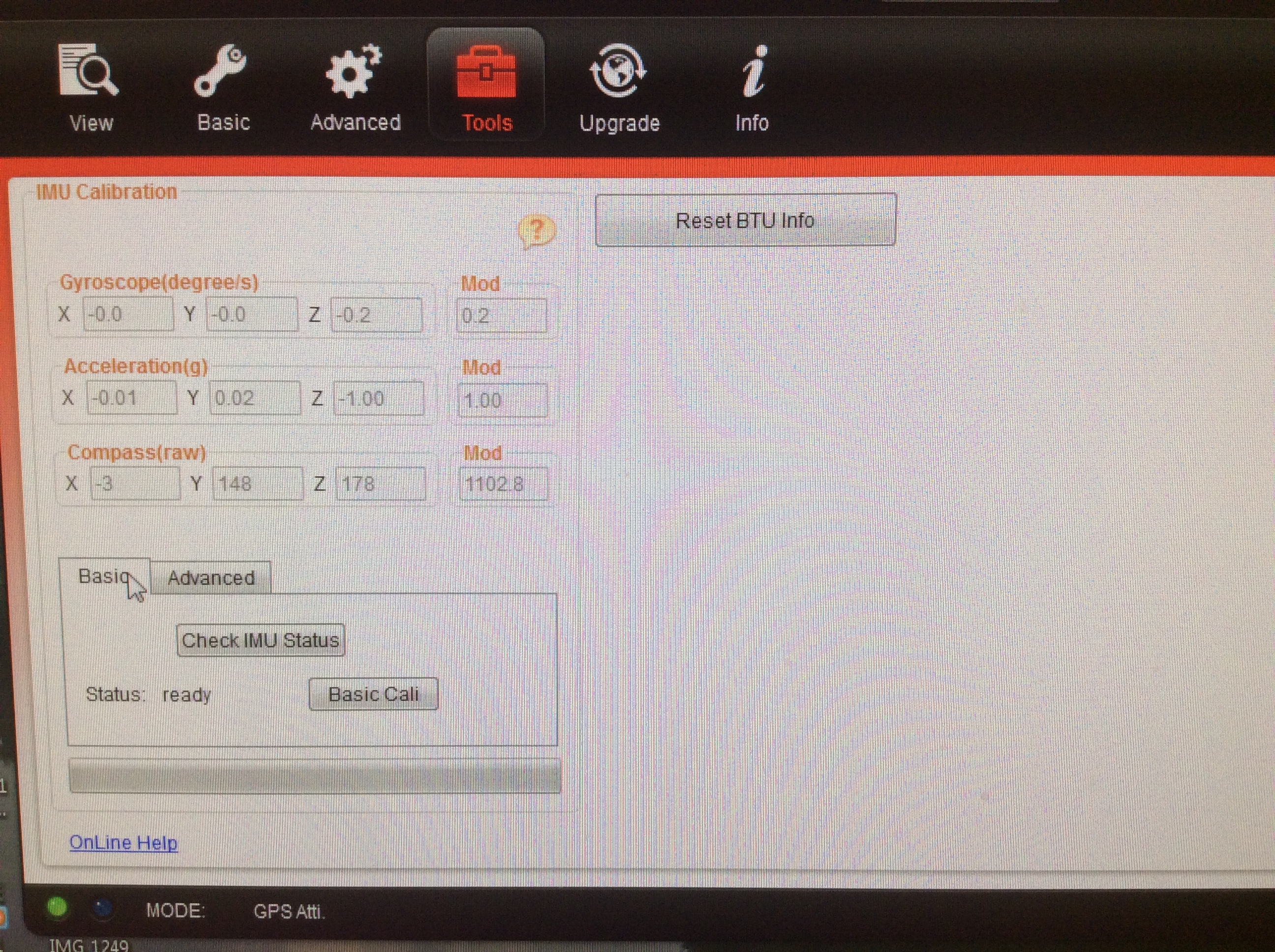

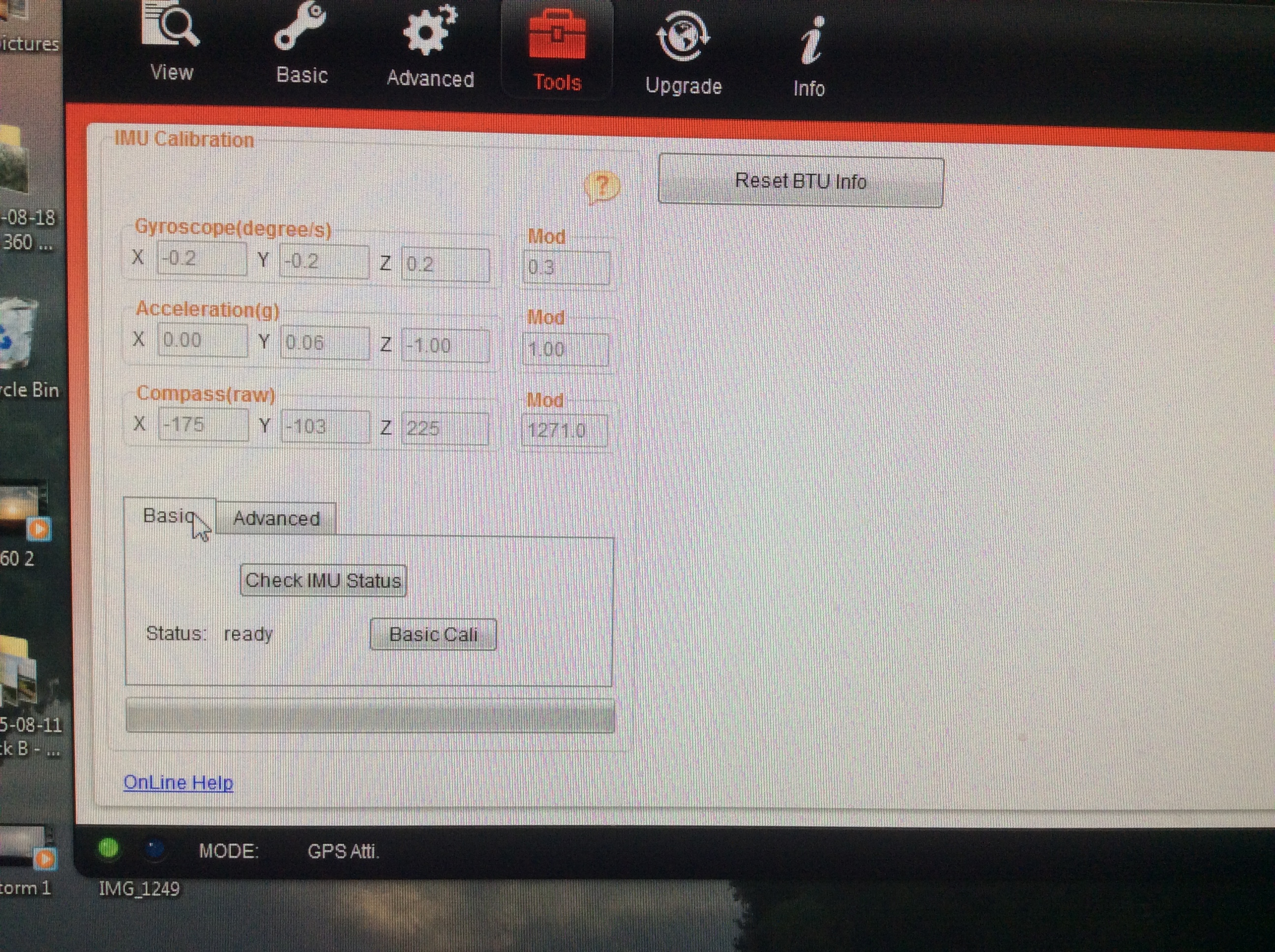

I just hooked mine up for a look and where I do all my assistant work I see this for my compass IMG_1281.JPG Then I moved the bird as far from my desk as I could and got this IMG_1282.JPG .Maybe the springs on the bed where I set it. .
I do know I had the lights like you when my compass was bad I just don't remember the beeps .
When I just had it hooked up and was moving it around I could see the compass values moving a lot .Maybe J Dot will see something .

I just hooked mine up for a look and where I do all my assistant work I see this for my compass View attachment 29315 Then I moved the bird as far from my desk as I could and got this View attachment 29316 .Maybe the springs on the bed where I set it. .
I still think it's something up with the compass bro and J Dot most likely at work but sure he will look in later .
I thought this screen was unusual. Upper left corner. I was indoors and had not set the compass. Maybe Try outside and set the compass to see if Assistant shows it. I guess I should sending thumbnails instead of full size pictures. Thanks again for your input.
