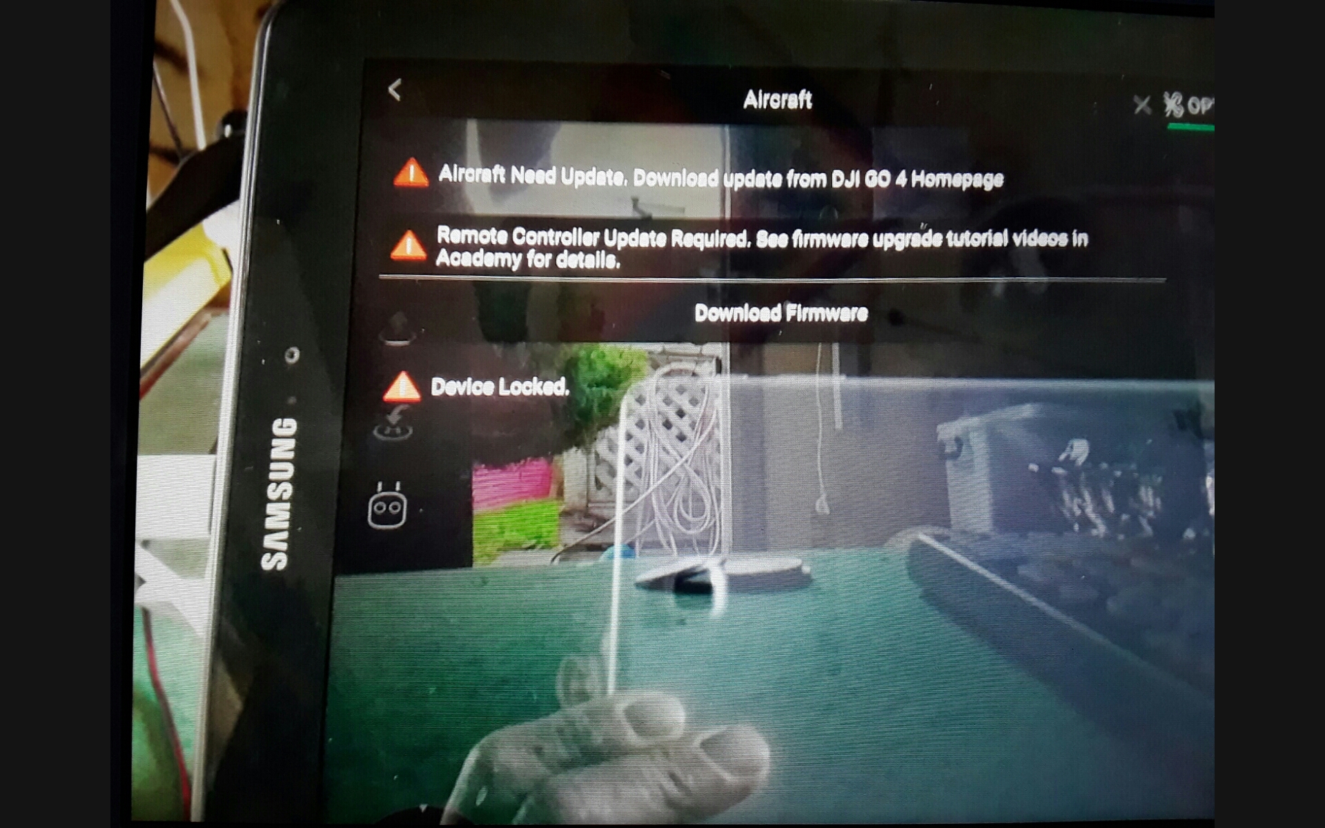

Was it still linked after that time limit,you can link without app ,what is hopping when linking does it time out,,,,firmware,,,yes optional but as one who has has locked craft because I never updated ,I update now..after that time limit you are bound to have firmware required prompt,,not sure if this corect but read somewhere here the app has got bit more to it now and device might not run it properly if at all,,here's my pic from locked craft,,if yours same you will have similar notice ,,,,so it does selectively select who ever,,!,,,,,ME,,,,,,as above try a manual link without the app conected

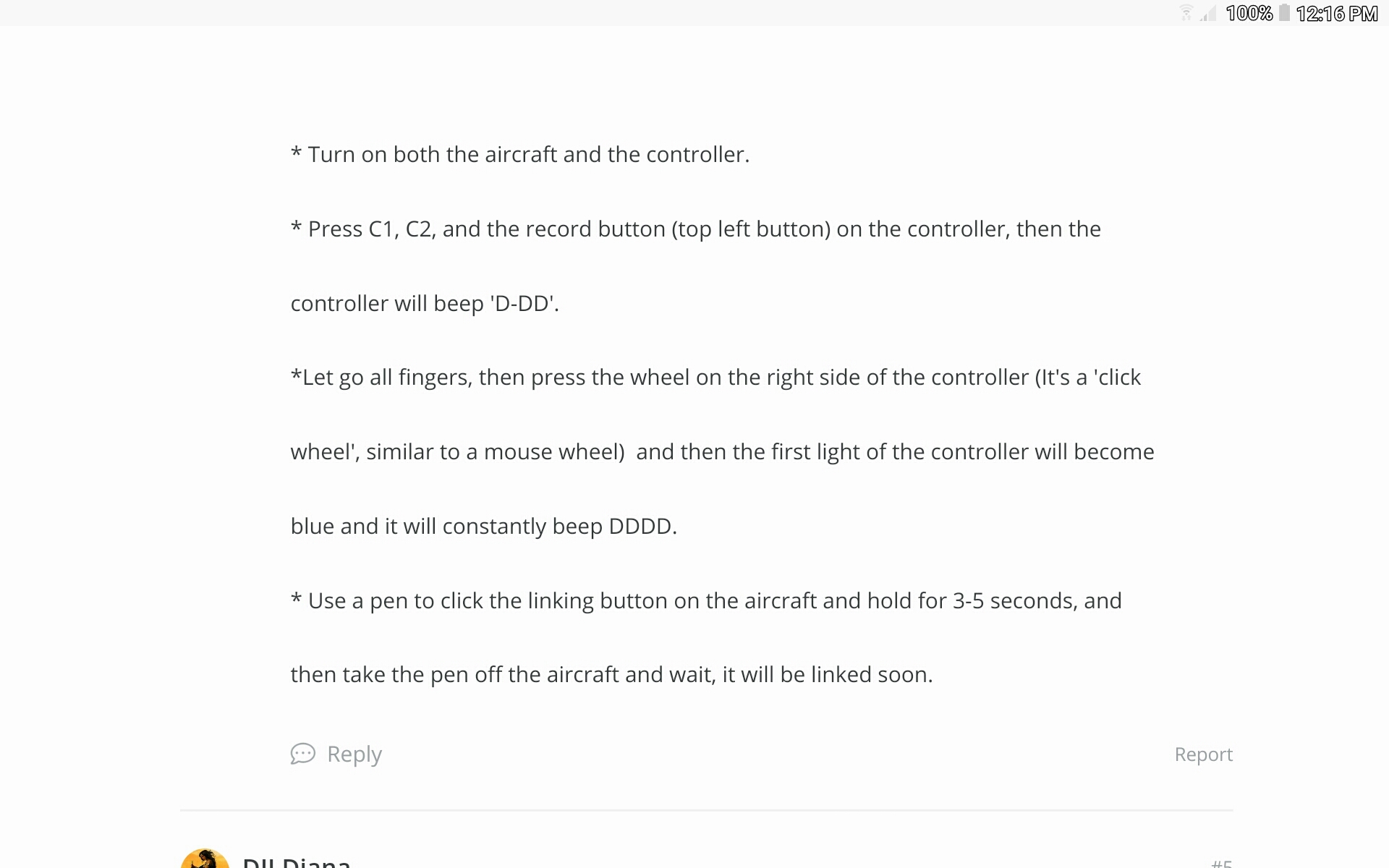

Manual link process
