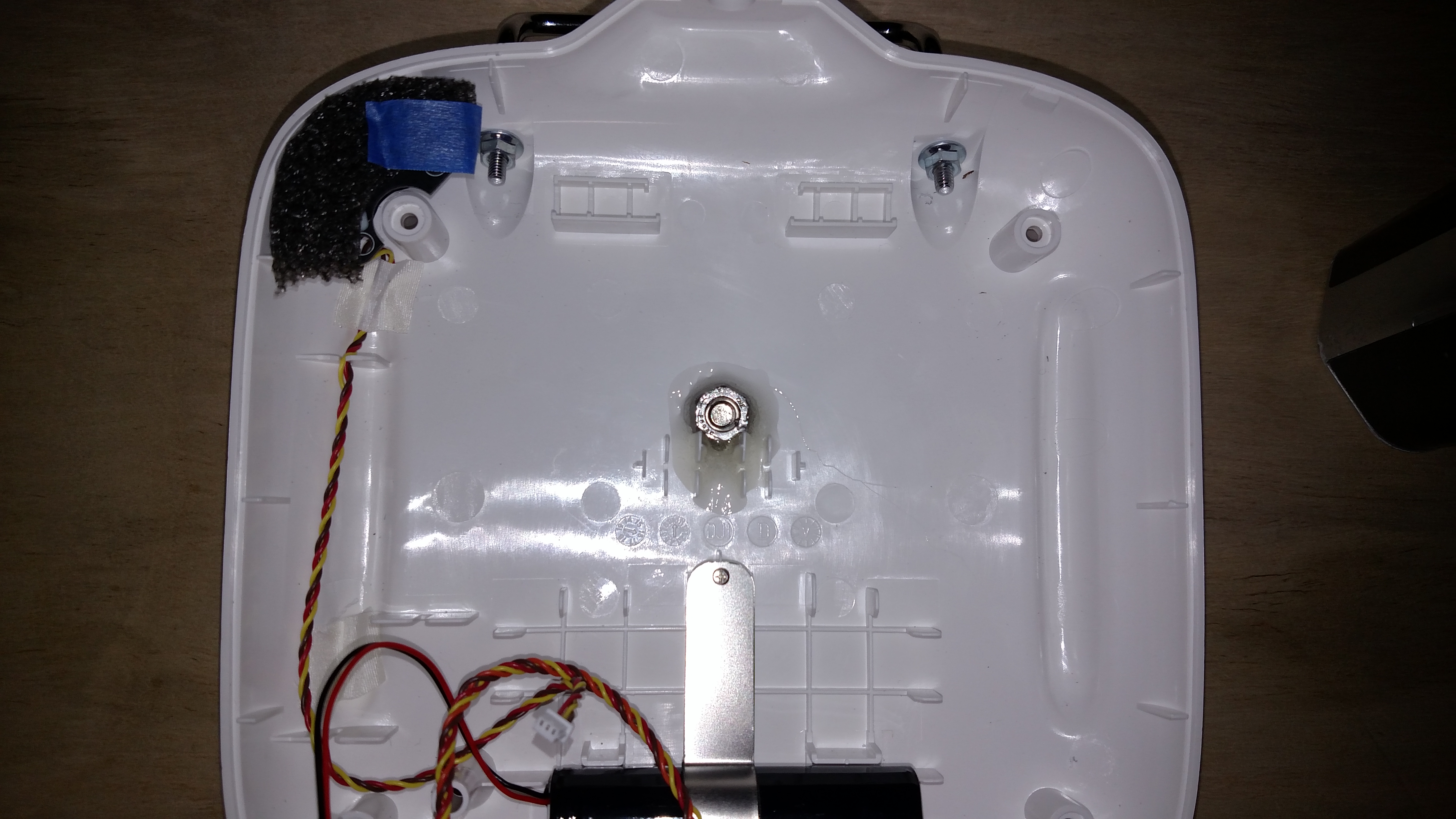

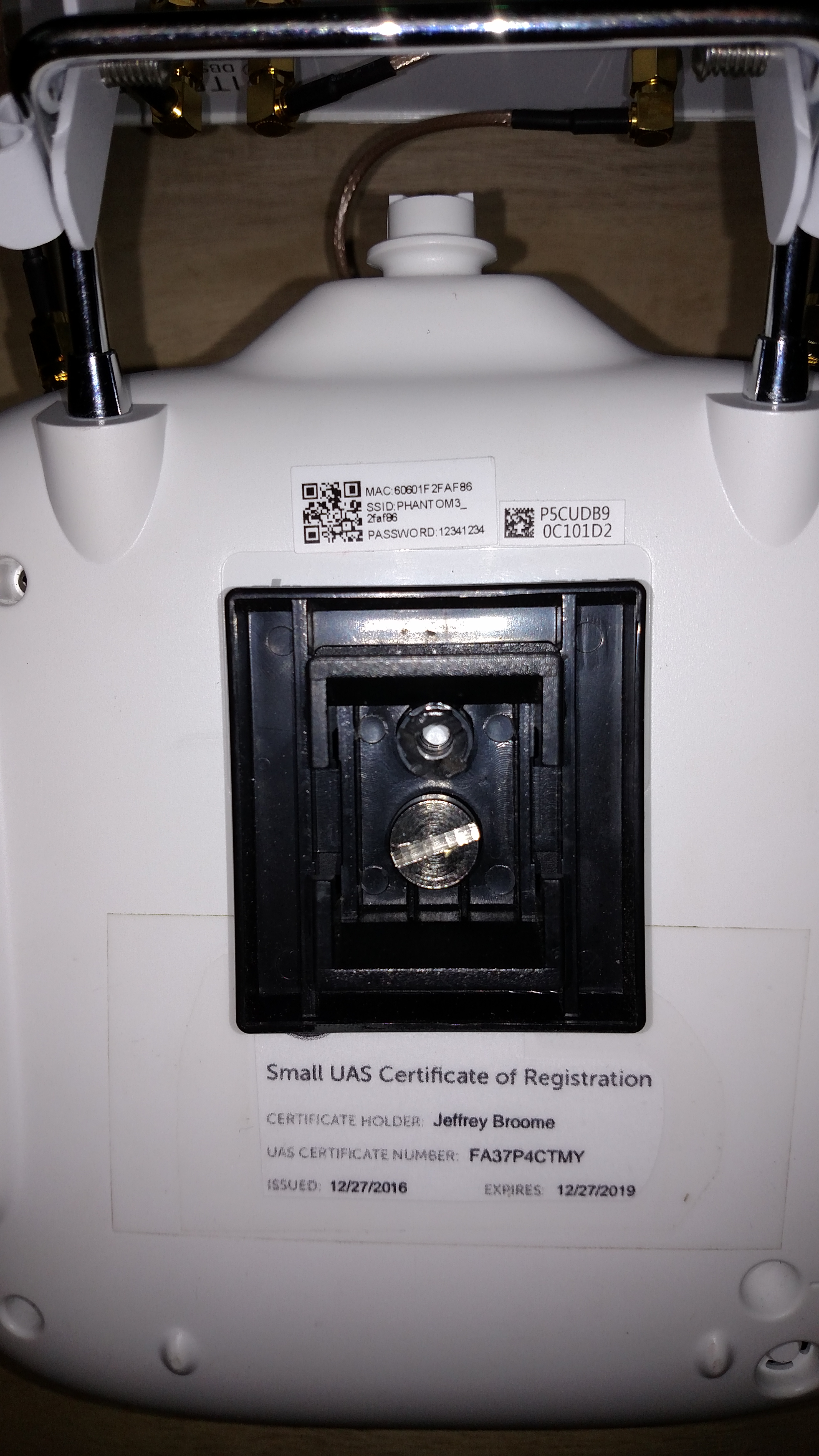

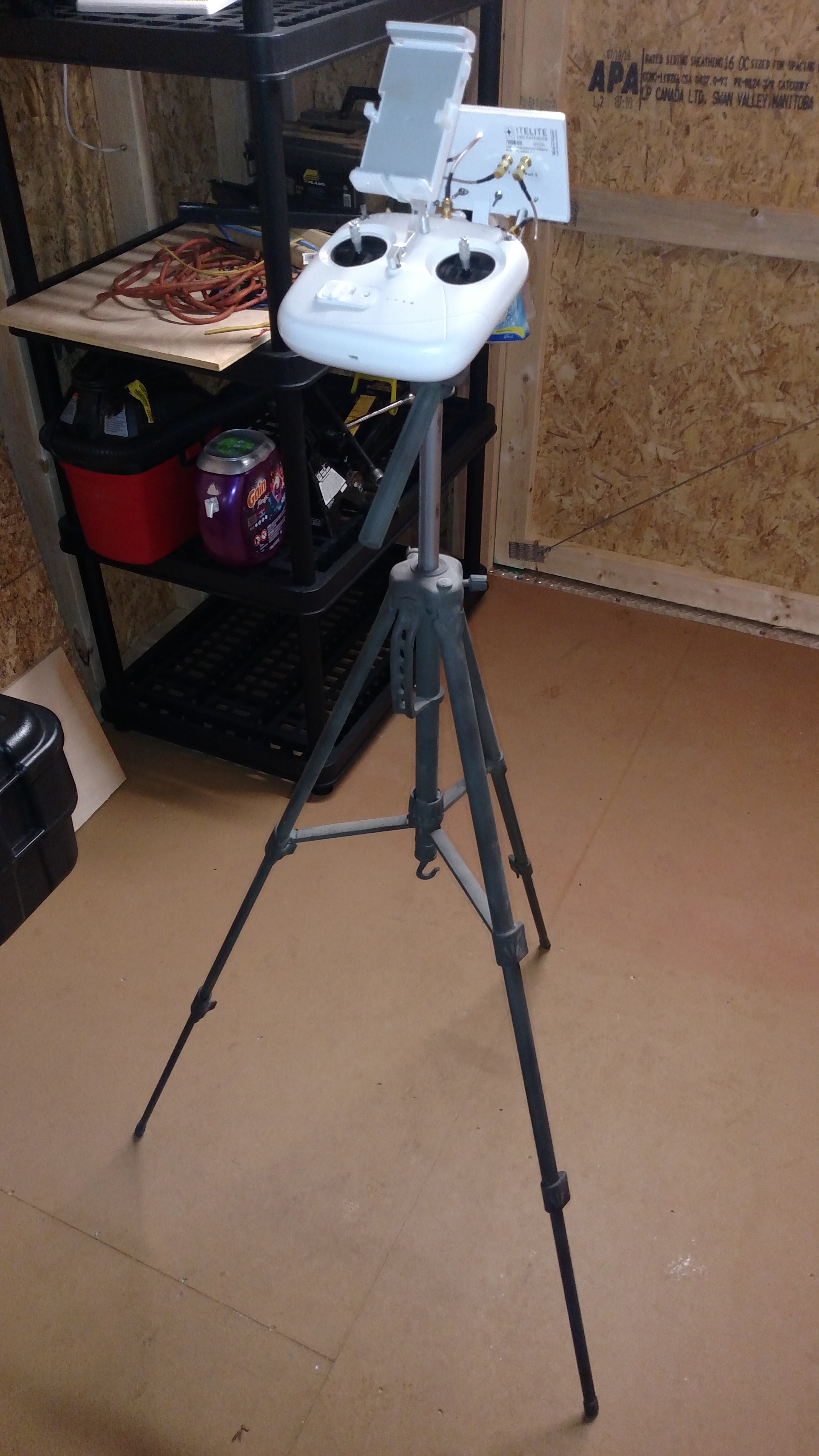

I've had this tripod sitting around for years and decided to put it to use. I grabbed a nut (lol) and roughed it up on the bench grinder (ouch!). Drilled a hole in the bottom of the RC and mixed up some Gorilla Epoxy. Seems to work great! Can't wait to see what steady rc control will do for distance!
