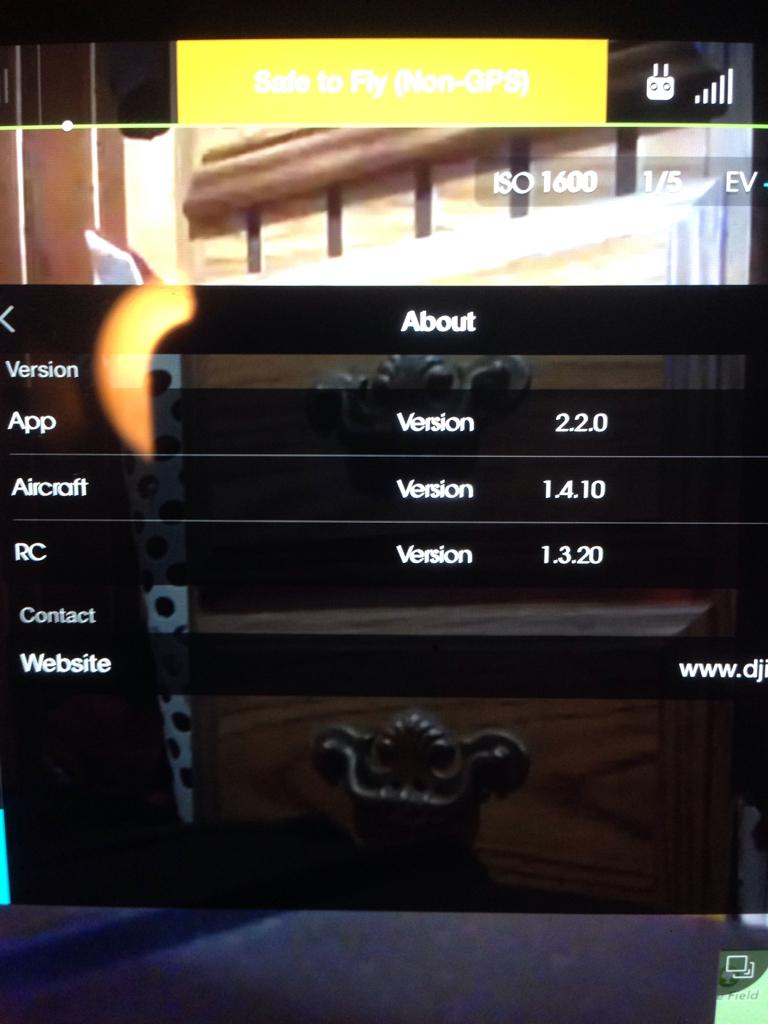

  6. brianb87
    Aug 21, 2015
    788
    148
    Everything look ok? I tried switching to f but it said I can't run multiple modes at the same time.
  7. Dronason
    Aug 9, 2015
    522
    87
    Switzerland
    From release note, the RC keep same version, so yes, it looks ok.

  9. Meta4
    Meta4 Moderator
    Staff Member
    Jan 8, 2014
    11,490
    5,933
    You can't access the multiple modes until you enable them in the app.
