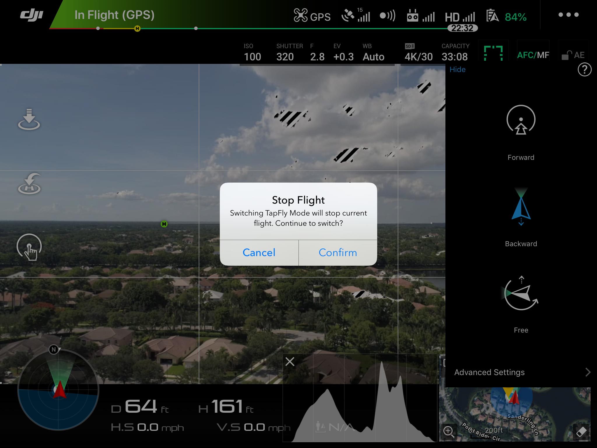

Thank you. I am attaching the screen shot so it is easier to understand my fear of crashing.

Wow I search the Internet for ages found nothing ,as normal it seems the dji app chucks out a new one (prompt or warning) without anyone knowing about it , autominus mind of its own,this is why I like to keep control,as barefootbeachcobing metion it's a message but why ??only interesting thing I find is if it gains height to avoid something it does not return to its previous height that was programmed,scary stuff,

Just means it will start a new trajectory. Should say “do you want to fly to a different place?” It’s not going to stop flying, it will just change its mission. Works good.

TapFly works nicely. It allows you to fly a course without over controlling your drone while filming video. You can dynamically change your course by re-tapping a new direction on your display. It's that simple. What you can't do is change from "forward" to "backward". That makes sense because in "forward" you are tapping an aim point on the video display toward which you want to fly. In "backward" mode you are tapping a point away from which you want to fly.
