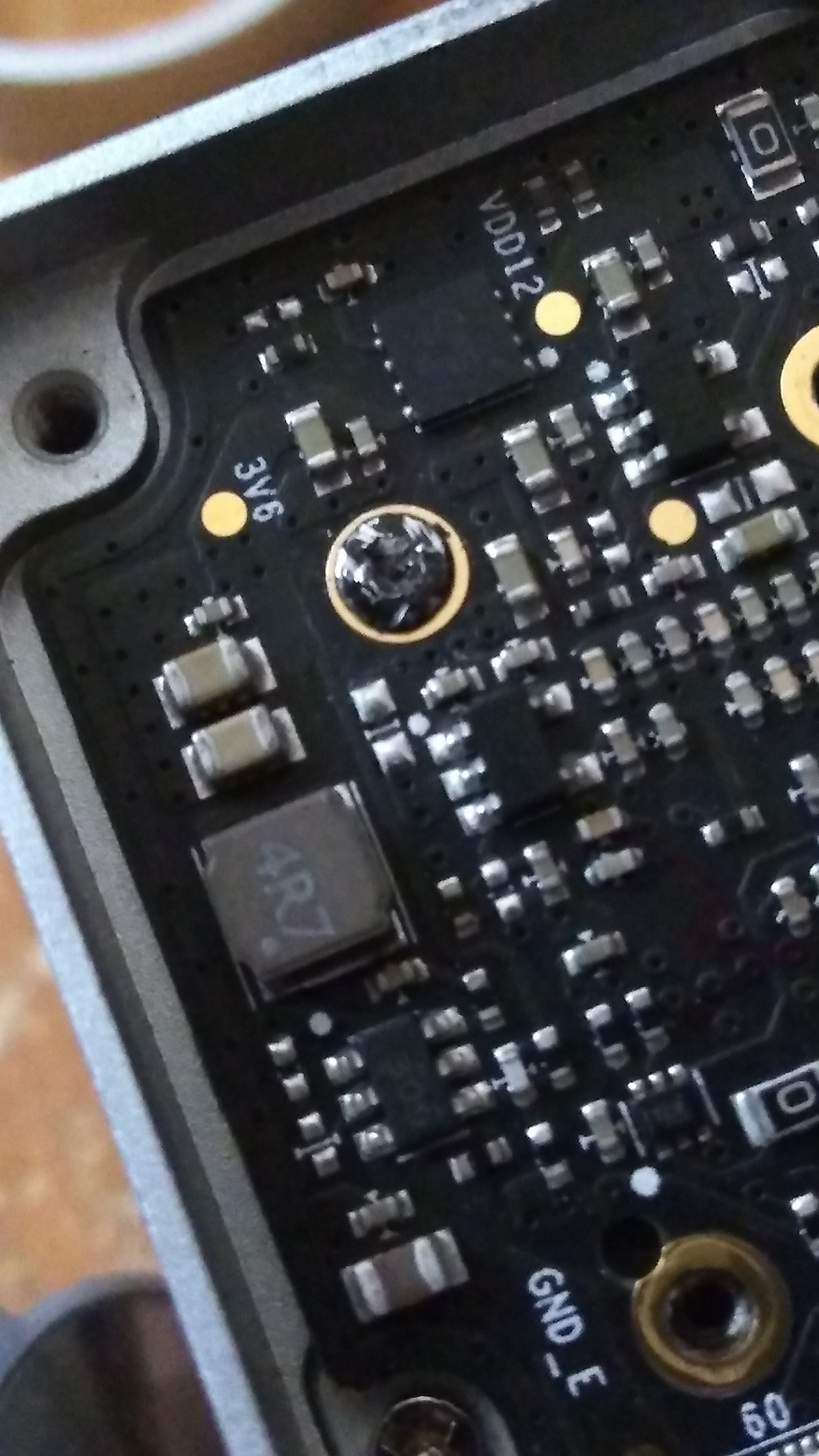

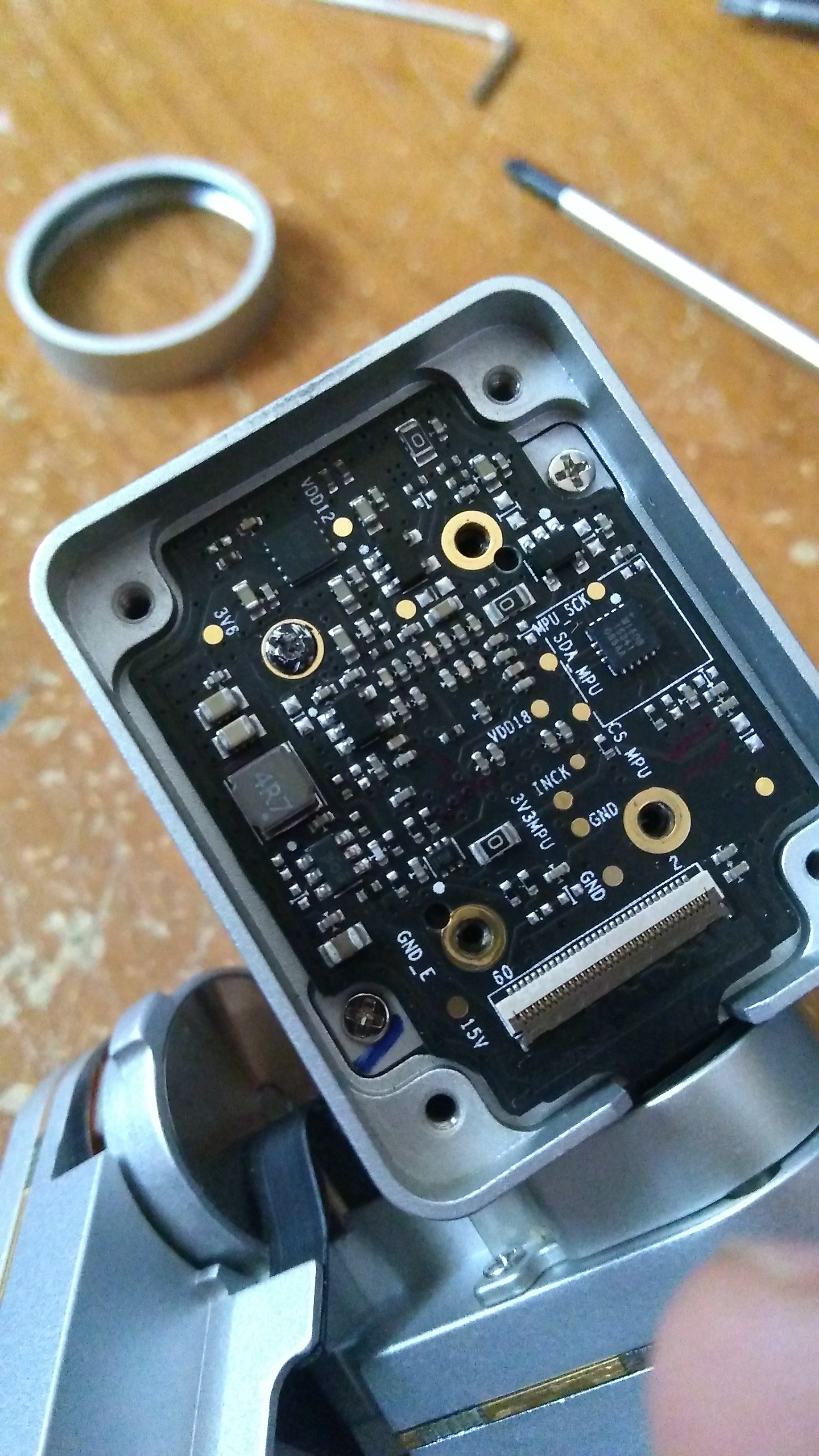

UpLift Aerial Joined Jan 1, 2017 Messages 1,343 Reaction score 342 Location New Brunswick, Canada Mar 3, 2018 #1 I'm a stupid idiot! I admit, I used the wrong size driver. Any ideas on how to remove it? Attachments IMG_20180303_122601731.jpg 1.8 MB · Views: 295 IMG_20180303_122714825.jpg 1.3 MB · Views: 292
ryantrax Approved Vendor Joined Jul 14, 2015 Messages 2,397 Reaction score 753 Location Franklin, Ohio Mar 3, 2018 #2 If you have a dremel with a cut-off wheel you can carefully carve a slot in the top and use a flat head screw driver. Just be careful not to hit the board. Reactions: Deleted member 62848

S Sixgun89 Joined Aug 17, 2017 Messages 104 Reaction score 48 Age 64 Mar 3, 2018 #3 Buy the ez-out extractor set at Sears or hardware store Works, but clean filings after!!
UpLift Aerial Joined Jan 1, 2017 Messages 1,343 Reaction score 342 Location New Brunswick, Canada Mar 3, 2018 #4 Thanks. I was thinking about a dremel but was scared to try. I will try though and let you know. if not I may get some ez-out's tools.
UpLift Aerial Joined Jan 1, 2017 Messages 1,343 Reaction score 342 Location New Brunswick, Canada Mar 3, 2018 #5 Its so small I don't know if I can use a dremel.
S Sixgun89 Joined Aug 17, 2017 Messages 104 Reaction score 48 Age 64 Mar 3, 2018 #6 U can use a cut off wheel and make a slot and remove that way. Try to avoid cutting off the head till last ditch fix
Monte55 Joined Apr 26, 2014 Messages 2,535 Reaction score 665 Location Raymore Missouri Mar 3, 2018 #7 A dab of ca on the tip of screwdriver...let it set up and unscrew.
