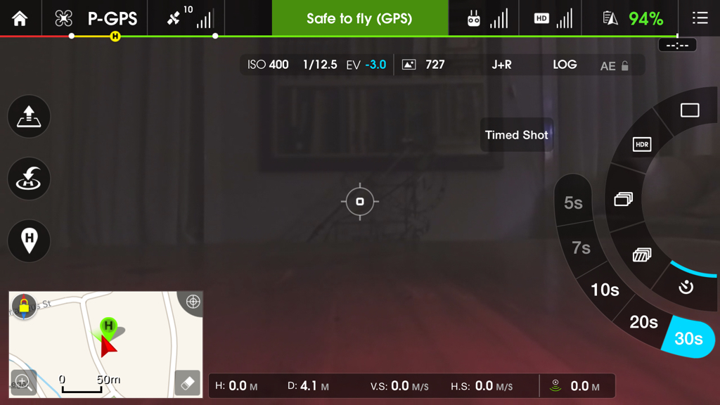

    So I'm not going mad. Since the new firmware update today I noticed that now the 5 & 7 sec options are greyed out and can't be selected. See image. No idea why this is but I'm still thinking it might have to do with the SD card speed.

  20. MarkEngland
    Jul 13, 2015
    75
    43
    Press and hold the shutter button when it's in photo mode.
