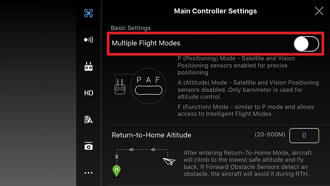

Did you enable Multiple Flight Modes in DJI GO? When that setting is disabled, flipping that switch won't do anything.

Sorry, unable to find multiple flight mode on my dji go app on the + model. Would you point me to the location? I appreciate your help.
