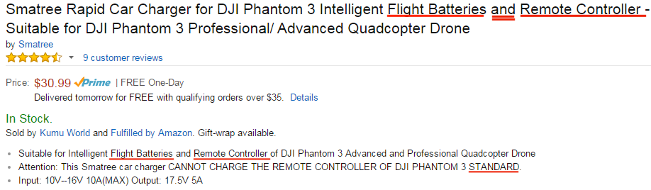

Smartree Car Charger .. YAY or NAY?!

    I use their stuff for gopro and i am very happy. however knowing how fragile dji batteries are, I wouldnt go for car charging since I have seen couple of test showing how voltage and amp fluctuates with car charges.

    Hmm .. yeah that's what I thought! That's always the warning when it comes to charging phones in the car! And they're not nearly as sensitive, yeah the dji batteries seem fussy enough ... might just stick with the charger out the box and put the 31$ towards a multi dji charger! Thanks for the response Mr.Goodkat!

    This Smatree charger will charge two types of devices, qualifying for multiple purposes :p. It looks like a good option at 89W. My 70W car cord charger works great, it's not DJI. However it doesn't have the right plug to charge the RC, so I like this Smatree charger idea. I use my car charger mostly in my RV where I have a cigarette lighter that's always on, unlike most cars today.
