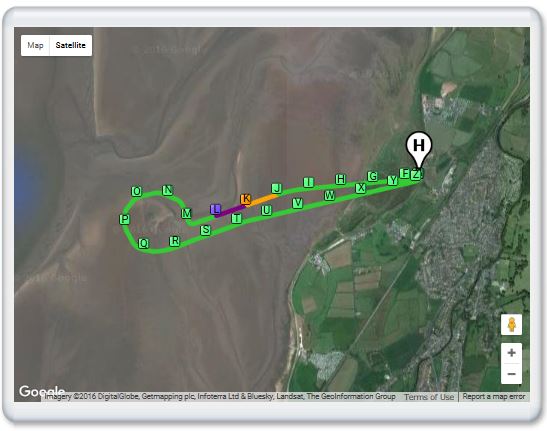

I just completed a 7500ft max distance from home point on a Litchi mission. At about 5000ft out I started getting a signal loss warning, but as it was on a mission it continued and did not initiate an RTH.
The signal was then restored to maximum bars and stayed this way all the way out to 7500ft and all the way back.
I am curious why this happens in a wide open area out over open sea. I do not fly long missions over land, and this was really just a long distance test to see how the aircraft performed. Any thoughts?

Yes possibly, but I was being very careful to point and angle the antenna corectly,obviously I could not see the craft but I was aiming for a small island exposed at low tide and did my best to line up with that point.

Antenna positioning is very important for long flights as the signal weakens and you need to collect whatever is directly directed towards it.

If you want to get serious about distance, you really need to get yourself a tripod. Or at least a table.

Hi thanks, how do you use the tripod? I assume it is to maintain steady direction of the antennae. Do I need an attachment.
Thanks to all other helpful suggestions,got my Parabolics on order.

Hi - I have a folding table set up in the back of my property which I use for my daily flights. I've got a block of wood on the table that I use to angle the controller at exactly the elevation I need.
But yes, I also have a tripod which I use at times. You'd need to mod your controller so that it fits on the tripod. There are a number of ways to do it. Here's how I did it: Tripod Mod

Thanks,just off out to repeat yesterdays mission and I will concentrate more on the antennae direction.

I had a similar situation and bought a pair of these and what a night and day difference. They help alot, I am now able to flight in places where I could not before.
https://www.amazon.com/gp/product/B01HW91PLE/ref=oh_aui_detailpage_o06_s00?ie=UTF8&psc=1
Coincidentally, they look exactly like the pair I ordered yesterday,folding and copper plated,they arrived today, so I re flew yesterdays mission and full strength signal all the way. Once again thanks to all who responded.
These folding Parabolic reflectors fit perfectly in my case alongside the gimbal.
