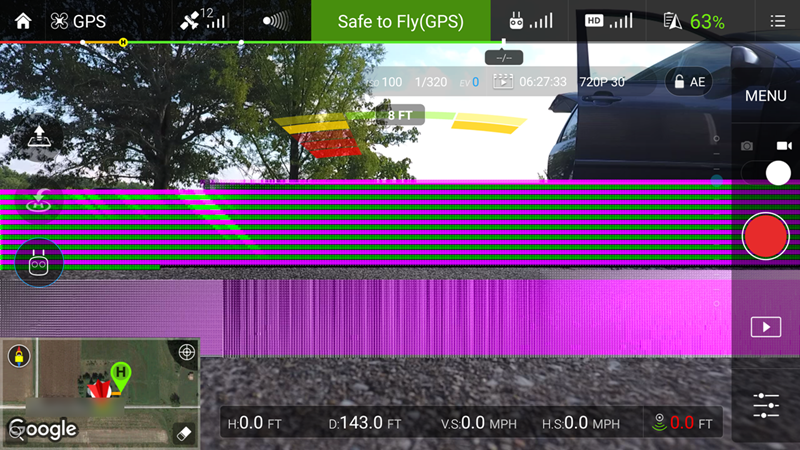

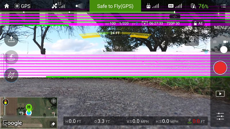

    I'm very commonly getting a phone display that looks like the following when operating the P4. It seems most common when on the ground and usually clears up when flying. However, it does sometimes occur when flying as well.
    The lines are not constant. They move around and change shape and color. They are mostly either green or magenta, though. I've never seen this when flying the P3. I updated the firmware and still have the same problem. It seems like signal interference or something.
    Has anybody ever seen this behavior before?

    Yes. I had that happen when I tried to use my trusty old iPad Mini for FPV. It just doesn't have the processing power to manage the video input from the Phantom 4. When I switched over to my iPhone 6, or my iPad Pro, it worked perfectly. You might also consider the quality of the USB cable that you're using to connect your mobile device to the R/C transmitter.

    Good ideas. I know the cable I'm using is almost brand new, but I'll test with a a different cable and see if that makes a difference. I'm using an LG G3, which I would think would be adequate given its other video capabilities. Does DJI publish minimum phone/tablet specs to use with the controller?

    ...Adam, indication of Interference, you may be able to change channel and it May Clear up.. use it as a Warning, again of High Interference in that particular area, I've seen it when i inadvertently attempted to take off from a spot that had high voltage cables under-ground...

    Your LG isn't powerful enough.
    Here is what is recommended by DJI on their P4 Specs page ( DJI Phantom 4 – Specs, FAQ, Tutorials and Downloads ):
    Recommended Devices:
    iOS: iPhone 5s, iPhone 6, iPhone 6 Plus, iPhone 6s, iPhone 6s Plus, iPod touch 6, iPad Pro, iPad Air, iPad Air Wi-Fi + Cellular, iPad mini 2, iPad mini 2 Wi-Fi + Cellular, iPad Air 2, iPad Air 2 Wi-Fi + Cellular, iPad mini 3, iPad mini 3 Wi-Fi + Cellular, iPad mini 4, and iPad mini 4 Wi-Fi + Cellular. This app is optimized for iPhone 5s, iPhone 6, iPhone 6 Plus, iPhone 6s and iPhone 6s Plus.
    Android: Samsung tabs 705c, Samsung S6, Samsung S5, Samsung NOTE4, Samsung NOTE3, Google Nexus 9, Google Nexus
    Personally, I'd get an approved iOS device. Preference would be iPad Air 2 + Cellualr, or iPadPro + Cellular (The cellular ones have the barometer and GPS which is helpful for some apps in Follow me up/down mode, etc.). Safer to buy the better one once than bad ones twice. Been there with Samsung (ugh!).

    Interesting. I've looked at side-by-side spec comparisons of the LG G3 and it outperforms quite a few of the devices listed by DJI--some by quite a bit. I know, of course, that the devil is in the details and there may be a number of significant differences in software, specific hardware, etc. that DJI has ignored (since they don't list a single LG device).
