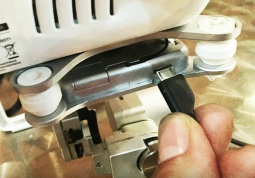

  9. AZWayfinding
    Jun 8, 2017
    5
    Scottsdale, AZ
    I took two wire zip ties and zip tied it into place. True I must now download using a usb cable but I don't have that problem anymore. - Jeff
  10. aburkefl
    May 18, 2015
    268
    57
    I got lost. I've always removed my SD card and used a card reader to get the data into my PC. If you have the SD card zip-tied into place and the other USB port (in the front, near the logo) is only to obtain one of those infamous .DAT files, where do you plug a USB cable?
    Art - N4PJ
    Leesburg, FL
  11. AZWayfinding
    Jun 8, 2017
    5
    Scottsdale, AZ
    There is a micoUSB port on the silver gimble area. It is on the opposite side of the SDcard port. Plug it in here and it comes up like any USB device. NOTE: I can't remember off the top of my head if you have to have your battery turned on.
  12. aburkefl
    May 18, 2015
    268
    57
    "Phantom Pilot found asleep at keyboard! Film at 11. LOL
    Been so long since I had done that - I had forgotten all about that other port.
    Art - N4PJ
    Leesburg, FL
