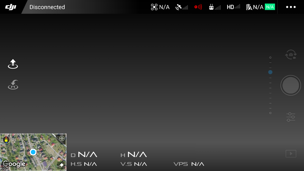

Just found out that the App switches back to Google maps if the "Storage" is disabled in the app permissions.

Anyone figure out how to get Google Maps back on the P4P+ Controller? ...Cause I can't seem to get to this "Apps Permissions" on the P4P+ Screen to disable the "Storage" ....Or does someone know of a better way to get Google Maps back?..
Thanks
Jan 1, 2016
166
27
51
my app did get google maps back, but didnt show the red arrow for my drone. When i started my drone the app crashed
