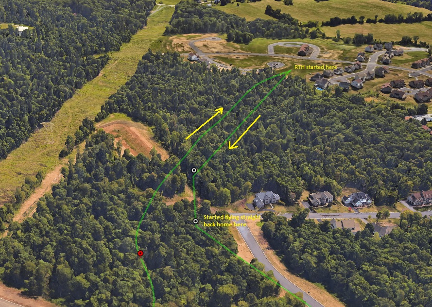

Yes, that seems to be the case. Here's an example of what happened when I caused the remote controller signal to drop by blocking it:
The short straight line near the end of the flight is just due to missing data since the downlink was lost between those two points. The Phantom should have kept flying along the original path. As you can see though, the route back does not follow the path exactly. With obstacle avoidance enabled though, that shouldn't matter since the Phantom would correct itself if there were obstacles in its path.

That's interesting. Without OA enabled it appears you could get into trouble and crash during return, since it doesn't actually follow the exact path. Seems like that could be a liability if you're out having a good time in sport mode and lose connection. Am I wrong?

RTH will not retrace the previous path if OA is disabled.
