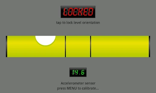

    Use a lever App with you cellphone over the surface you calibrate your bird. If it is not perfectly leveled, phantom will drift when yaw.
    iPhone:
    https://itunes.apple.com/us/app/ihandy-level-free/id299852753?mt=8
    [​IMG]
    Android:
    https://play.google.com/store/apps/details?id=net.androgames.level&hl=us
    [​IMG][​IMG]
