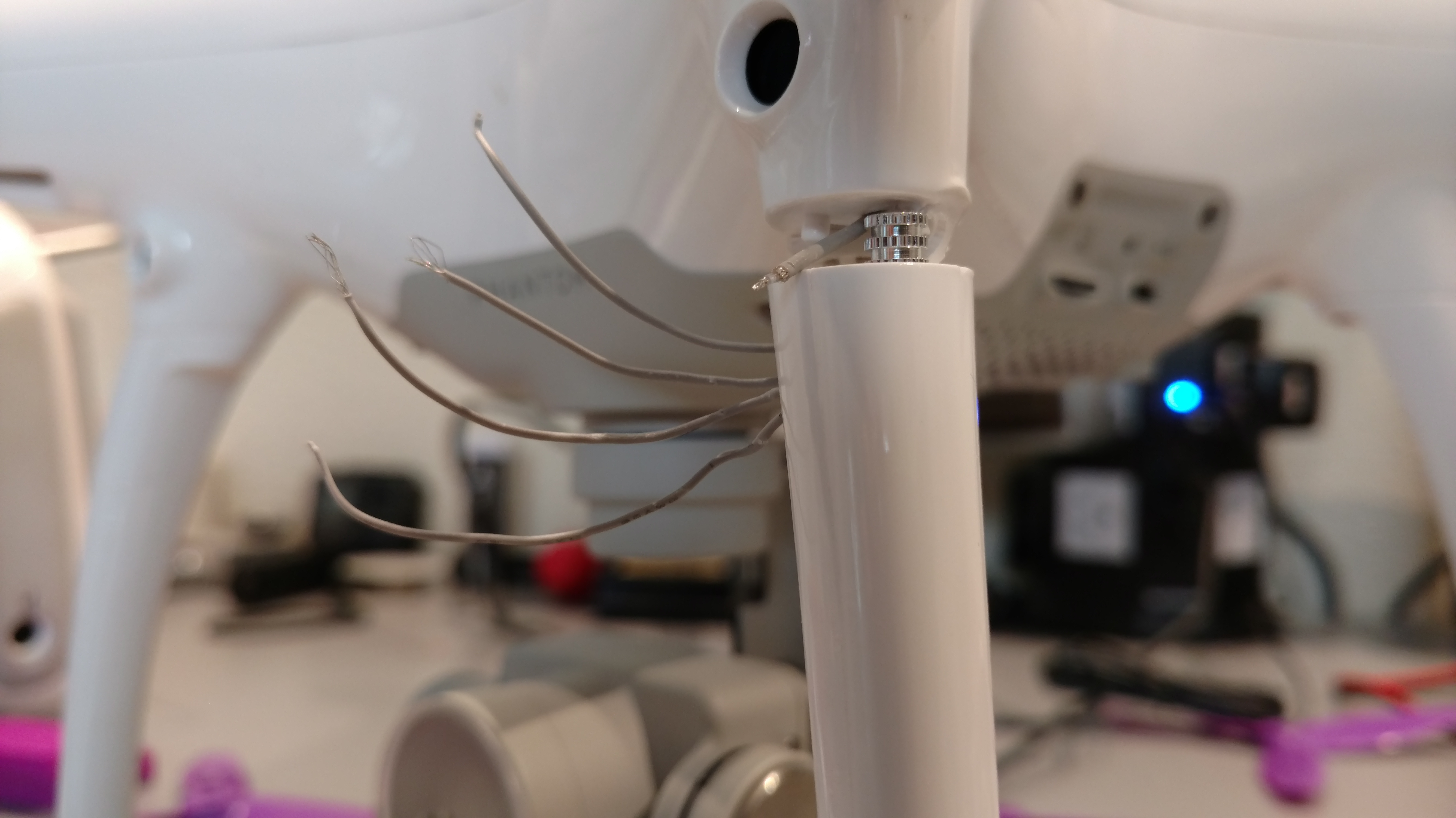

Okay, had a mid air collision and broke the gear but the wires inside were cut too (assume thats antenna)
1) Where can I get the gear and antenna?
I found a couple youtube videos but they showed gear not antenna replacement. Anyone can point me to a good one let me know please.
Thanks, Ed,

You can purchase a new set of P4 landing gear here on Amazon.
This video should help you disassemble everything to disconnect/reconnect the antenna leads:
Reactions: GenCode FPV

Since the compass is inside the gear too, would it need a recalibration?
msinger
Approved Vendor
Oct 30, 2014
31,102
10,338
Harrisburg, PA (US)
You should definitely calibrate the compass after doing that repair.
