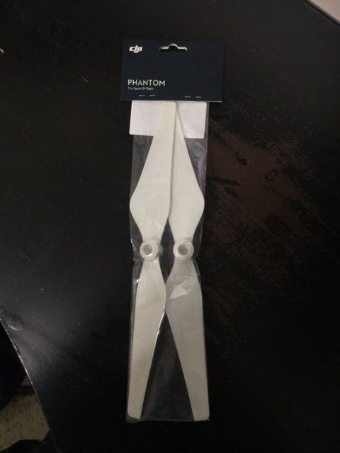

    I just picked up two packs of replacement propellers from Amazon, OEM Dji plastic propellers, same model number, (DJI and 9450 on the propellers themselves) and they look exactly like the ones that came with the Phantom 3 Pro. However, while those spin on with little effort, these ones take a huge amount of force to get on. The grey ones are too tight to move at all, and the blacks are better, but still take much more effort then the stock ones.
    Amazon.com: 2 Pairs DJI Genuine Plastic 9450 Self-tightening Propellers for Phantom 3 OEM in New Clear Pack: Camera & Photo
    Has anyone else encountered this? I assume I just got a bad batch, and am returning, but all 8 of them had this issue.

    Check out the reviews at the above page. A few of the recent buyers are saying the props are knockoff props. Do you have a photo of the package them came in?
    The package should look like the props on the bottom in this photo:
  3. Brandon Katcher
    Dec 15, 2015
    6
    I just saw that top review.
    They are not exactly the same as the bottom package, but pretty close, with the DJI branding. If they are knockoffs, they are pretty well done knockoffs.
    UPDATE: After checking out more reviews (Which I should have done before. I saw DJI under store name and didn't look any further) it seems as though they have updated the packaging for the knockoff so it looks like the real deal. They even have the same model and DJI stenciling on the props.

    RotorLogic sells authenticate DJI parts. I see their props are out of stock on Amazon at the moment, but they are available on eBay.
