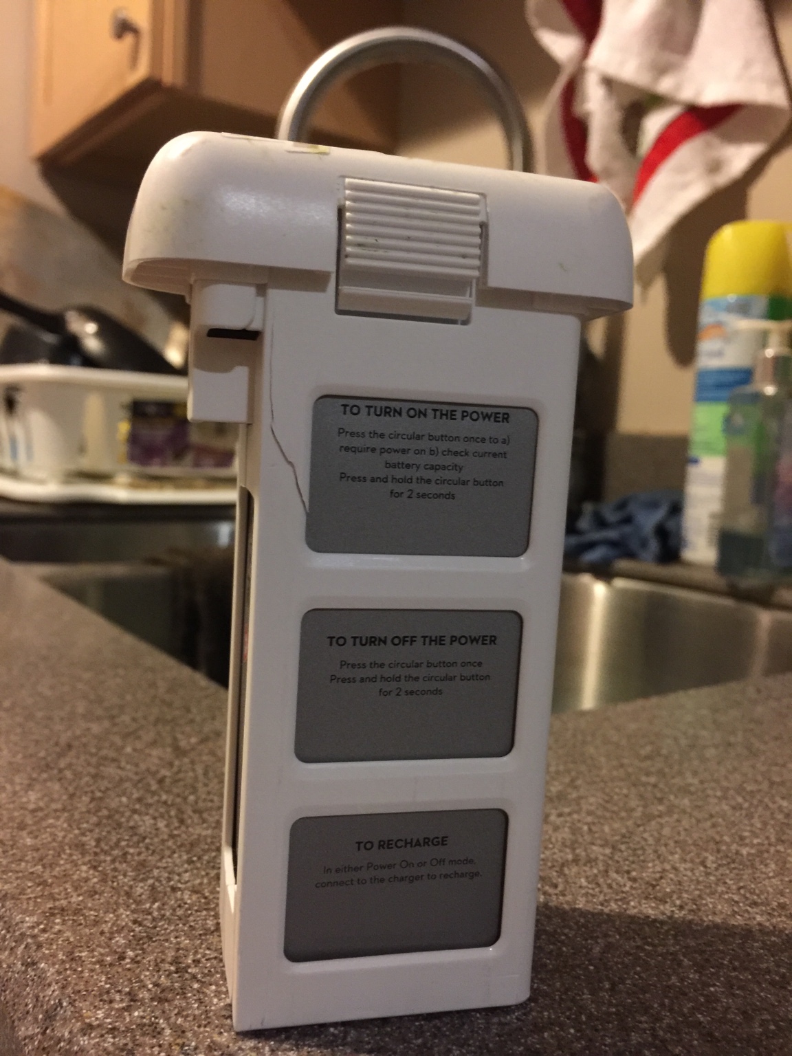

i guess my question is, is there a known safe way to replace the plastic casing for around $40 or less. im sure the battery is fineIt is always risky to work with the damaged/ repaired battery as one doesn't know whats wrong with it. Please repair it and then charge under observation. If its getting too hot, stop it immediately.
If its charged fully and you don't see any abnormality, plug it into the P3 and check each cell using Dji app. All cell voltages should be the same or with small differences.
Question to you: Is it worth taking the risk?
Sorry was unable to get the pic earlier. As far as I can tell this is the only piece broken
thank you for the info,One of my P2 packs had a crack just like that. Repaired with a bit of 5-min epoxy then lightly sanded the repair to prevent binding. Battery is still going strong.
