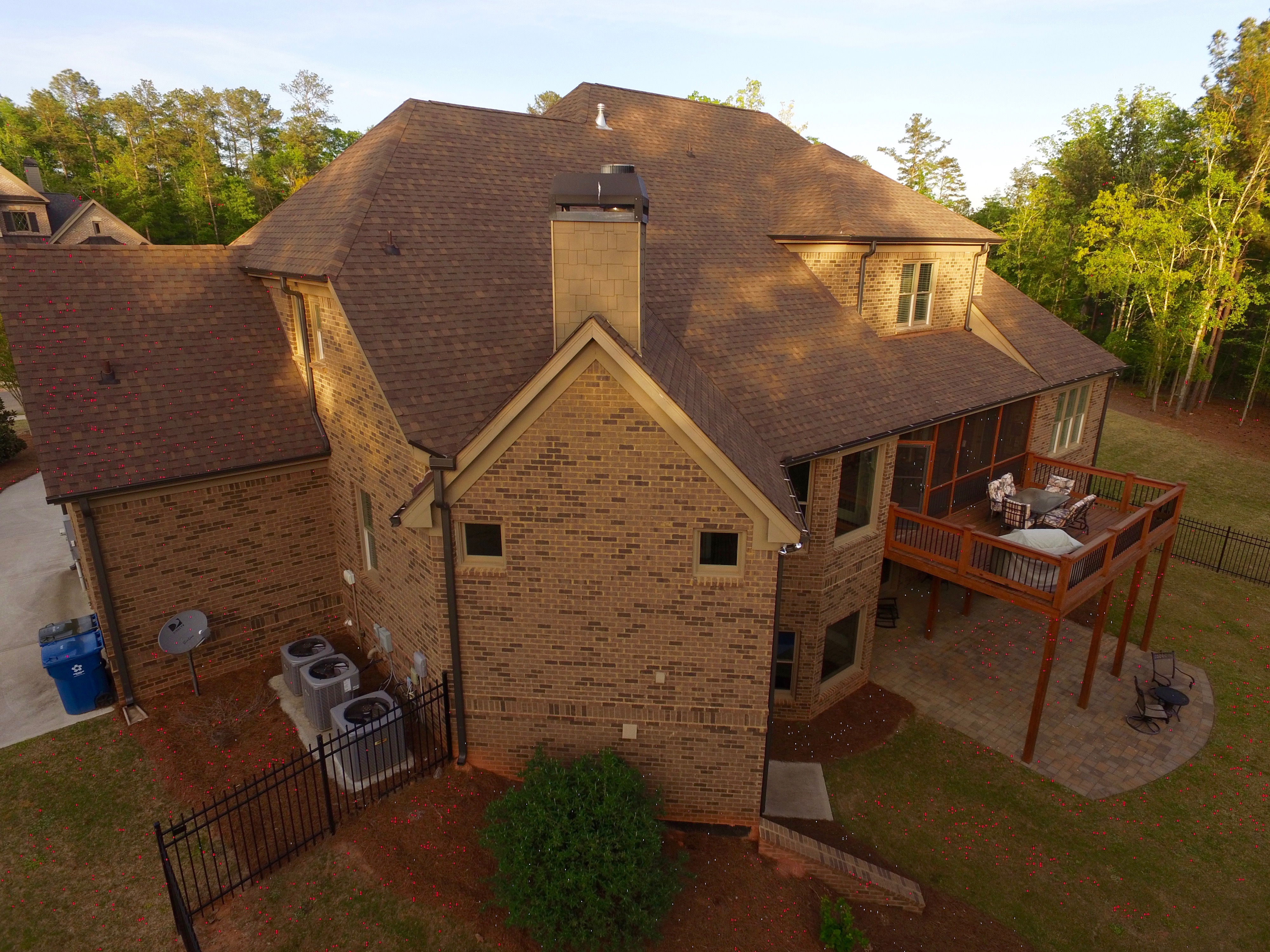

    No hard landing and I checked the cable today. After noticing this I went out in my front yard and did some photos and video and didn't have the problem. Do you think it could have been white balancing or the fact that I was flying near power lines that could have provided interference?

    I have recently updated to the latest firmware, but have not had problems in 5 or 6 shoots before then, in varying loifht conditions. Using the phantom 3 professional, using Apple IOS as the control device. I did change locations that evening after I noticed the problem and did not have it. This was a real estate shoot, and I was near power lines that run in front of the house. When I was a hundred feet above them no problem, but 25 feet above or below them I had this problem. It was in the photos too, but they can be retouched.

    Makes sense. IMO, you're the victim of high voltage radiation. Nothing you can do about it. Not related to any issues with the Phantom or camera. Could be a sign of a transformer leak in the area. If you know the folks that live there - have them notify the power company to have it checked out. Could prevent a transformer going up in smoke and them losing power until it's fixed.
  8. accidentalcio
    Aug 23, 2015
    13
  9. SteveAikens
    May 17, 2015
    230
    69
    Clovis, NM
    Correct me if I'm wrong but that looks like the same house from a different angle.
    You can not expect a different result under that same conditions in the same location.

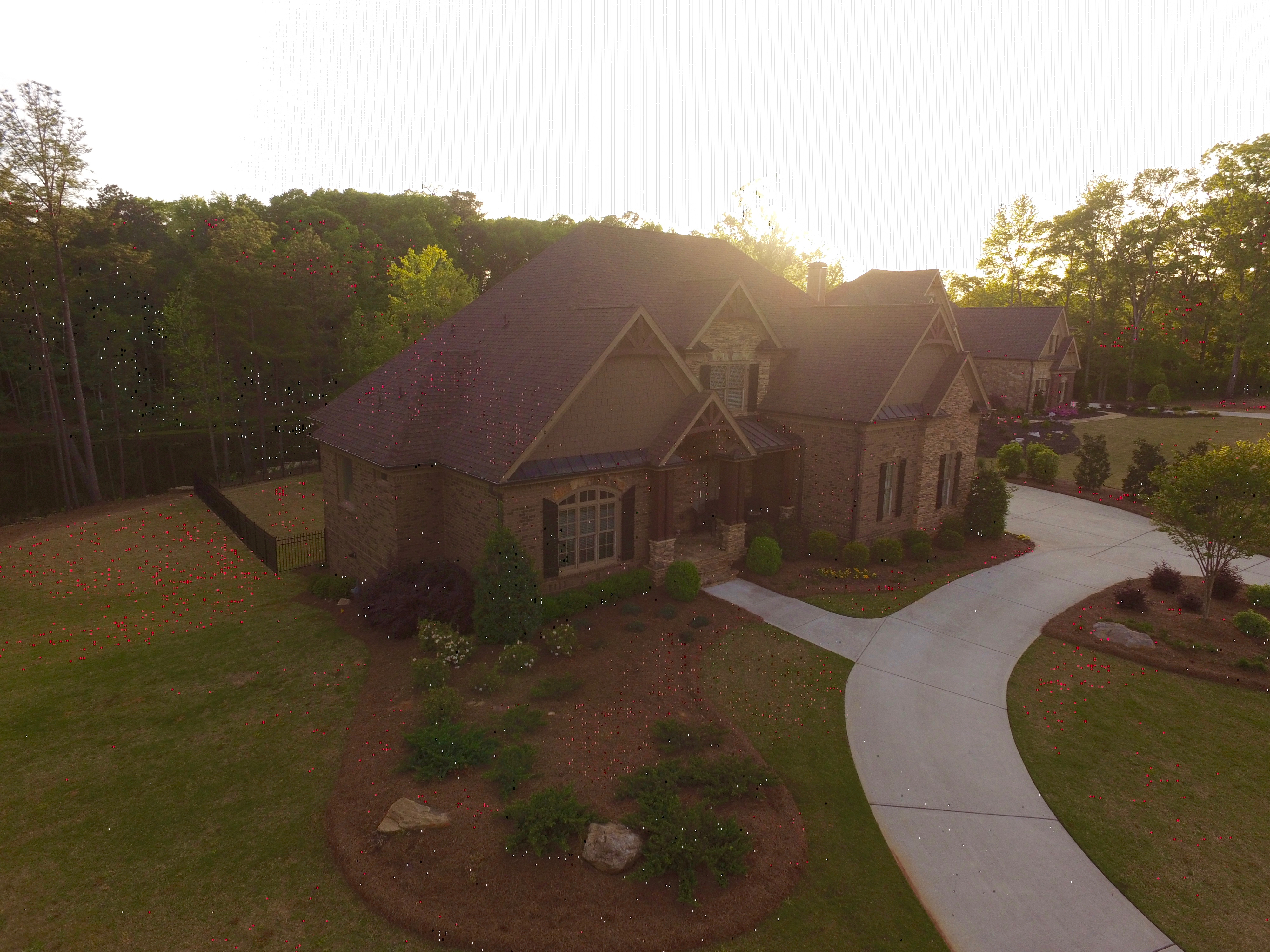

  10. accidentalcio
    Aug 23, 2015
    13
    different house - 15 miles away; no power lines in area either.
  11. accidentalcio
    Aug 23, 2015
    13
  12. SteveAikens
    May 17, 2015
    230
    69
    Clovis, NM
    Ok, no idea at this point. You said you flew somewhere else after the first problem and it went well. Is it possible you have more interference you may be missing. It's odd you have an intermittent issue.
